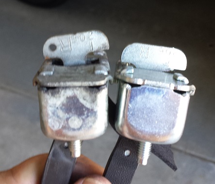

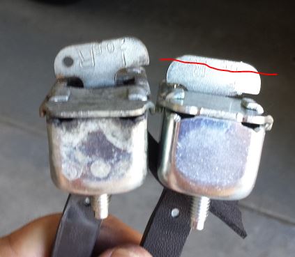

Replaced the door checks on both front doors last night. I recently had mine into the dealer for the "sticky dash" recall and asked them about the snap. They tightened up and lubricated all the window tracks but since the snap didn't go away they didn't charge me. While I was there I got a price from them for the door checks. $106 ea. Found them on-line for $76 ea and installed them myself. After installation I have no more snapping or catching and bonus; the doors hold themselves open now. If you are still having some catching after installing the new checks then the tracks probably needed tightening and lubrication while you are at it. The drivers door check was badly bent and stretched as you can see in the photos. So nice to have this fixed. Don't know what took me so long. Took less than an hour for both doors. I think the wind catching the door once or twice or constantly flinging the door open too hard is too much for these spindly little parts.

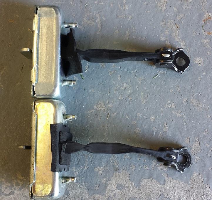

Hopefully some of you are still subscribed to this thread. I replaced the door checks in 2016 as you can see earlier in this thread. They are shot again. I was wondering if anyone has ever ground down the catch to make it less likely to interfere with the window as this weak assembly tends to start stretching immediately. After the last time I replaced the door checks they began catching again shortly after.
