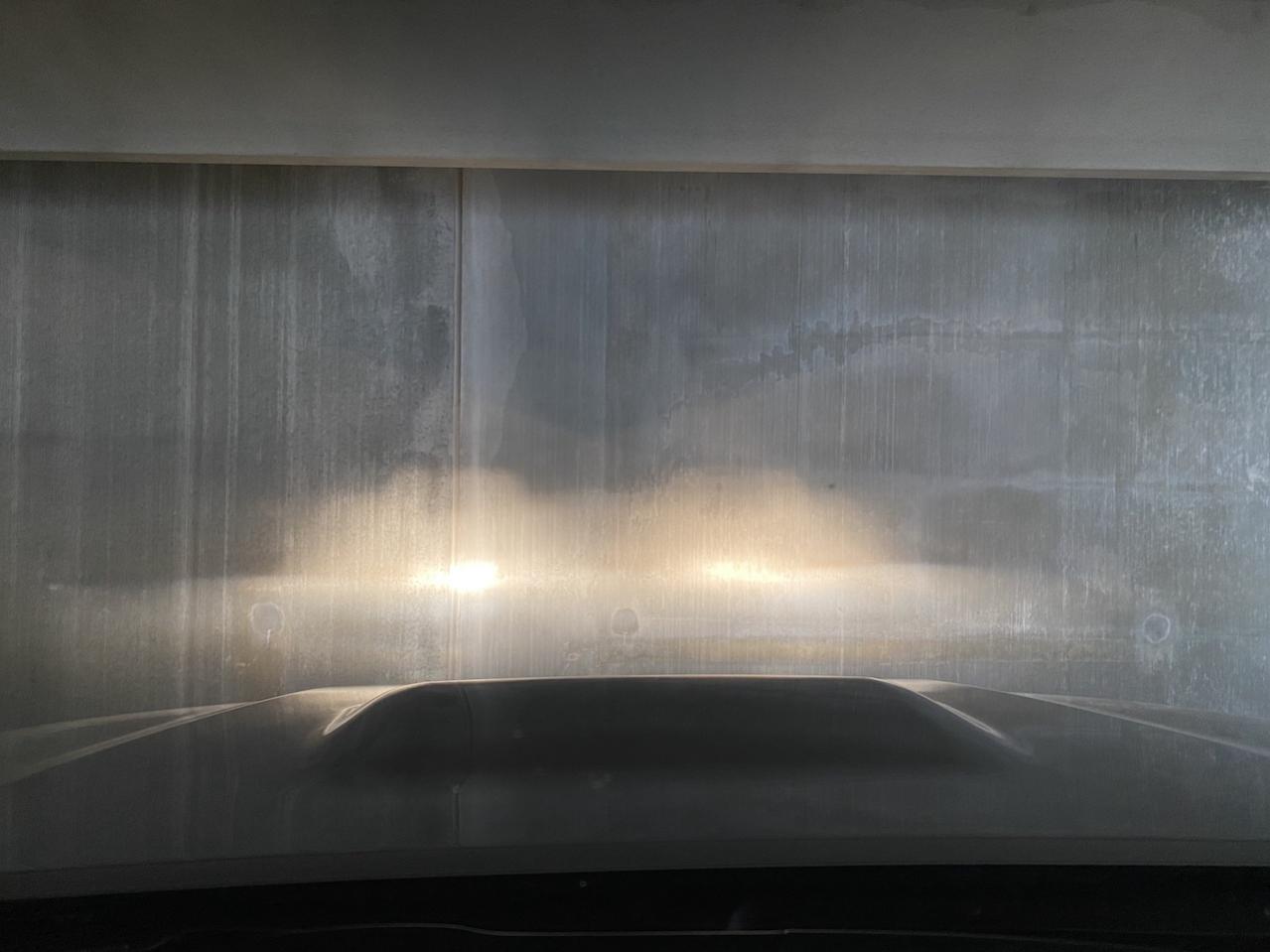

Ive done the H9s and the H11 GE130s and have been impressed with the results. Haven't done the 9011 yet...curious now. Is it plug and play or do I also need to do some trimming?
9005>>9011 is similar to H11>>H9. I did the 9011 yesterday and this is during the day on a concrete wall. Left is 9011 and right is 9005. I used the Amazon Wagner-boxed Made in Germany bulbs that were $12ea on Amazon.
