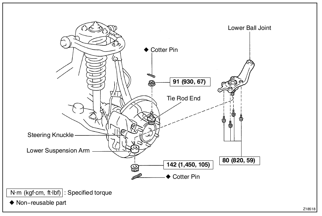

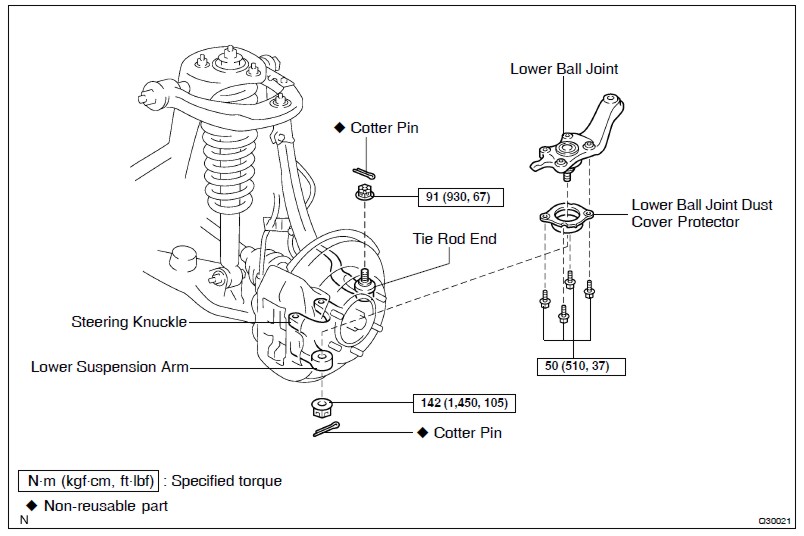

The '02 manual, at least, shows 37 ft-lb.
I found that discrepancy when I was doing my lower ball joint replacement a few months ago. I have attached the same section out of the 2000 manual. The part numbers for the lower ball joints don't change across the model years for the 3rd gen. When I did mine I went to 59lb-ft, and I didn't feel like I was anywhere near needing to worry about stripping or breaking anything.
The diagram for the 02 shows a dust cover which is what my 02 has as well.
Always wondered why such a difference in torque values with/without dust cover.
Anybody have thoughts on that.

So reading into other users comments in this thread I realize now that in the FSM it says to torque to 37ft-lb's WITH dust covers on.
I bought dust covers and was torqueing to 59ft-lb's. I think I see my problem.

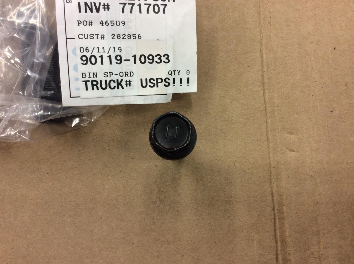

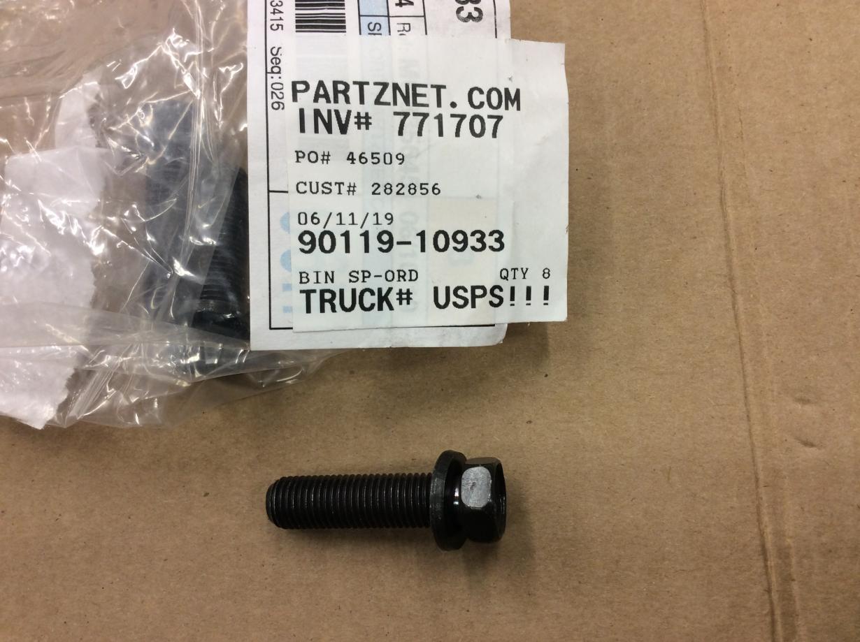

These are the LBJ bolts w/washer for 01 & 02. Not sure what if any difference there is between these and the bolts for the earlier year 3rd gens.
I suspect the difference in the torque values is related to the use of the dust shield more than a difference in the bolt but that’s just a thought.
