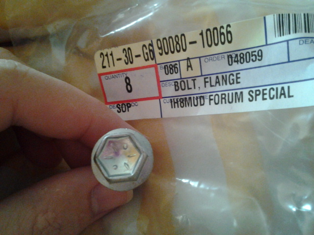

I ordered new bolts for my LBJs but the bolts are marked with 4 lines and 2 dots. Does that mean they are grade 8? The dots are making me question them. If not I'm definitely going to try and locate new bolts.
This might be something to consider since some ppl have sheared the 8 14mm bolts.
can you post a pic?
if they ARE grade 8, theyre the wrong bolts. you need metric bolts.
but a grade 8 bolt will have 6 marks on it. the metric will be stamped with a number.
ah. well there is no accounting for OEM hardware. their identifiers are different.
but, coming from the dealer, they should be correct.
There must be some reason for the markers it has, right? I'm goinig to see what I can find out but if someone already knows please post up.
I'm just looking at the fact I've seen a few people with the bottom 4 bolts failing and trying to make sure the OEM bolts are atleast grade 8. If they are not, then replacing them with grade 8 might be a great thing to upgrade when installing new LBJs.
i understand what you're saying, by wanting strong bolts.
but, you cant ask for grade 8 bolts, thats SAE, you need metric bolts. they are graded differently. 8.8, 10.9 etc etc.
and, i have no idea what spec the OE bolts are. but i would guess they are strong enough for that application. if theyre breaking, its likely because they were installed incorrectly. either too loose, so they moved, or they were overtightened.
Gotcha and understand you're confusion with my post now. Guess I'm looking for a 10.9 which is comparable to a grade 8.
