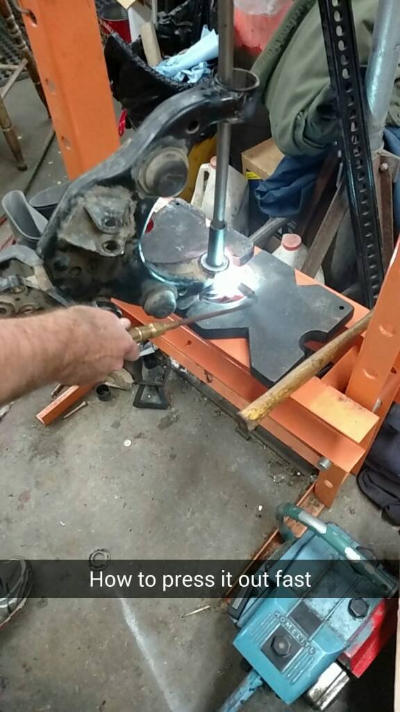

Did you have to use a torch because the bushings were not coming out?
Yea. We were only able to press one out with this press. After that we had to burn the bushings and hit the metal sleeve out with a chisel.. I almost gave up :israel: But I was going to get her done:50cal:
