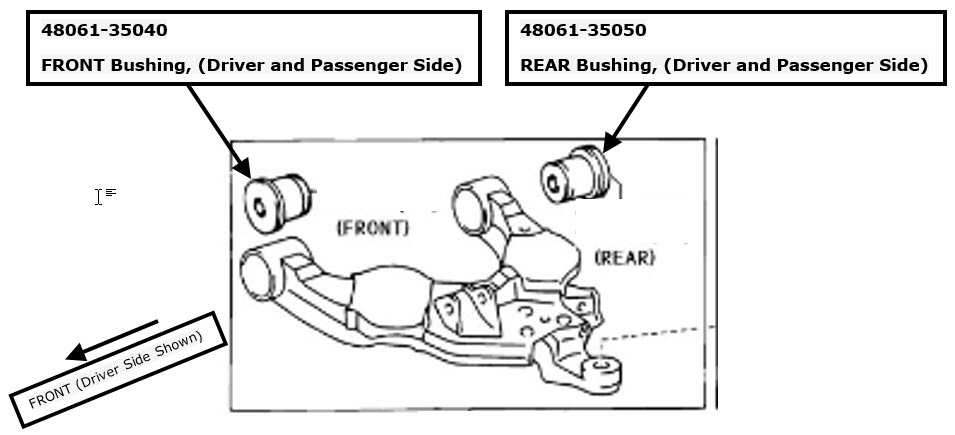

Some discrepancies from Toyota as to which part number goes where. The majority of parts diaphragms show this configuration. With parts in hand I'm about to proceed. Just want to confirm others have seen the same errors and came to the same conclusion.
thanks, S.

Those part numbers are correct, I installed the same numbered bushing front and rear noticing there was a difference , had to press back out order and install the new correct bushings.
I did talk to Camelback and they did confirm there was a difference in the 2

Thanks [MENTION=206706]Poorboy64[/MENTION], that's exactly the input I was looking for. Some Toyota parts diagrams, and parts humans that read them, are incorrectly specifying one part number for LH (Drivers) and the other part number for RH (Passenger). Others show it correctly as you have confirmed, and yes when holding them in your had you can see the difference. Thanks All, S.
