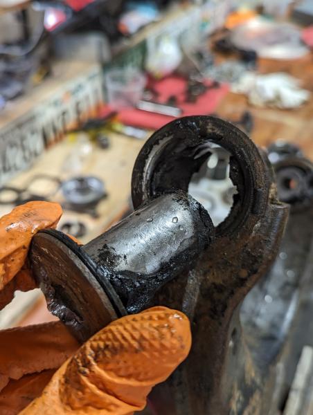

Whiteline bushings - they came with the truck. PO was going to install but decided to sell instead. Seems like a lot of folks like whiteline because they are soft and give on lifted trucks. My daughter and I just bought this truck last week, sorting through everything. I had to cut out the existing LCAs at the cambolt sleeves - they were rusted in place. I'd post some pics ... but... I haven't figured out how yet lol.
old bushings... were no more!

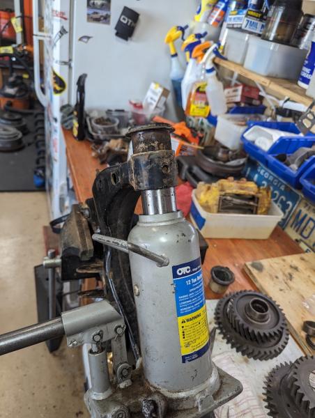

bottle jack and a vice, along with heat and BFG - easier than using the shop press.

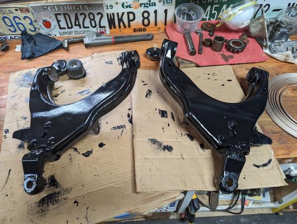

shiny painted arms!
Thanks for the 1a auto suggestions, I ordered the 10 piece kit. Uppers, lowers and tie rods. I don't plan to use those uppers since I'm going to have about 2.5" with the Tacoma struts in front. It's hard to beat the price on the kit though for sure.
