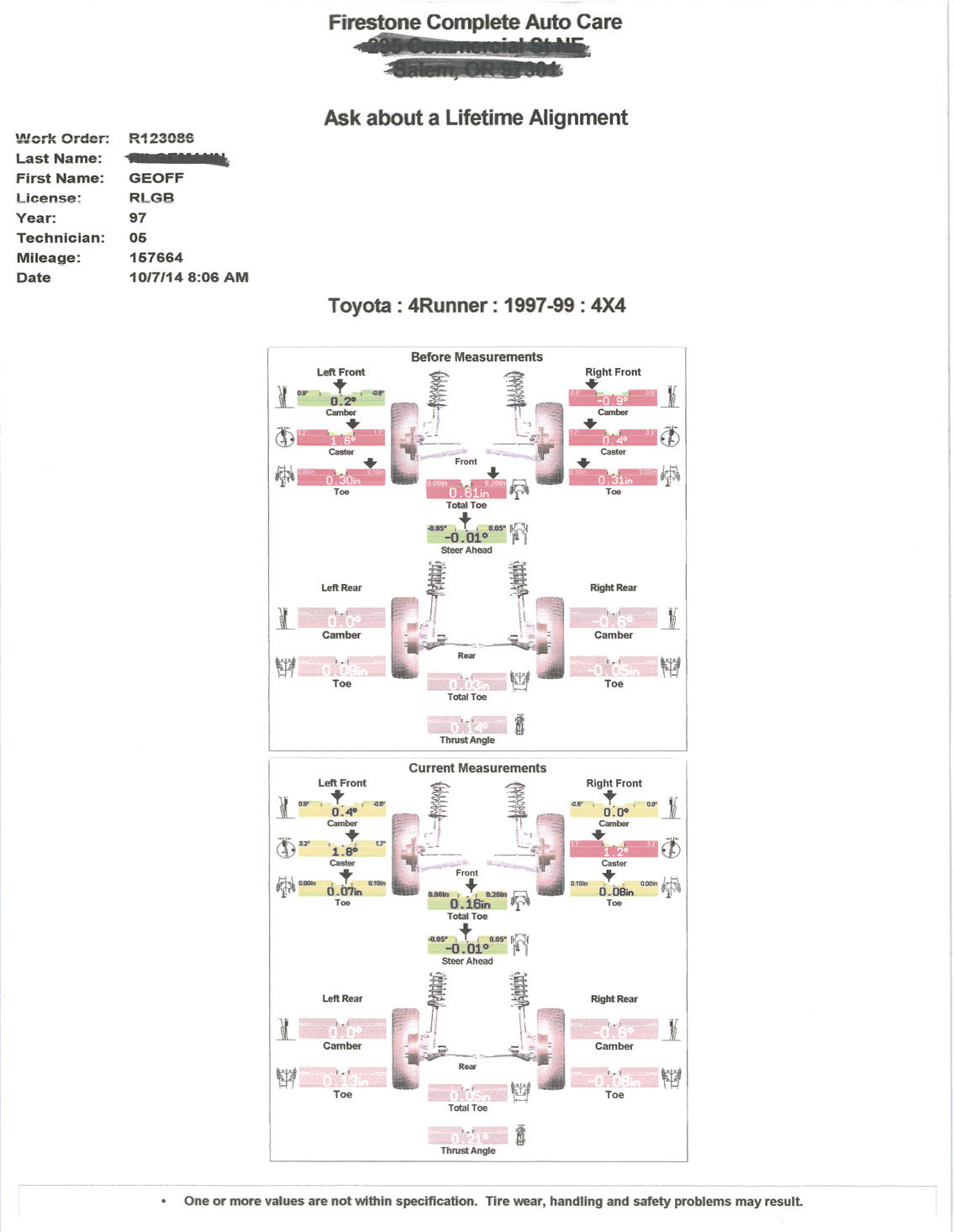

I was just looking at my alignment....these guys didn't try very hard.
