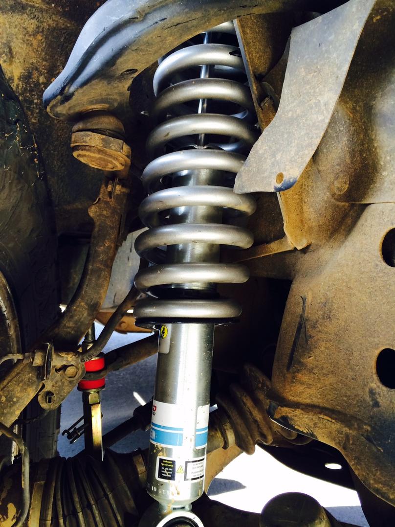

how many perches were on the shock 3 or 5. If 5 then they go on the 2nd perch if there are 3 then they go on the lowest perch. When I bought mine I didn't know there were two different shocks with multiple perches and I got the 3 perch shocks and on the 2nd perch they rode like sh#@. Rode much better once I lowered it back down to where it was supposed to be.
They are the 3 perch version - and I have them on the second....so yeah it is a little rough. I'm trying to talk Toytec into just selling the adjustable collar so I can turn it into a true coilover anyway. I like the fact the truck with 295/70's and some extra weight doesn't lean in the corner.
Thanks for the feedback though! I may just drop them to the 1st perch this weekend to see how she rides at the proper setting.

If it's 3 perch then I highly recommend running it on bottom perch brotha. Can you take a pic of how the eibachs are installed.

Perch number two in this pic. I figured it was like ordering a coffee - Large is too big, small is too small....the middle is just right. I was wrong.

You are running the Tacoma Bilsteins.
Tacoma on 1st perch = Tundra bilsteins on 2nd perch
(You're current setup) Tacoma on 2nd perch = Tundra on ~3.25? perch
That explains the stiff ride you are experiencing.
Not to kick a dead horse here but I just lowered my Bils down to the first perch and I must say that the ride is much much better. Another tip for those wanting to do this swap:
User only Toyota top-plates. When I disassembled the strut the shaft of the shock has rubbed against the top plate enough to wear a sizable groove in the plate. Apparently the isolaters did not do their job. Problem solved for me and I have a nice riding truck.
