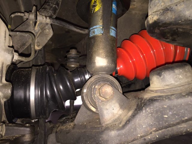

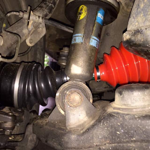

Post a pic of your cv angle
I forgot about this thread! Sorry. Here's a pic of the new cv's ImageUploadedByTapatalk1438287466.162285.jpgImageUploadedByTapatalk1438287504.704335.jpg
