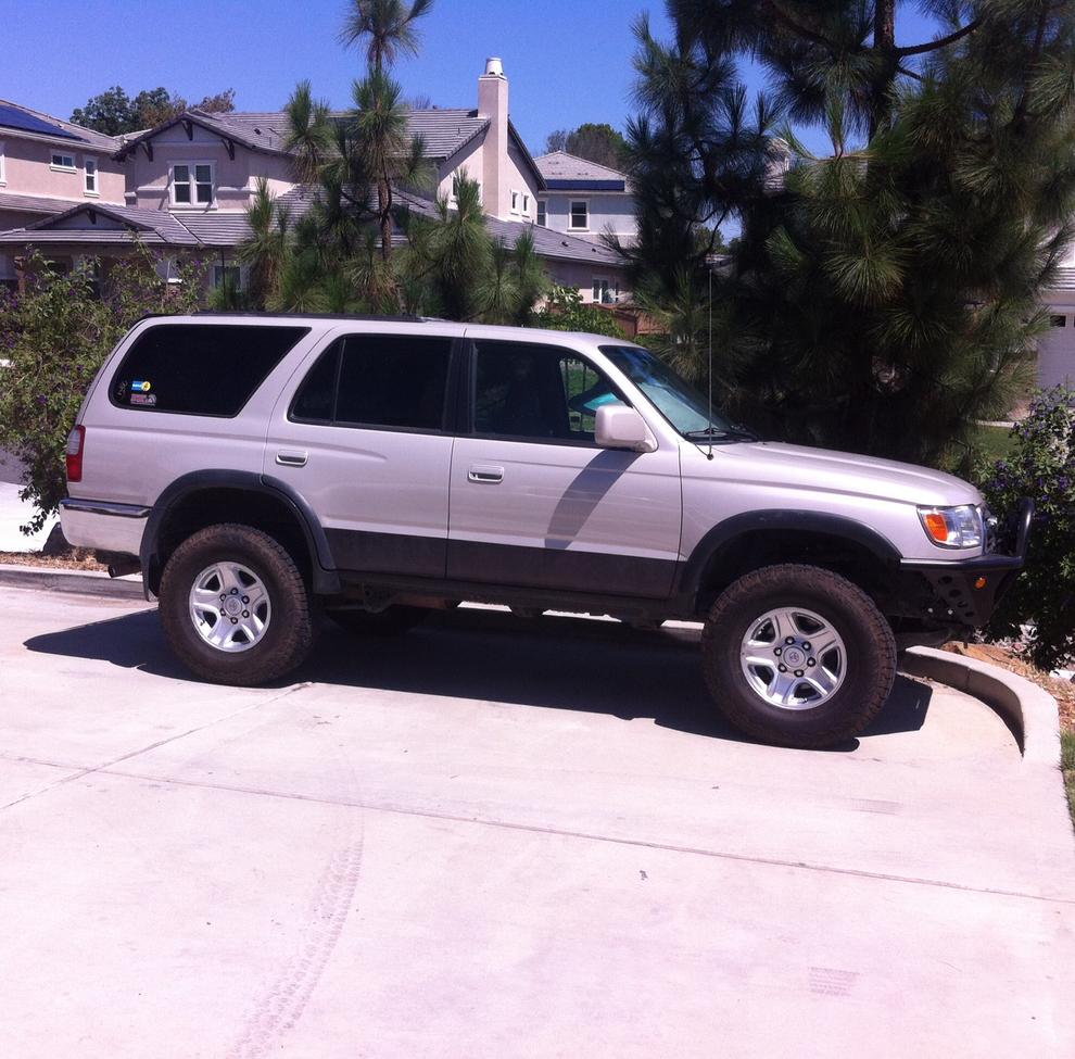

This is how it sits now (2.5" front, 4" rear). This is the perfect lift height and amount of rake IMO. I'll be tubbing the fenders and stuffing 35's in there one of these days.

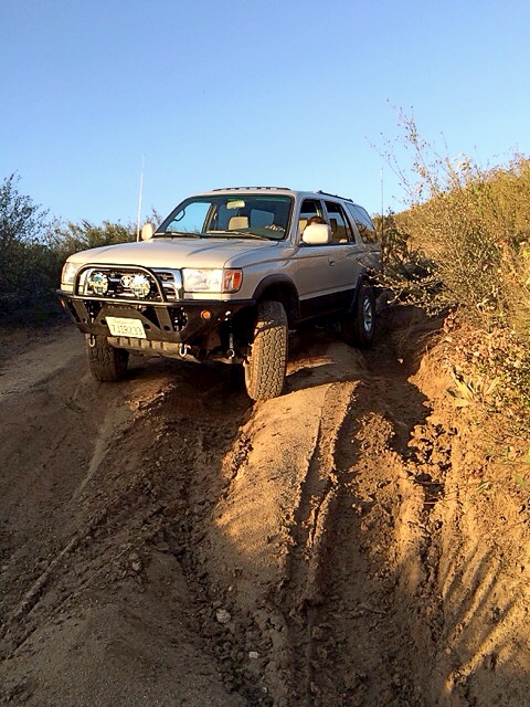

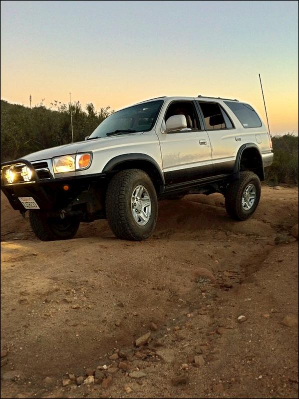

(note: not the best wheelin' pics but you get the idea. plenty of flex for sure)
