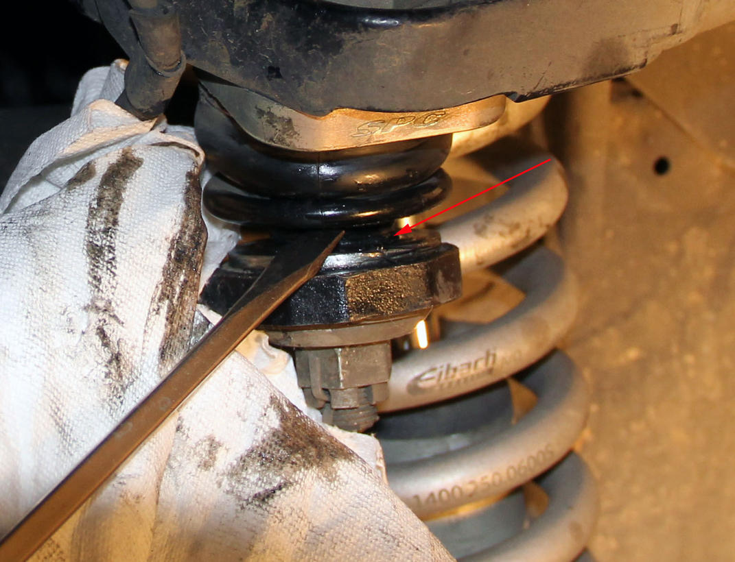

Not happy. LR SPC's installed at 309K Now 331K and Upper Ball Joints leaking. Been off road twice since installed. Ridiculous. I swear, nothing beats OEM parts. Not even close...this is coming from a guy who has owned his rig straight from the factory and only had to replace your typical maintenance items such as plugs, wires, coils, pcv, sensors etc in the last fifteen years. The "out of the ordinary" maintenance was one axle bearing. I didn't even change the ball joints and radiator until last year.

Do you have any pics of the UCA's?
That really blows these things are not cheap and sure as hell are supposed to last way longer then 22k miles I would contact SPC because thats unacceptable!

That sucks, I believe in OEM parts too but there are aftermarket parts (not many) that are better than Toyota. Like Tom Woods drive shafts & Marlin Crawler clutches. But when I was researching UCA's I read too many negative reviews on LR. Mostly breaking on the trail. I bought the All Pro UCA's. They were the second cheapest after LR of the "high end" UCA's. I only have a couple hundred miles on them so we'll see how they do over time.
Don't listen to that moron. There are a LOT of people running LR arms and wo issue. Call them up and make them figure it out.
Definitely email or call Specialty Products. The bjs on my Tacoma LR UCAs crapped out quick too. I emailed them, sent some pics and other info they requested. They took care of everything . Excellent customer service!

Photo of one side

Last night when I pulled in the garage to inspect my CV boots and get ready to do some under carriage inspections over the weekend I noticed grease on the passenger upper ball joint. Took a rag to it to see if it was torn and it wasn't. I went to the drivers side and sure enough it too had grease seepage from the bottom on top of the spindle. Not a lot, but enough to be concerned.
This morning I did some research on our forum and found some interesting write ups on the LR upper control arms in the 4th and 5th gen sections. Apparently as [MENTION=7105]Scramble[/MENTION] said, there's been some quality issues in the past with LR, however, their customer service is outstanding. I'll get in touch with them today. I'm hoping I was one of the unlucky ones that accidentally received two ball joints bad from stock. That happens.
The fact that I've only had them on since the fall of 2014 is quite frustrating.

EDIT: A better photo. The first photo wasn't close enough. Not a lot of grease but enough to be concerned.
