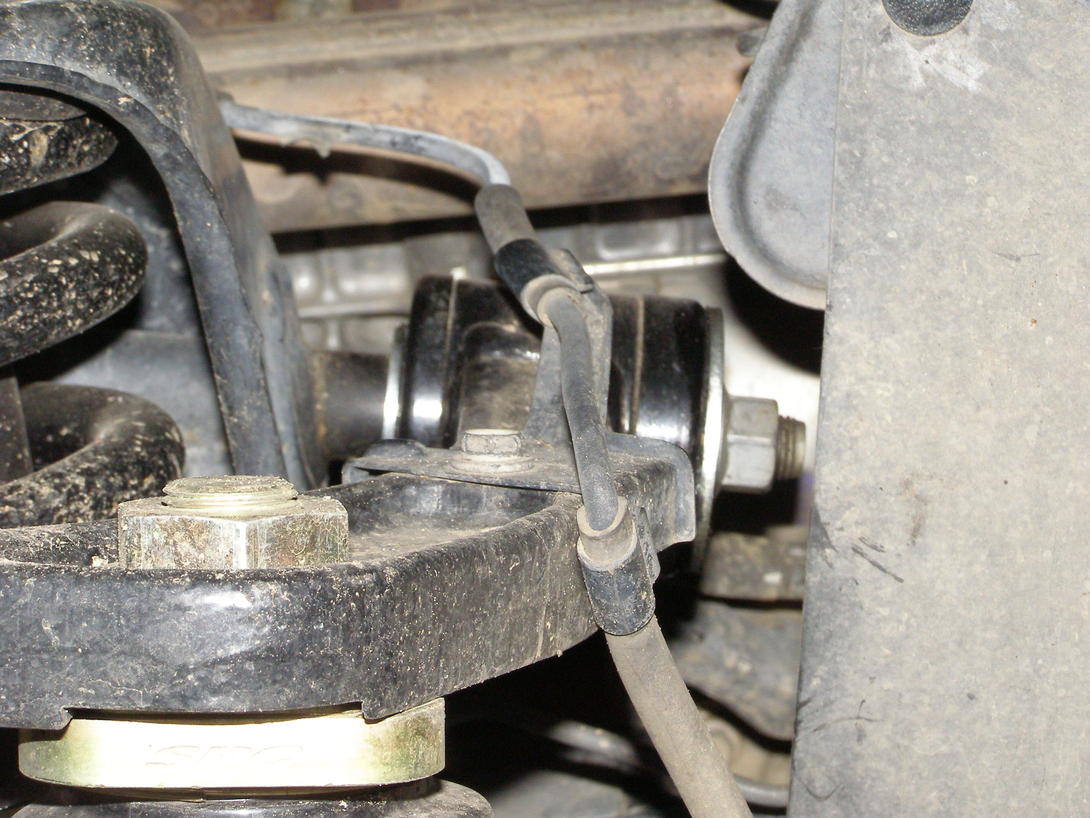

OK, so judging by your build pictures here's the issue:
After SPC/Light Racing developed the new bushing setup, they started w/ 4 washers per side (one on either side of the bushing). After some testing, they found that this overcompressed the bushing causing noise and premature bushing wear/failure. In some cases the binding also backed the nut off of the UCA bolt.
So they came out with a new setup utilizing a longer inner bushing sleeve which eliminated the need for inner most washers (between the shock tower and inner side of the UCA bushing). This solved the issue.
Only reason I know this is because I contacted SPC to see if I installed something wrong based off of HOJeepsters install (he has the new 2 washer per side setup). They sent me out the new sleeve and more grease the next day and I'll be swapping them in this weekend.
After sending them an email, Steve at SPC called me within 30 mins to send me the new parts. Great customer service and I imagine this should solve my current squeaky front end!

Here is the picture from my build:
IMAG0598_zpsb8395e15.jpg~original
So your issue is the same/similar to the ones I'm describing? I should contact SPC and they will send me the correct parts?
Yes. If you have washers on the inside of the UCA bushings...they shouldn't be there. Give SPC a call or an email and they should take care of you.
They told me the new sleeves and deletion of the inner washer will make a night and day difference.
I also this might be a big unknown issue. Seems everyone knows about the new specride bushings vs. the old but not many know about the 2 washers/longer sleeve vs the original specride/4 washer setup.
I e-mailed SPC Performance yesterday, sent them the picture, and they're sending me new pivot sleeves and grease today. Hopefully they get here this week, I'm sure they will. That is seriously great customer service.

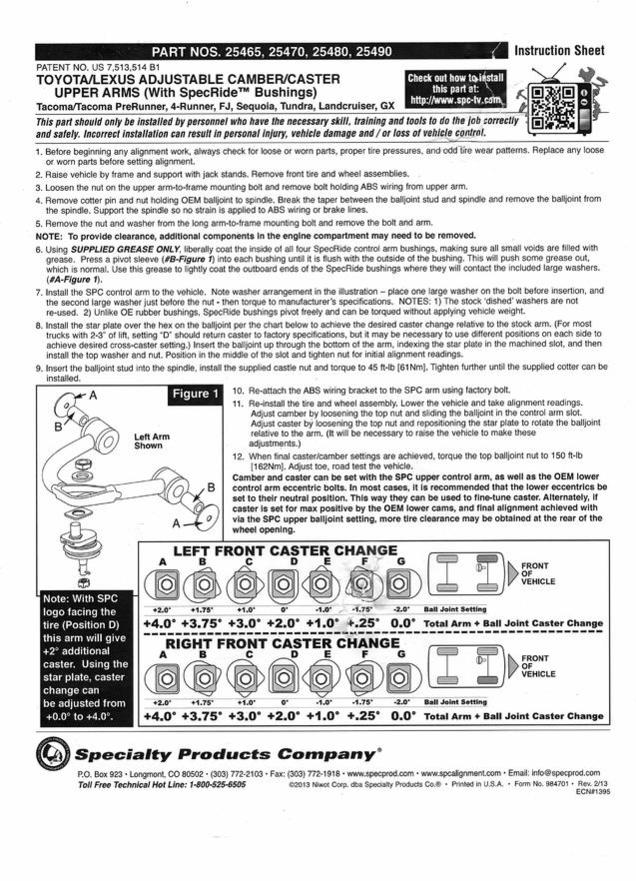

This instruction below is the latest LR UCA version I am aware of, and it shows only 2 per side. I scanned this from my set I received a couple of weeks ago. According to Metal Tech, this was suppose to be the newest one.
You read right, that is the same info, directions, I received.
When I installed, mine you, exactly like it shows on there, I had movement from side to side on the long bolt. A gap of 1/16" each side of the shock tower. That's when I made a call to SPC. They had to get back to me after they open a box to tell me that a washer the same size thickness as sent, but, smaller in diameter to put into the shock tower side.
This washers are the ones they where going to send me. They also told me they where going to make a change on the instructions to show that missing washer and add it to the instructions. This was about 2-3 months ago.
