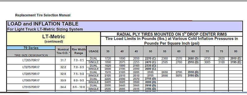

Now I had a few minutes this morning and found an LT load/inflation chart from Bridgestone (see end of page B24) and found that even the small difference between 265 and 275 both 70R17 give different load ratings at the same inflation, so what the computer may spit out for a 265 wouldn't be accurate for the 275 size. This also could have been part of my problem. Now apparently Bridgestone doesn't make 275/70R17's in anything greater than C load rating, but even that is more than enough for our trucks.
For simplicity's sake I moved the 265/70R17 line from the bottom of B24 to the top of B25 to make this easier to follow.
