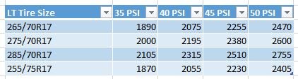

P-metric to LT conversion
Most of this information is pulled from ToyoTires Load Inflation Table PDF file located here:
(http://www.toyotires.ca/sites/default/files/loadinflationtable.pdf)
P-Metric or hard metric tires on Light Trucks
When a P-metric or metric tire is installed on a light truck (SUV, pickup, minivan), the load capacity of the tire is reduced by a factor of 1.10 as prescribed by the Federal Motor Vehicle Safety Standards (FMVSS). For example, 305/50R20 has a maximum load capacity of 3086 lbs. If this tire is fitted to a light truck, then the actual allowable load capacity for the tire is 2805 lbs. (3086 lbs. divided by 1.1). If you replace the original tires with the exact same type (P-metric, hard metric, LT-metric, or flotation), size designations, and ply as the tires that were originally installed, just follow the vehicle’s tire information placard for proper inflation pressures. If, however, you apply a ‘Plus zero’ or plus-1, etc., fitment to a light truck, you must discount the replacement tire’s load by the 1.10 factor and ensure that the replacement tire has sufficient load capacity by inflation to support the load of the originally installed tires.
Toyota spec'd two tire sizes for the 4Runner:
SR5/Trail P265/70R17 = 2535 lb standard load capacity. So 2535 / 1.10 = 2305 lb load rating on a light truck.
Limited P245/60R20 = 2149 lb standard load capacity. So 2149 / 1.10 = 1954 lb load rating on a light truck.
Now armed with these load ratings go find your tire size in the tire manufacturer's catalog and compare tire pressures to load ratings.
LT-Tire-Size----35-PSI--40-PSI--45-PSI--50-PSI
265/70R17-------1890----2075----2255----2470
275/70R17-------2000----2195----2380----2600
285/70R17-------2105----2315----2510----2755
255/75R17-------1870----2055----2230----2405
I posted the table as a JPG as well in case it didn't turn out nice with HTML spacing.

Okay, now I have a few questions.
1. Are Toyota's number per axle? or per tire? Because it looks like per axle.
2. Are Toyo's number per axle? or per tire?
As I showed above, my calculated numbers for my 4Runner are 1,463 - 1,775 per tire. Actual, are closer to 1,300 lbs./tire. And if Toyo's number are per axle then nothing works. But if Toyo's numbers are per tire then 35 psi is acceptable.
As I showed above, my number for my 4Runner are 1,463 - 1,775 per tire. And if Toyo's number are per axle then nothing works. But if Toyo's numbers are per tire then 35 psi is acceptable.
Those numbers in my chart are per tire. All the weights are per tire... No axle ratings are used when doing this calculation method. Although it would be smart to verify your 2 tire's load capability at the PSI you select are greater than the axle rating shown inside your door jamb!
