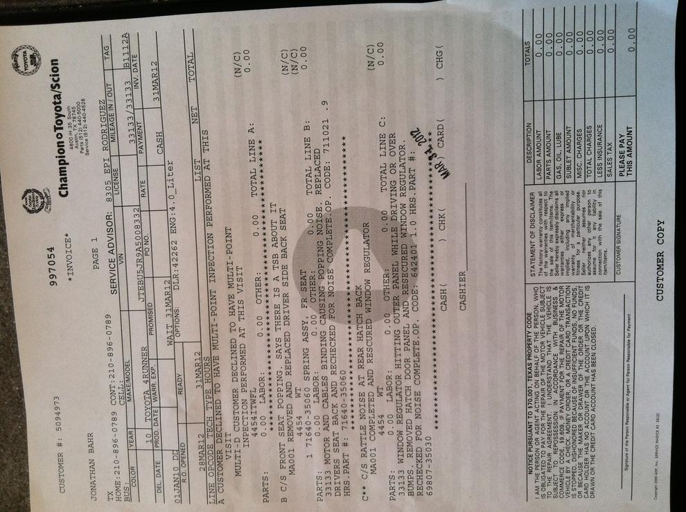

Over the weekend I took my '10 TE into the dealership to get the lumbar issue fixed. It took them the better part of the day. When I picked it up they had forgotten to connect all of the wires for the power seat but popping was gone at least for the moment. Double checked to make sure the parts were the correct ones and off I went. See below for part numbers corresponding to the TSB previously posted in this thread. Sorry I can't get the image to be vertical...

had mine replaced today. parts guy confirmed 71640-35060 is an entirely new seatback frame; lumbar guts and all.
