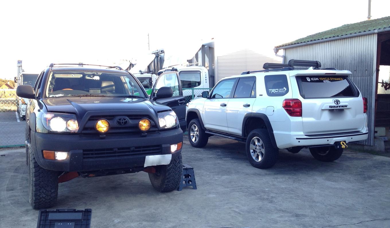

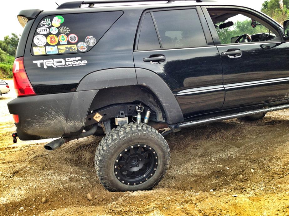

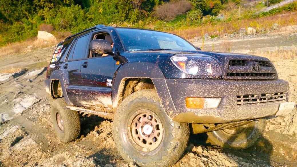

This 4th gen is my previous car.
Toytech & BILSTEIN5160 3.5"lift / TC upper arms / TRD wheels 16x7.5j / Hankook MT 295/75R16

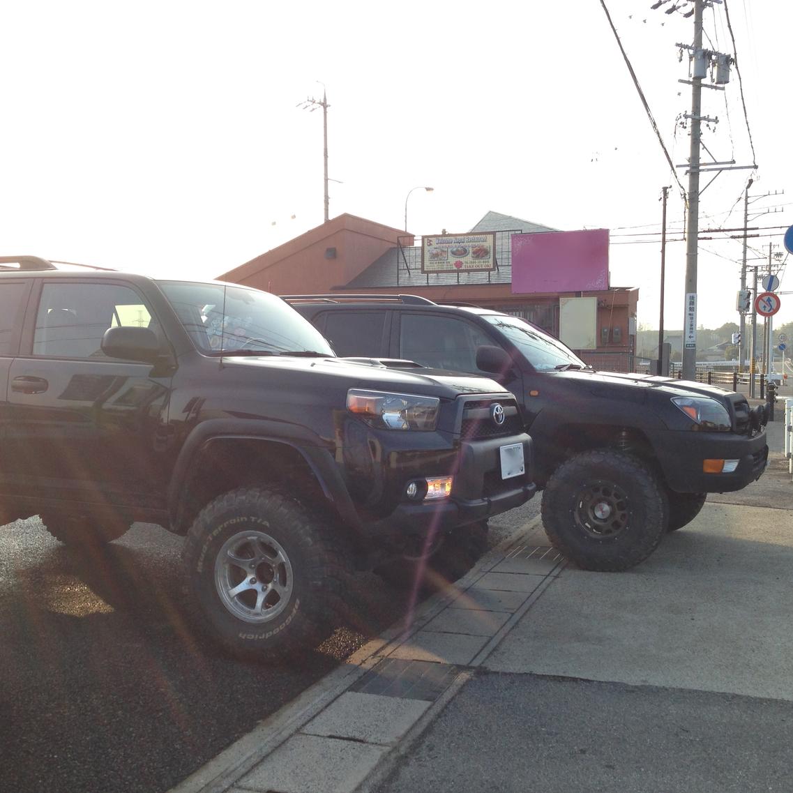

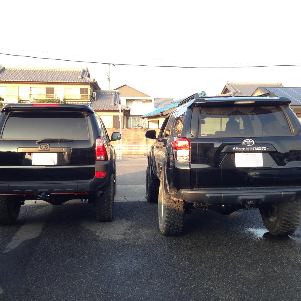

I transfer to the 5 gen from the 4 gen.
ProComp 6" lift.

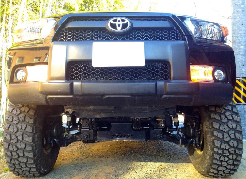

I'm thinking a lot of that lift is body/spacer lift? Wondering how the CVs could look that good with 6" any other way.
That 5th gen is running the ProComp 6" FJ kit. Drop brackets and new knuckles keep the CVs and tie rod angles almost factory like.
OP- nice 4runners! Thanks for sharing.
Yes.I using the FJ kit.
Load is small, 'cause the angle is normal.
