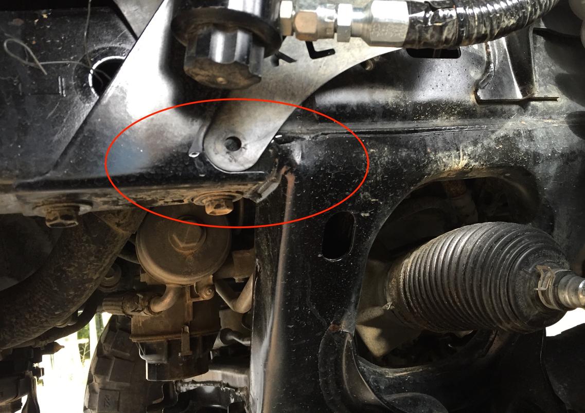

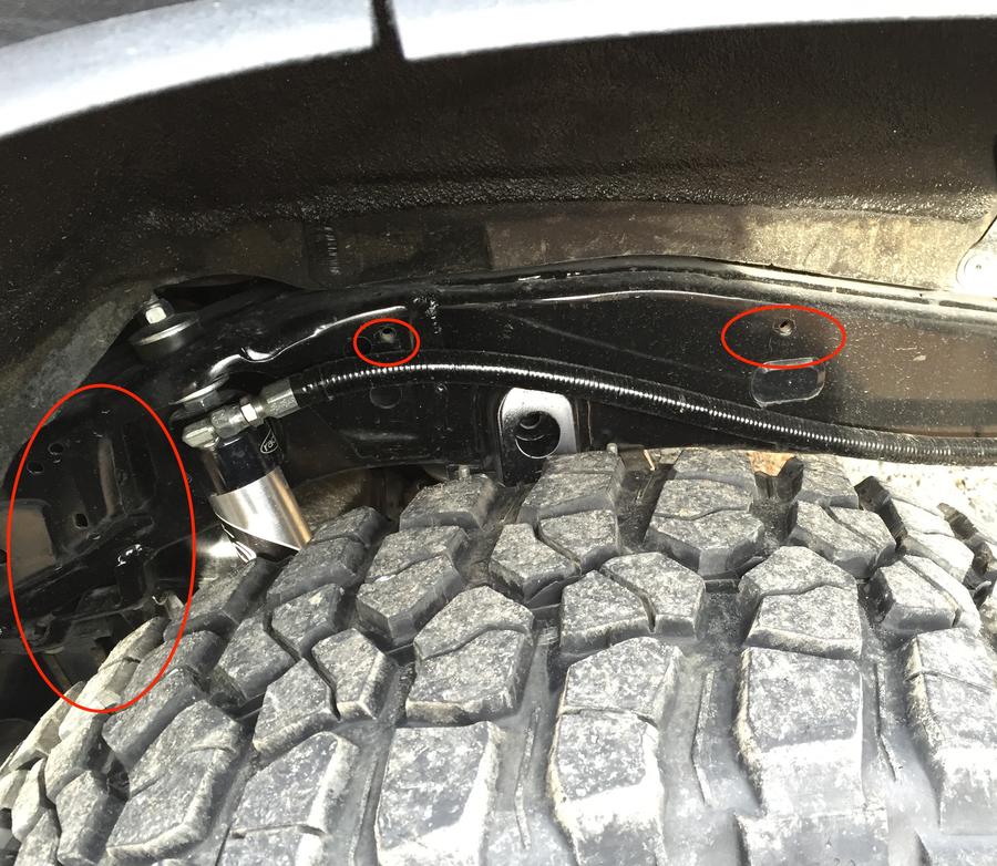

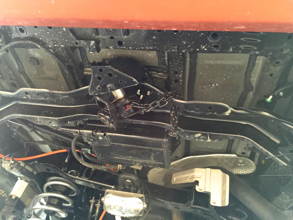

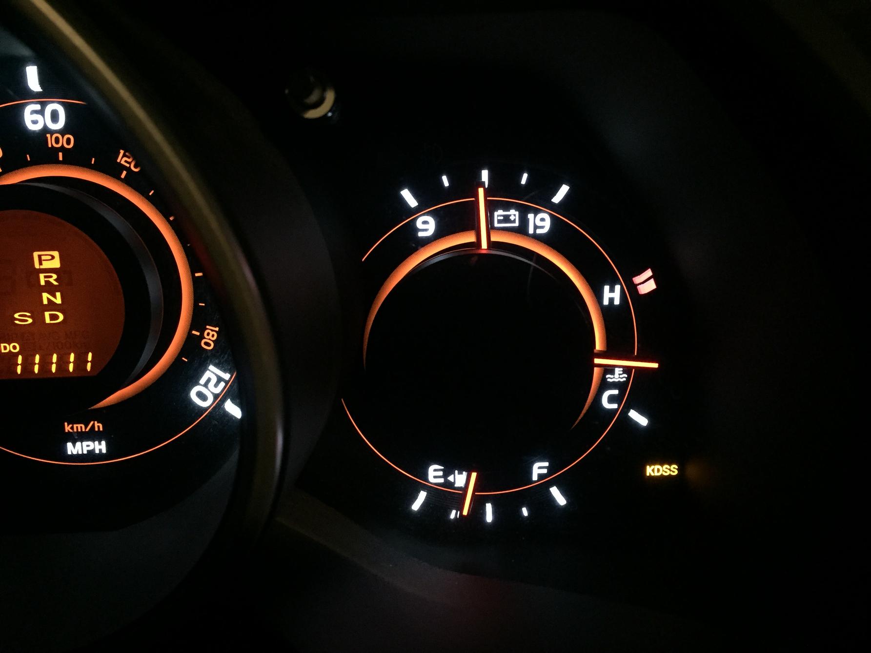

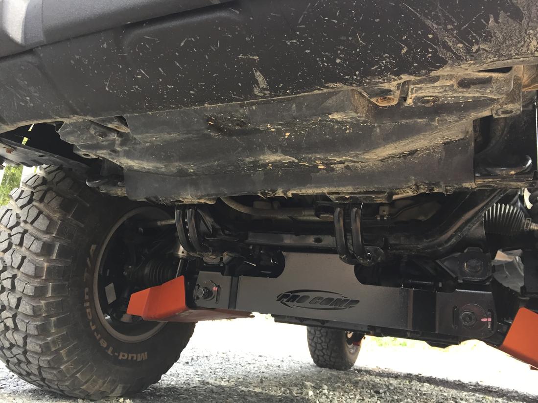

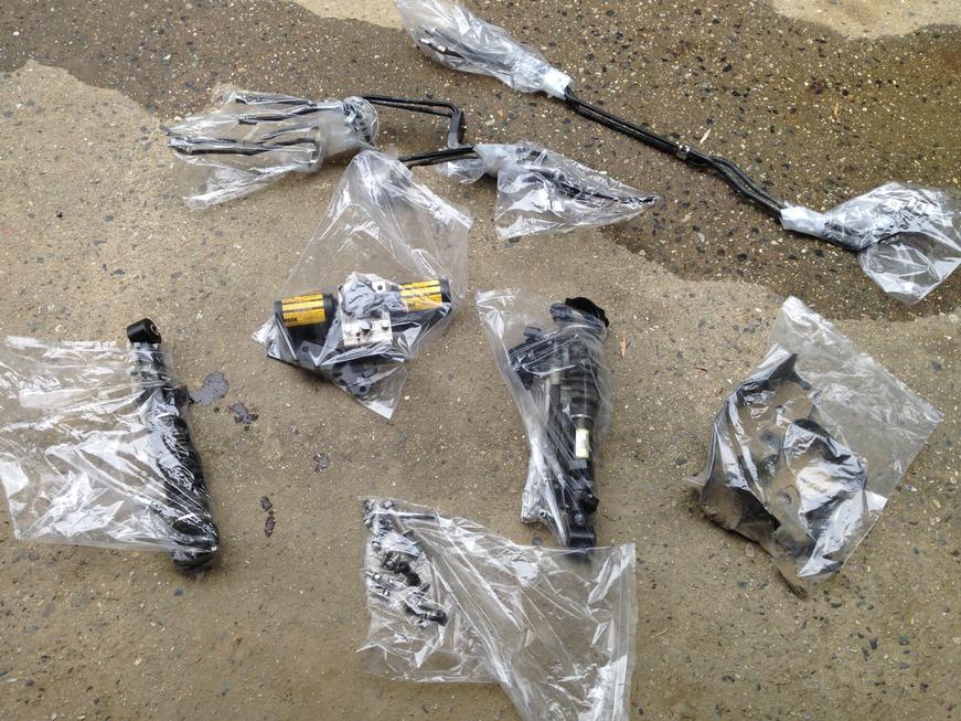

I remove all the KDSS.
A-TRAC, Rear locking diff, Crawl Control, all systems are functioning now.

I removed a KDSS connector, light of KDSS lit up.

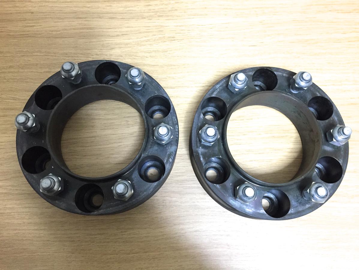

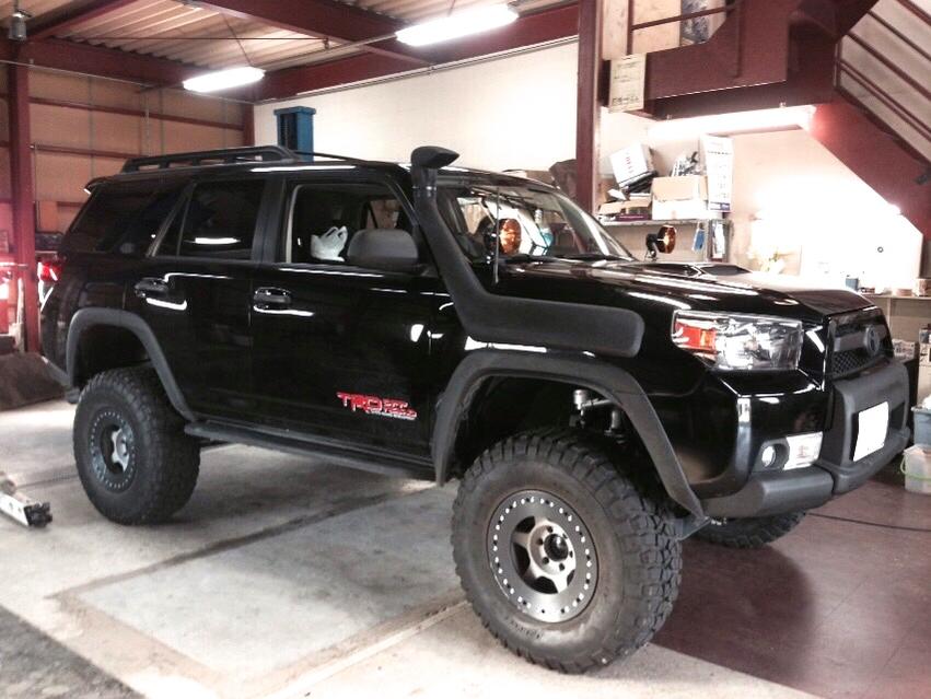

I used 16" wheel before.(TRD wheels 16 x 7.5J +10, BFG MT 315/75R16)
But there were some problems.
I have put a wheel spacers 1.7" Hub Centric in front, and I shaved front calipers.
But there was little space between front calipers and wheels.
I have already changed 16"wheels into 17"wheels.

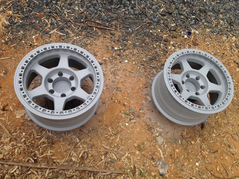

beadlock wheels
solid racing beadlock 17 x 9.5J -30 Matte gray
BFG MT 35 x 12.5R17

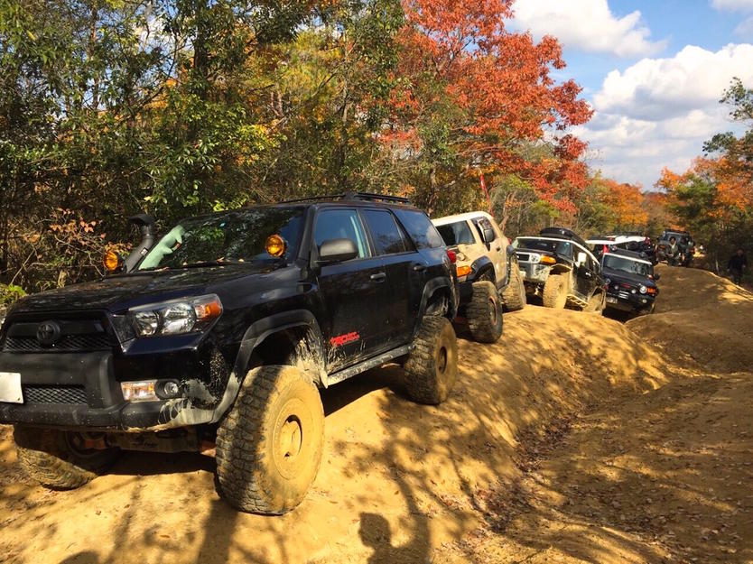

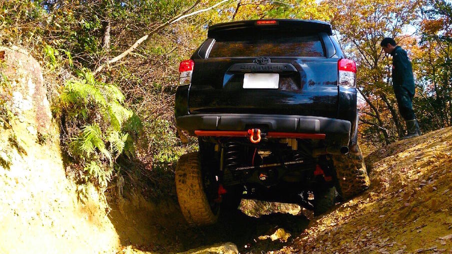

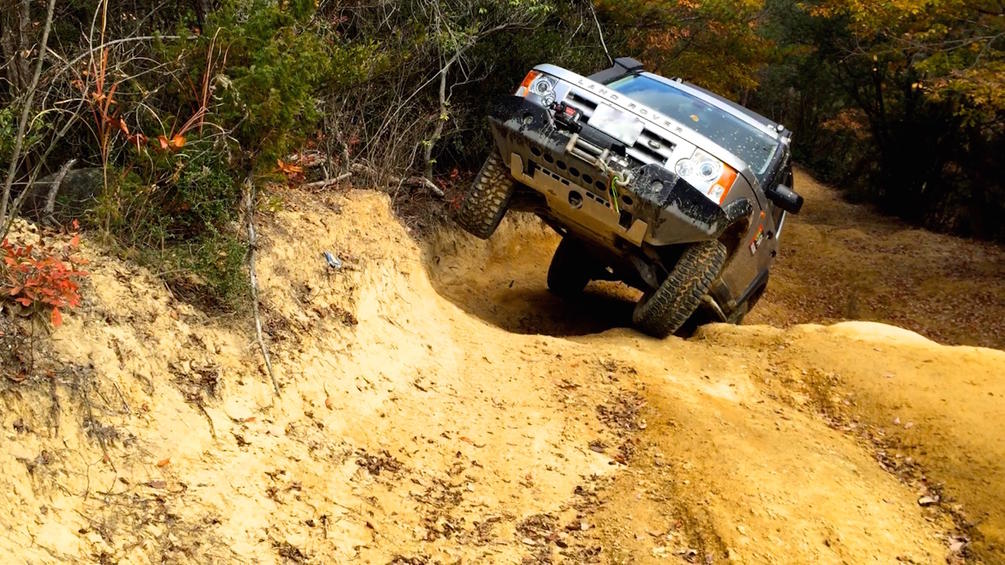

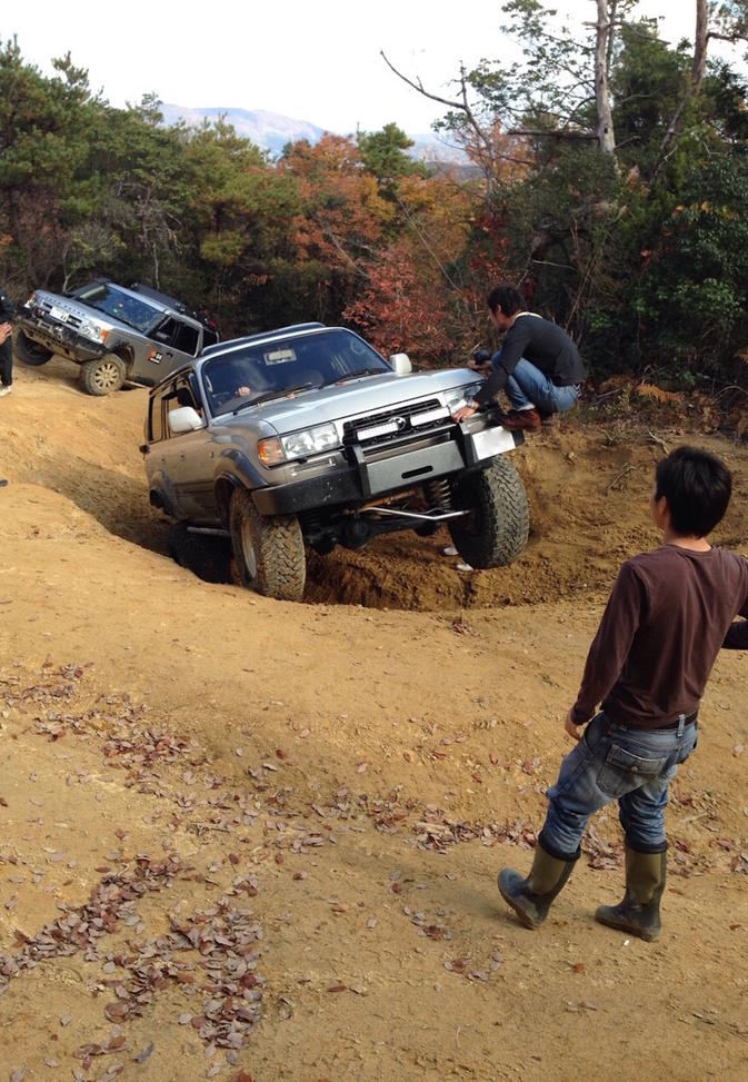

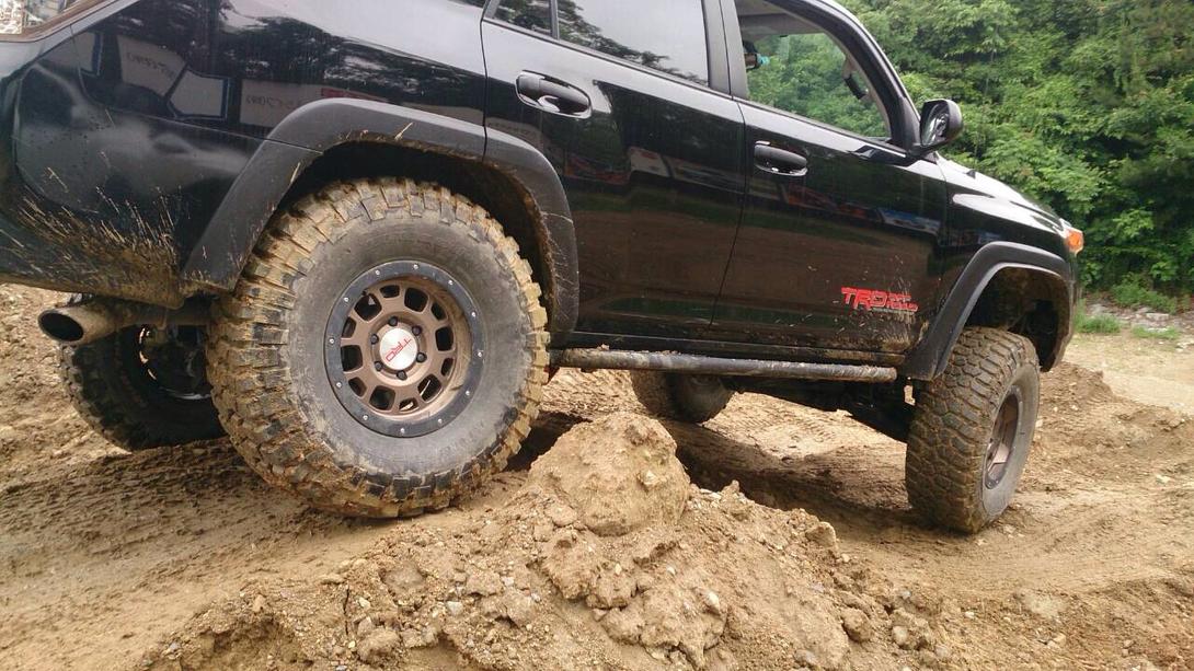

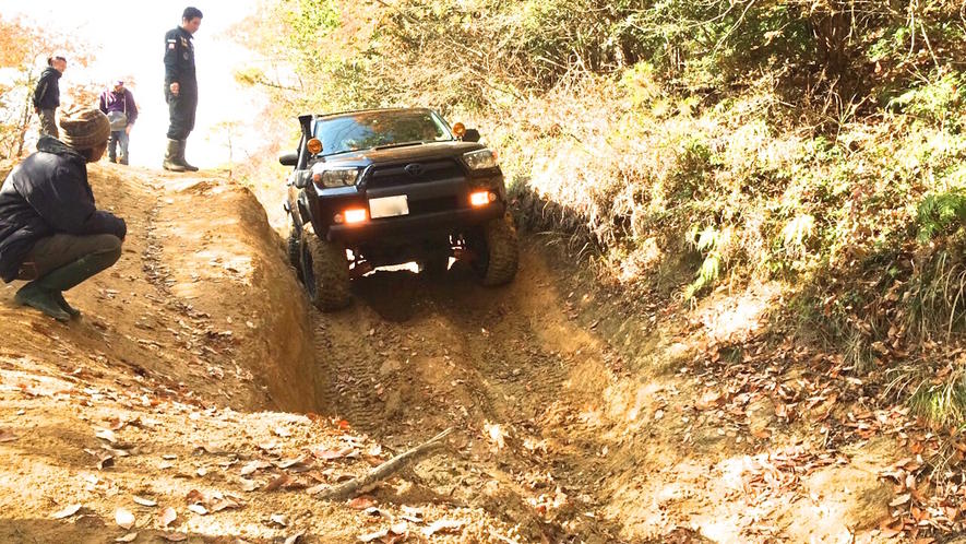

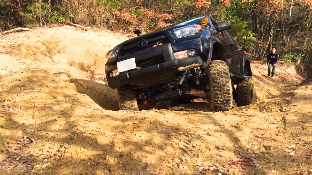

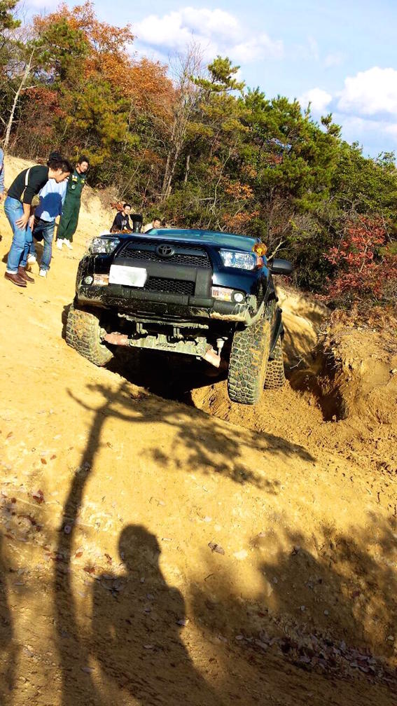

Okayama
OKAYAMA is very excited off road course.:bounce:
OKAYAMA is really fun place.

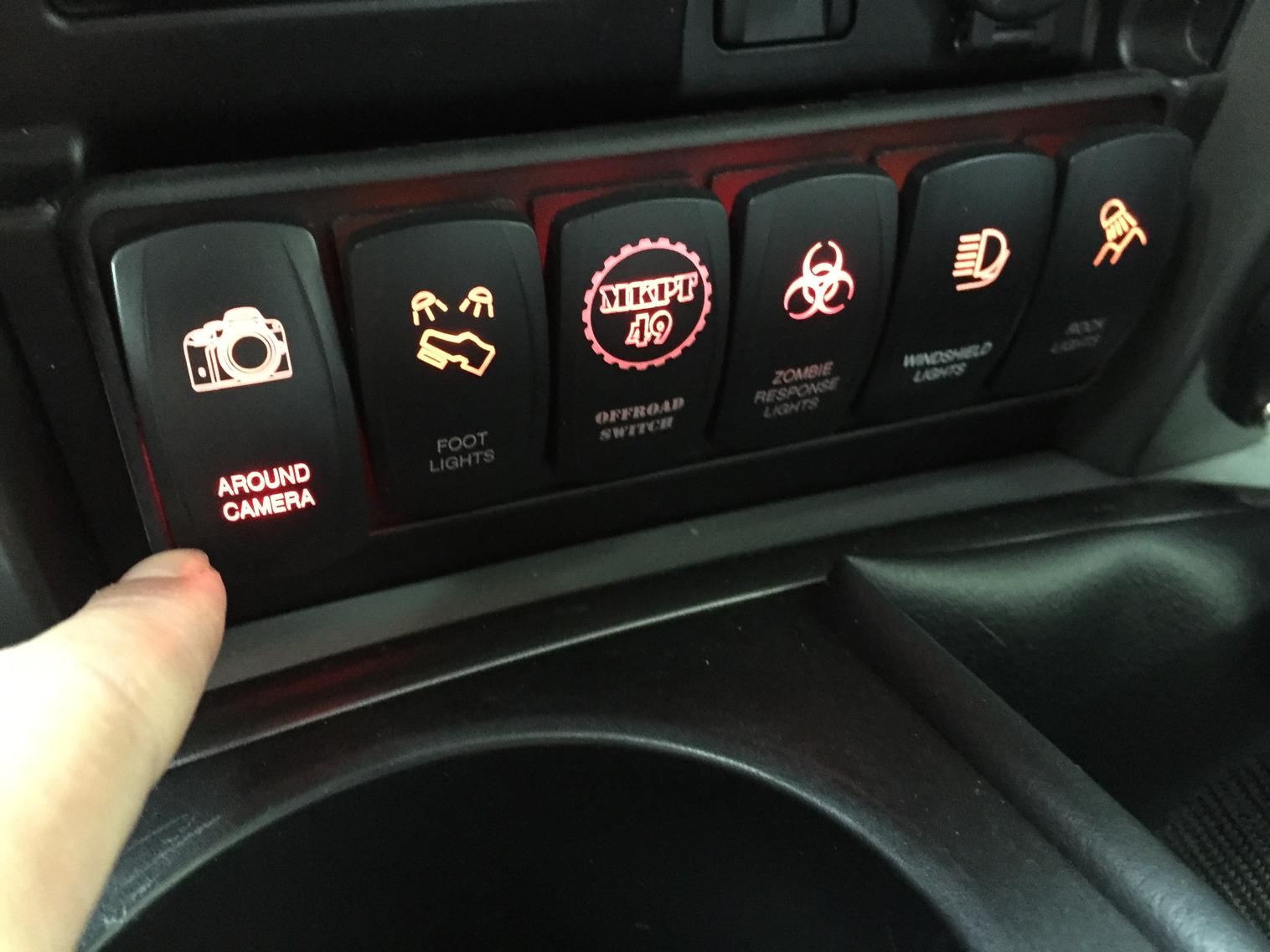

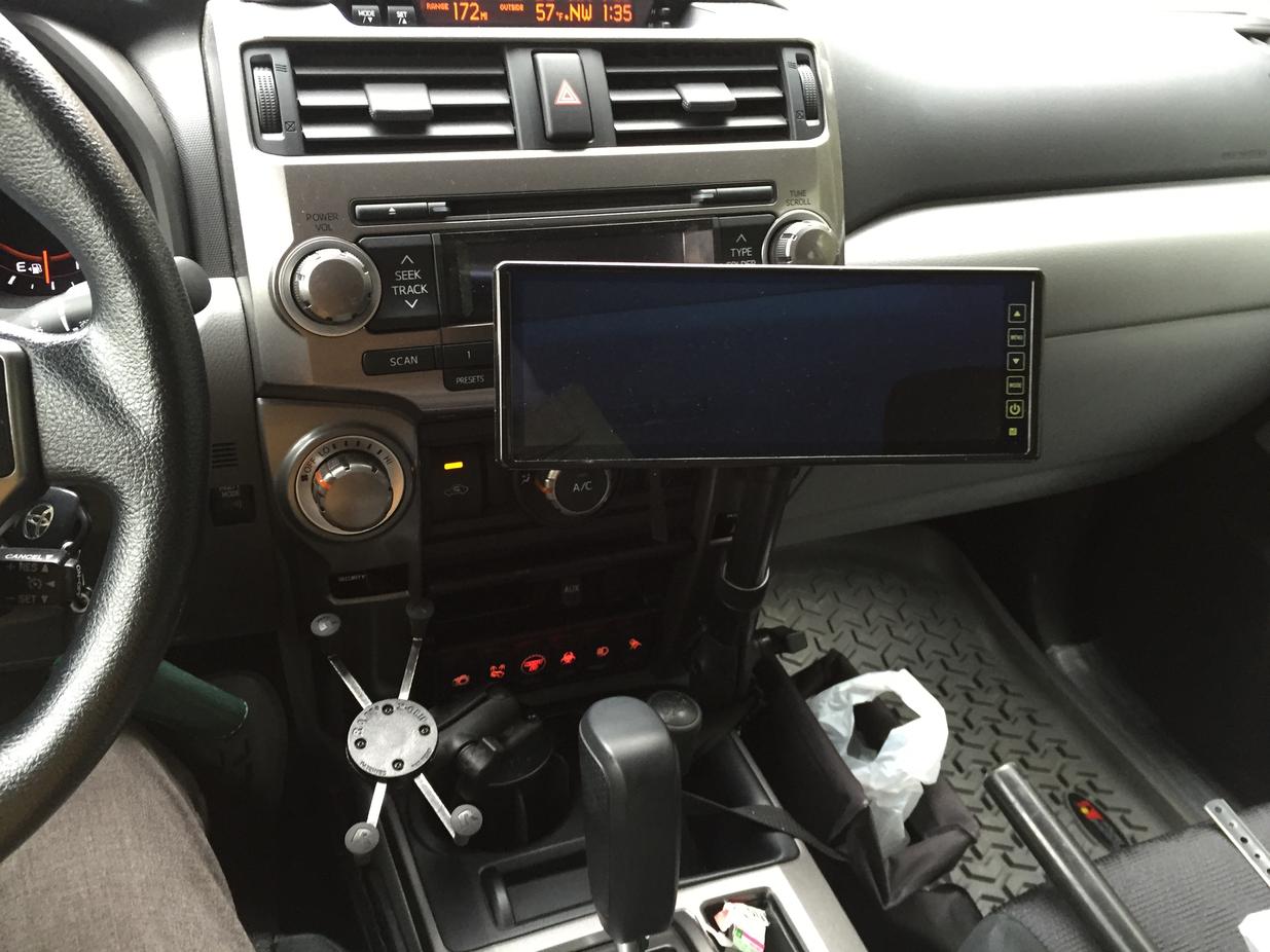

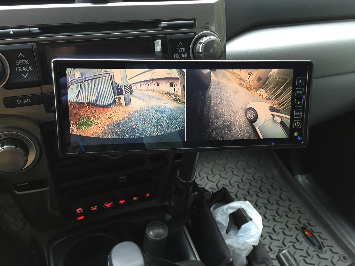

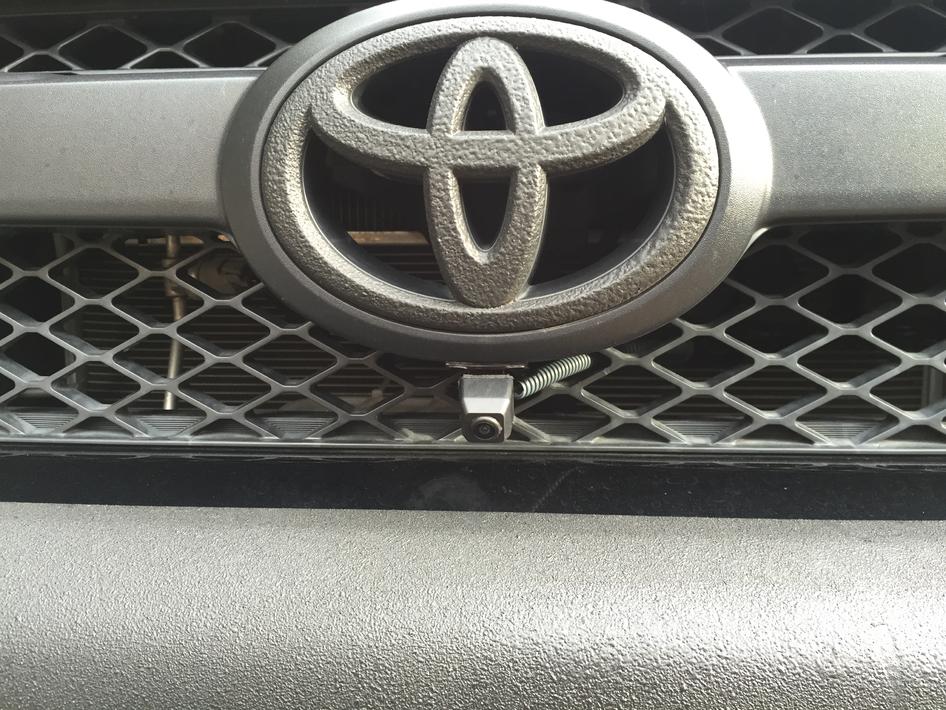

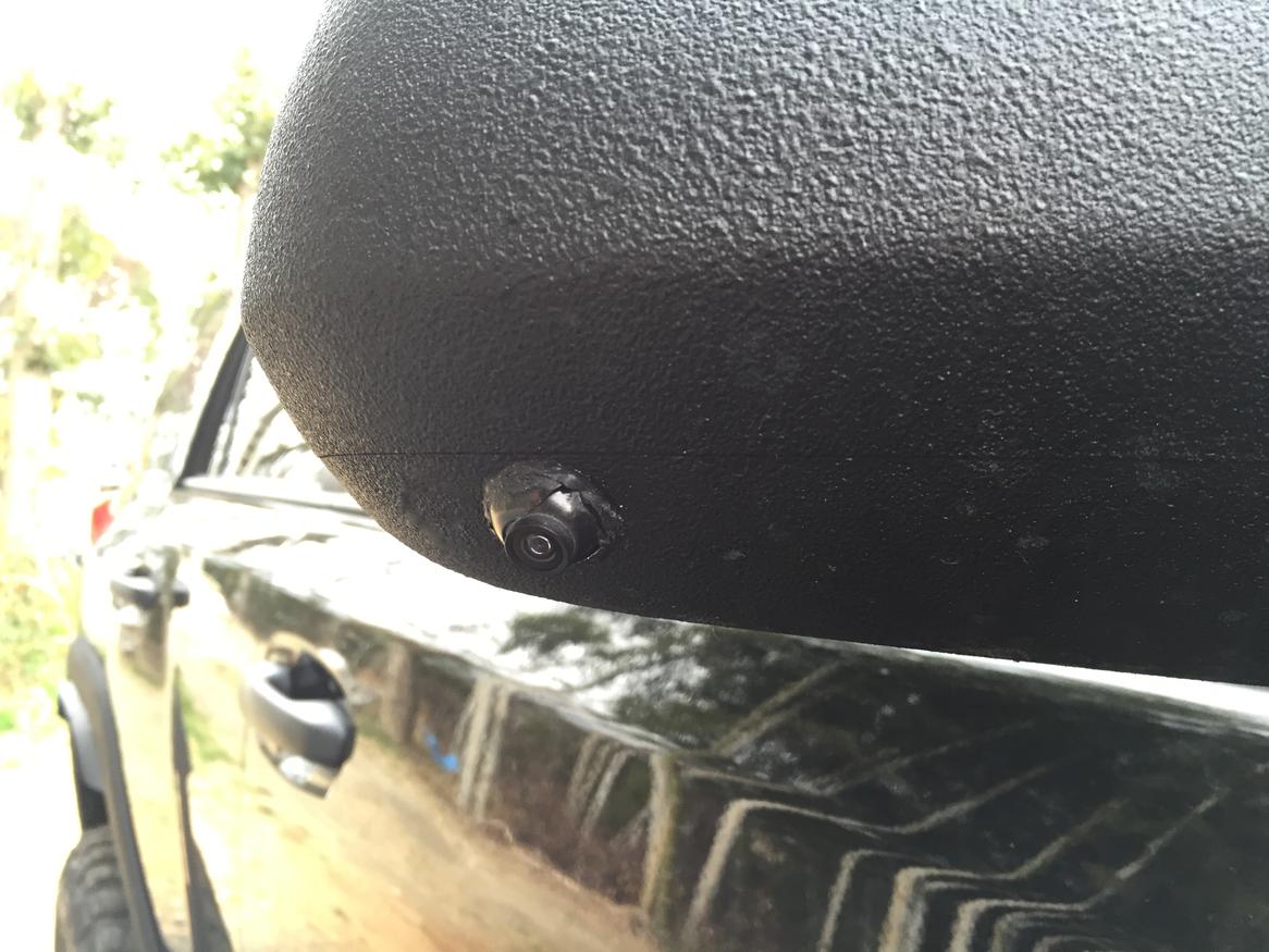

Front and side camera
My 4runner has many blind spots.
So, I set up a camera and monitor.
Camera and monitor help me always in the city riding and offroading.
