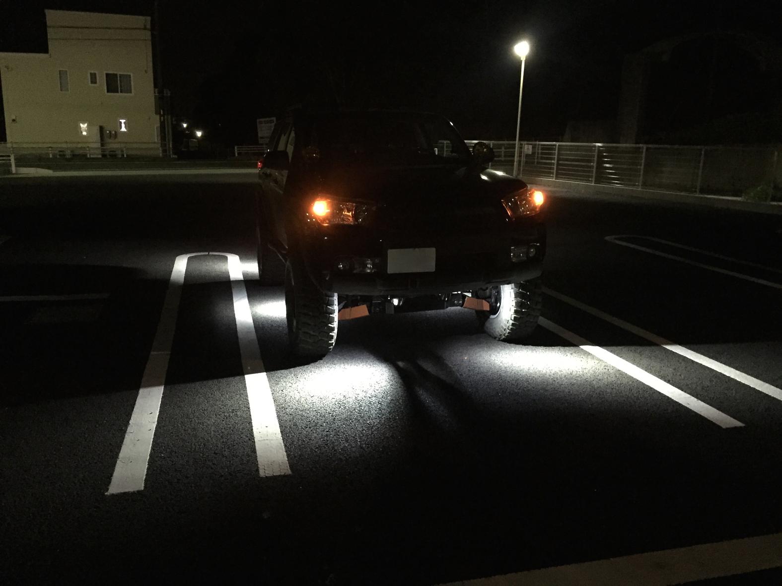

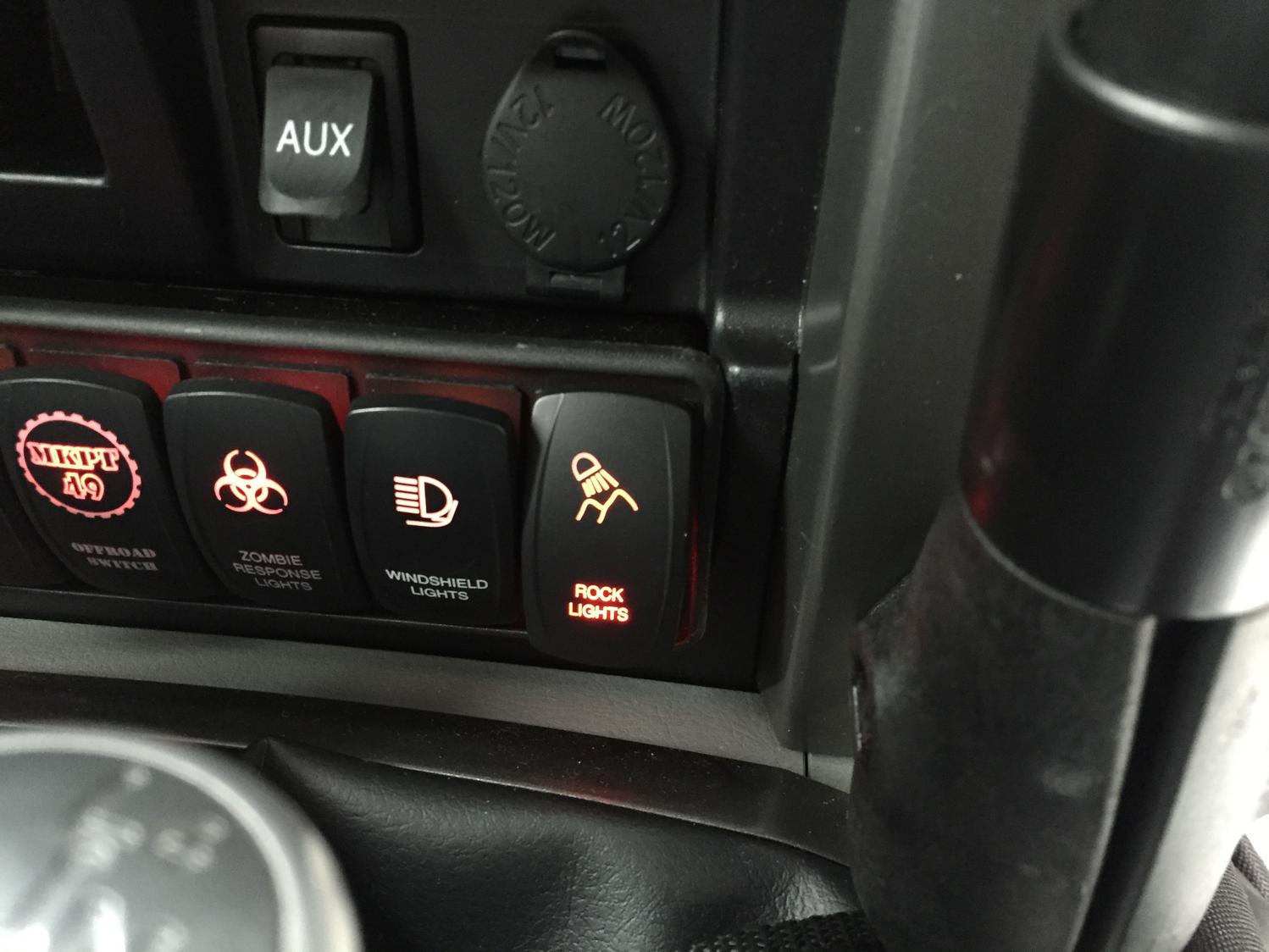

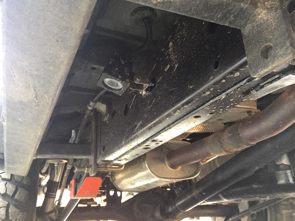

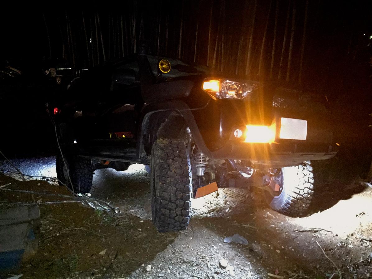

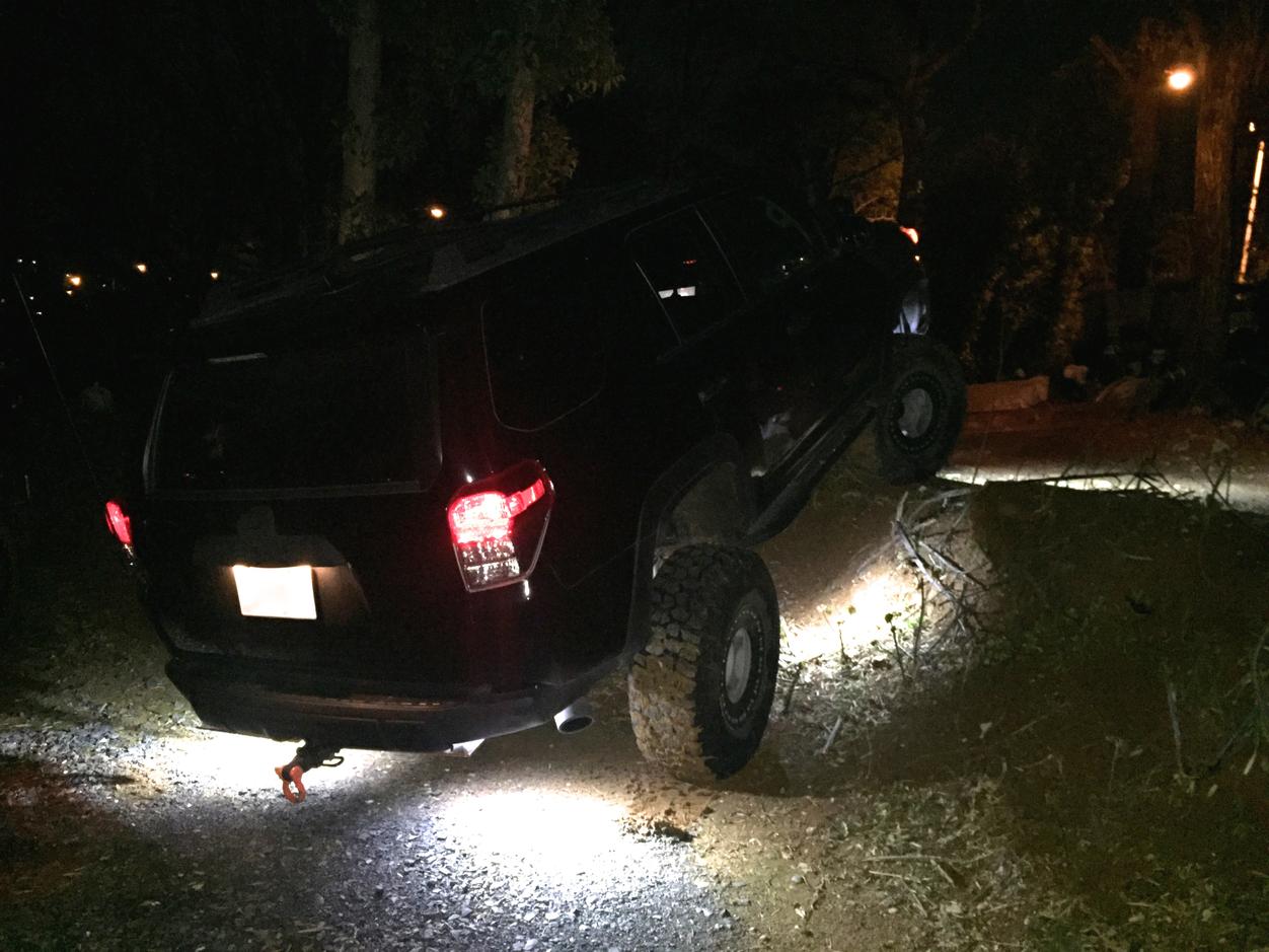

rock light
I've installed the rock light. I became easier to night offroad. This is quite useful.
But I had a hard time on the wiring.

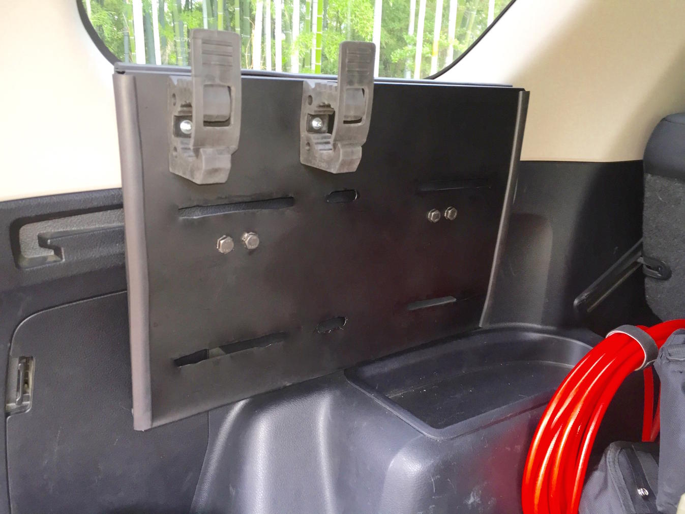

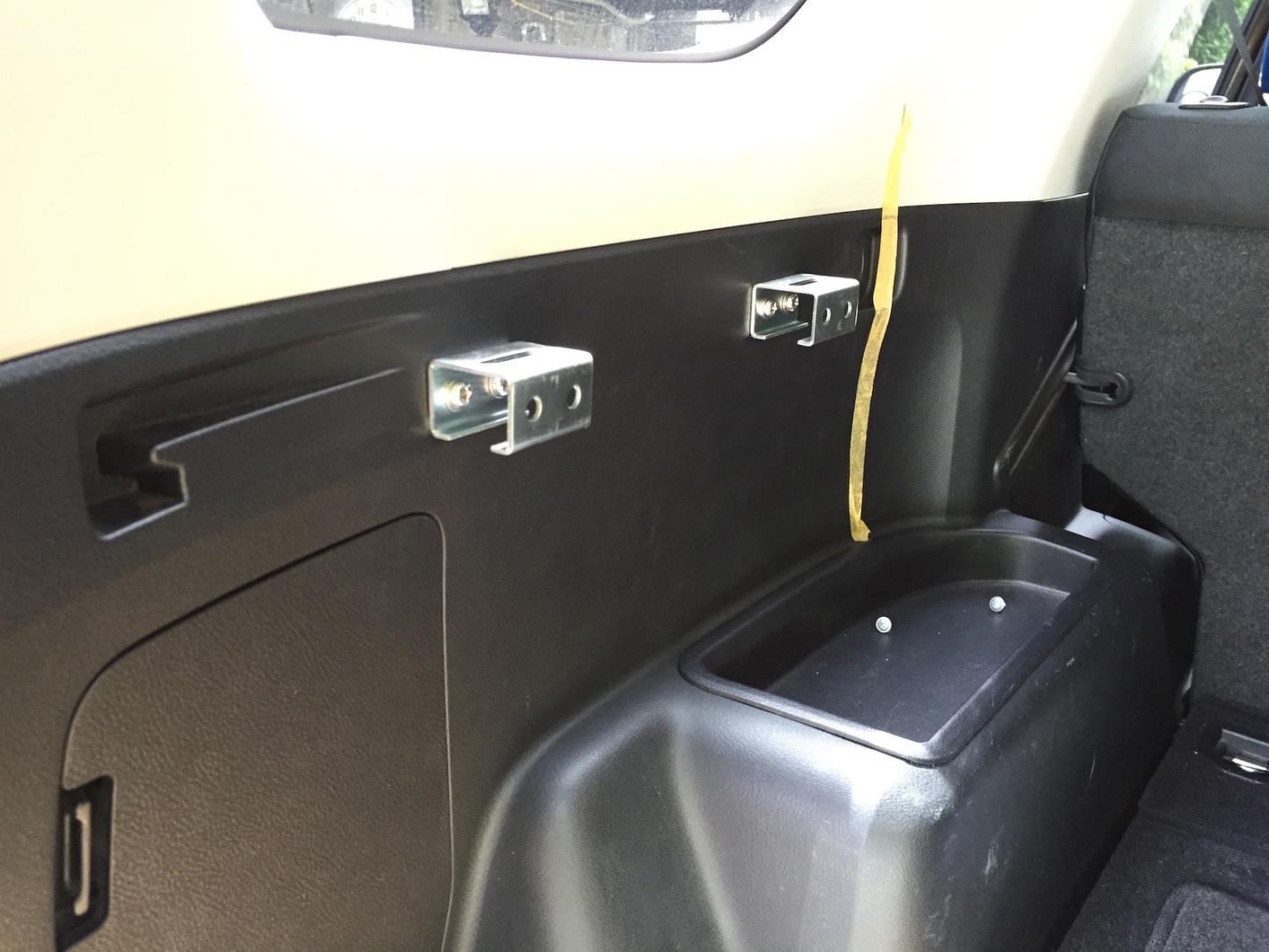

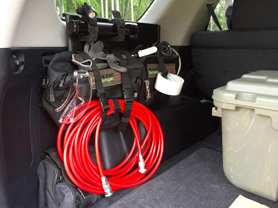

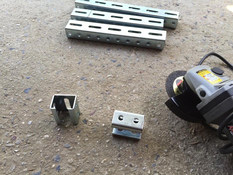

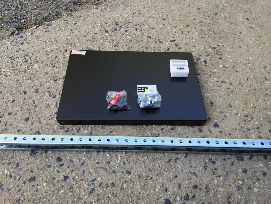

M-pac springtail
I made a plate for M-pac.
Fixing of the plate has been difficult, but it could well.
M-pac springtail is very cool

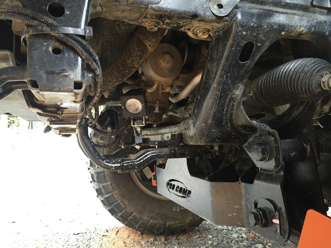

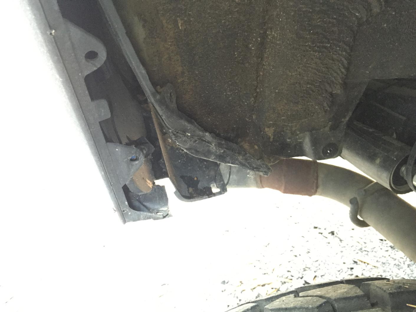

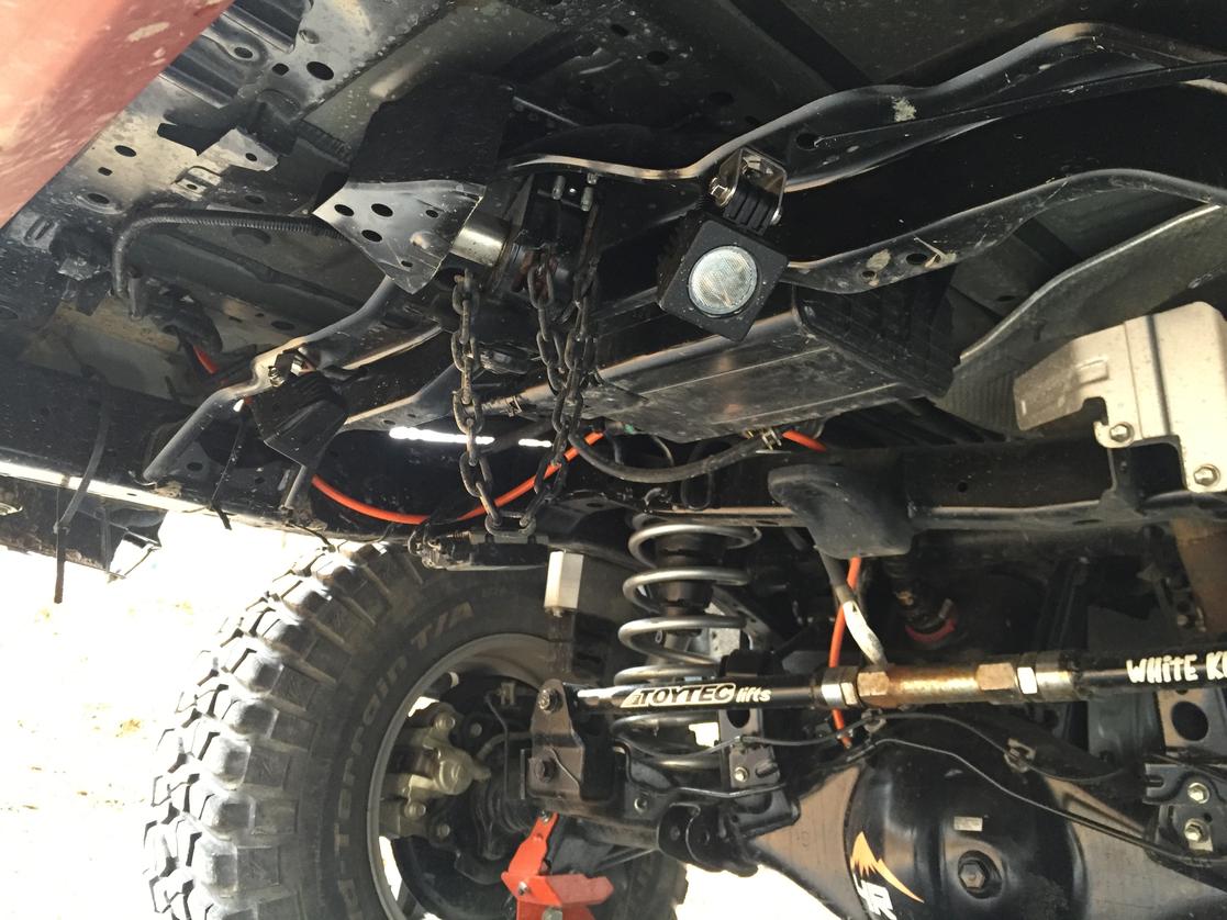

Hard to tell from your pictures - did you install an SR5 swaybar when you removed the KDSS, or are you running without any swaybars?
Nice rig, I'm looking forward to seeing more! Any rubbing issues with the 35s, or is there still room to go up to 37s with some cutting?
I haven't installed swaybar. It's a good move in the off-road. But it will roll at the city driving. So I'm going to install the front swaybar for SR5.

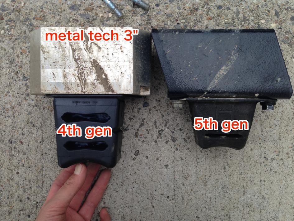

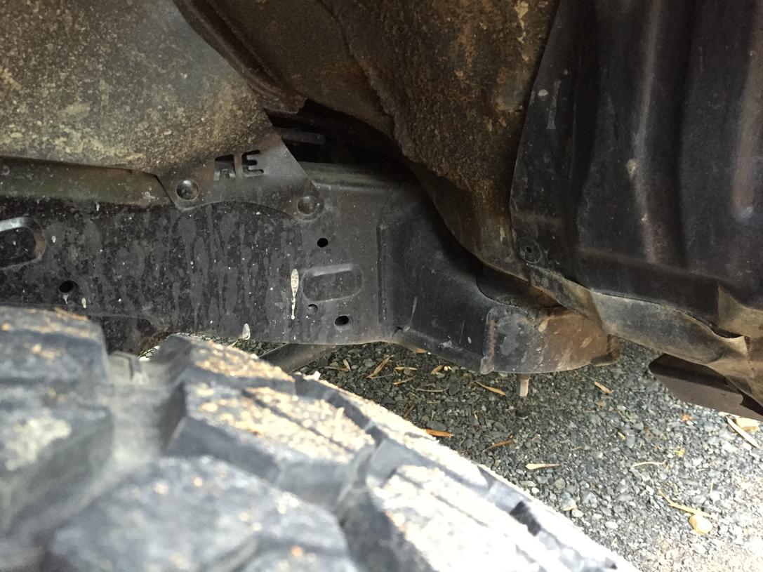

I was chop the front mount, and crushed by hitting the rear tire room. So it doesn't hit with the 35s. In addition I extended the bump at 4th gen bump.
If you want to install 37s, it would still need 2" or 3" lift.

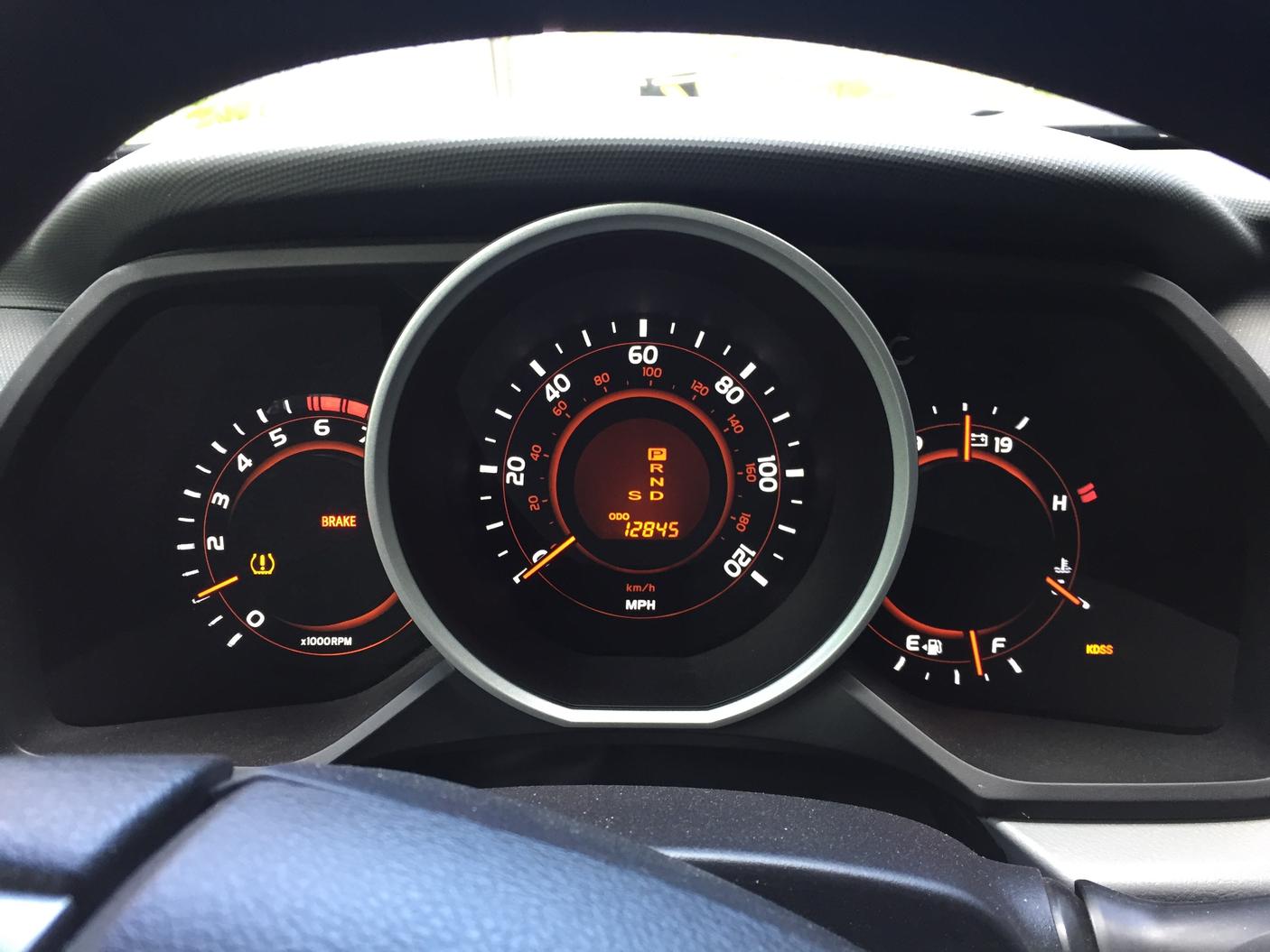

So do you have a constant kdss light ??? And does it have a check engine light with it....
Subscribed... I interested to see where this goes...
KDSS lamp is always lit, but Engine check lamp is not lit.There is no problem with the move:D
