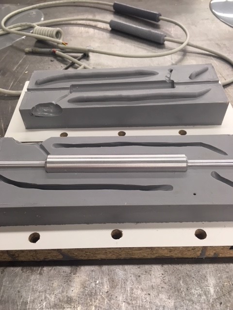

A couple molds I made from aluminum for a low pressure injection molding machine we have:

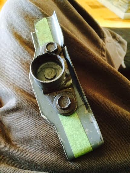

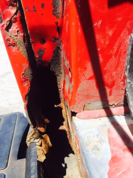

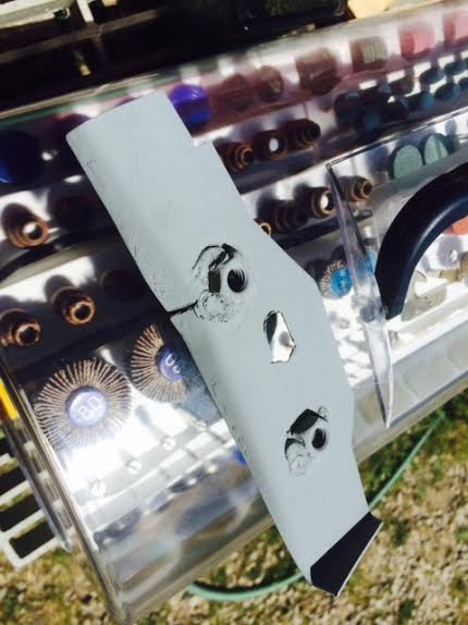

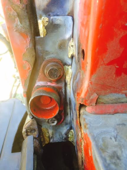

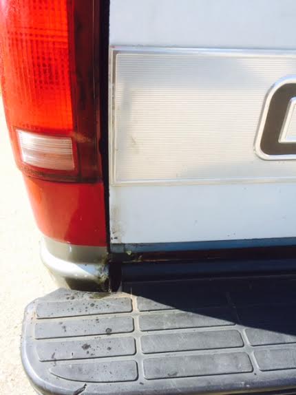

Tailgate Hinge Jam:
On my 1998 Silverado 2500 4x4 pickup, the left tailgate hinge jam, rotted out / while the box sides are still perfect.
- made a new piece out of 16 gauge sheet metal / I cut up a scrap SQ-D electrical box, for thicker metal over body steel (typically 19g)
- most difficult part was measuring x/y/z coordinates correctly, & welding nuts on the backside
- check to fit, only works once the fabricated patch, is brazed in solid / surrounding metal a little thin to mig, in the driveway
^^ Once completed, the tailgate lined up perfectly / and hinge fabrication was strong, my tailgate can hold a lot of weight again.

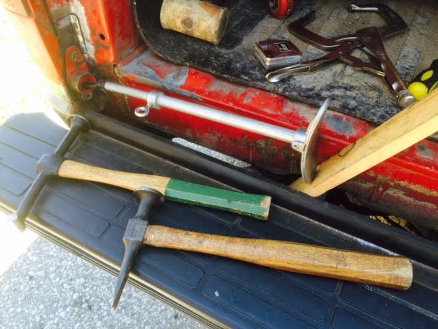

My 3 favorite tools:
a) aircraft aluminum (adjustable length) patch holder, with ductile iron forked end / a clever & practical tool, aka providing a "3rd arm"
...from 1980's
b) Proto #1426 body hammer / good for forming door edges and shrinking lips...from the 1980's
c) Snap-On #BF604 body hammer / my first tool purchase, in grade12 ... forge quality is awesome, still no dents on face...from early 1970's

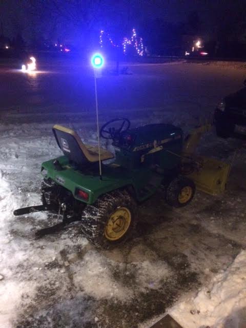

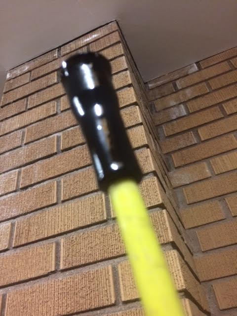

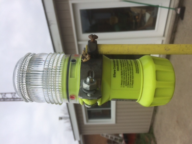

Beacon-Strobe Light Mount, on John Deere 318 - for snow blowing safety.
- used a 3/8" diameter fiberglass Chimney Sweep Pole / cheap garage sale find
- hand fabricated the top mount, to the pole / and brazed on a nut to secure the hand threaded yellow pole
- bottom pole mount to Garden Tractor Pan, required a washer & inside nut be brazed on the end / to accept a bolt, through bottom of pan.

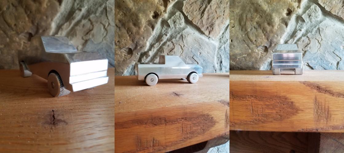

In my career I have designed countless components and systems. I have had the pleasure of personally making many of the prototypes myself. When I first got out of college I designed high pressure hydraulic telescoping cylinders. For this thread though I will post a fun little project I did 20 years ago for my (then) two year old son.
Material: T6, T1 and steel
Type:
2" bar stock for the body
.875 T1 dowel for the wheels
.125 mild steel dowel for axle
The only tricky part was press fit of axle into wheel. Anyway, my son played with this for a long time. He just finished his BSME and is working on his MBA. He told me to keep it on display so when he has kids they can play with it.
Also, I am not a machinist. I am an engineer. Machinists actually know what they are doing when using their equipment. I just piddle.
BTW I also made the mantle it's sitting on. 4"X18"X12' long. Also cut the gussets. Material is red oak. Enjoy!
