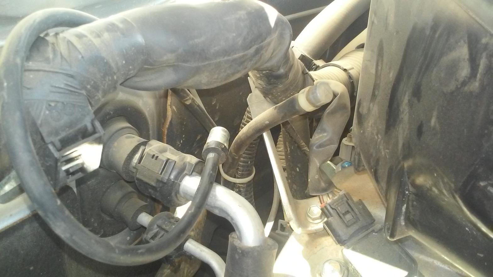

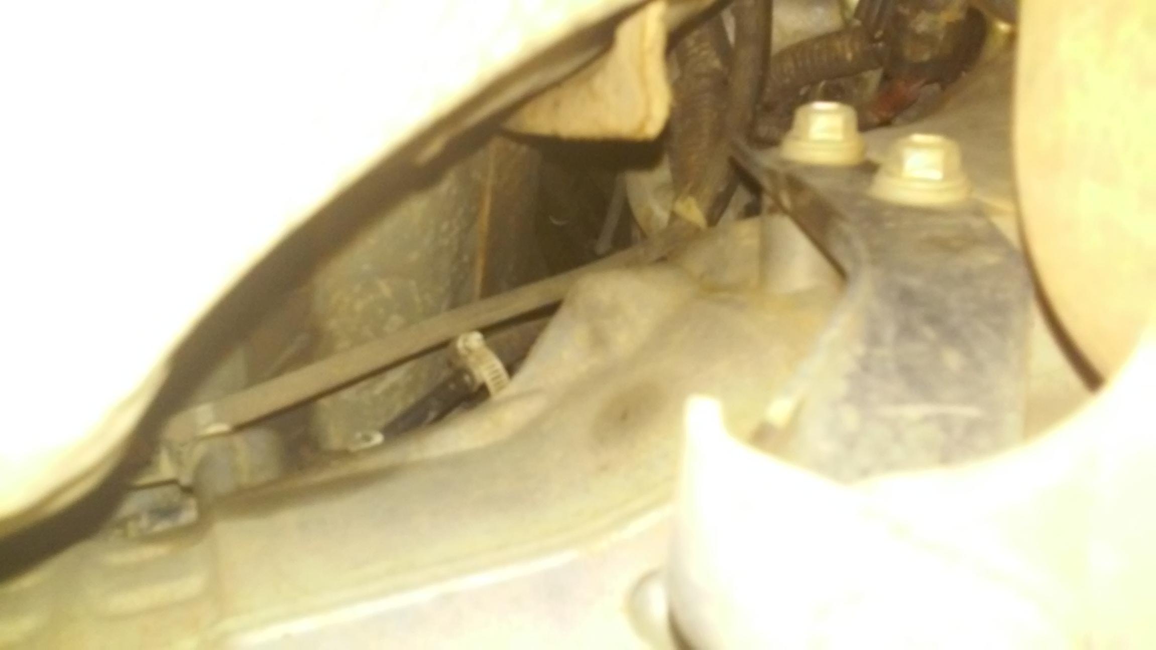

When your by the 2nd cat looking up there, you can see the metal line with hose and clamp, this is the trans breather. The smaller hose you see above it is the transfer breather line that you lost.
This is what i did to extend and never finished. 2 diffrent hose sizes.

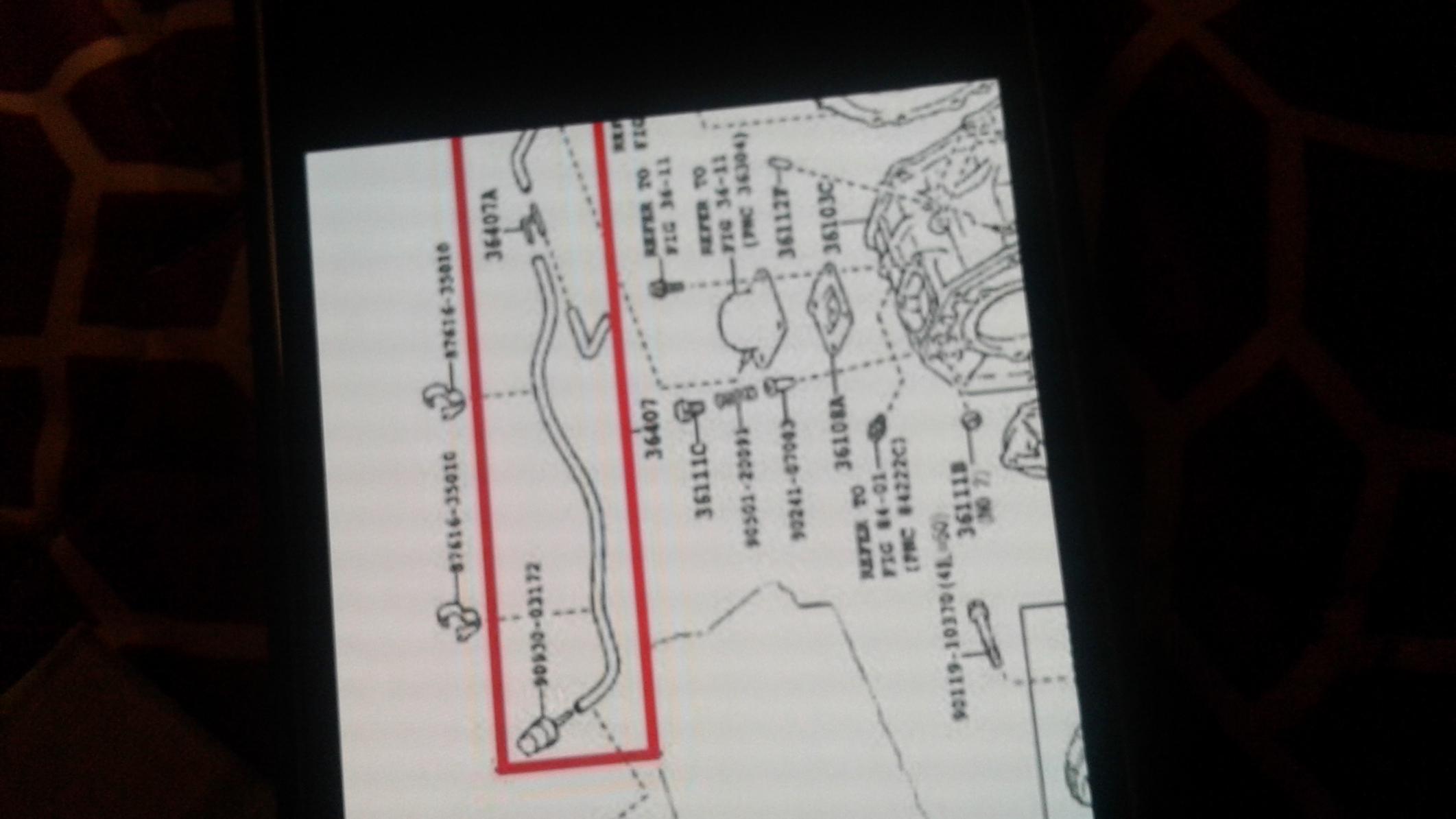

Mine actually has a T fitting, connecting the transfer case and transmission using two shorter hoses of the same diameter AND a larger transmission breather. I assume to equalize pressures..
I've attached the toyota diagram showing this hose, in the red box.

See above. Mine was connected to both via T fitting and shorter tubes. And the larger one youre talking about... Weird that yalls aren't the same.
Correct, yes I do have the same "T" connector line like yours in the video and diagram and hooks into the rear side of the trans area. I do believe it is the transfer case breather. The 1st picture I showed is a metal tube line on the front of the trans, about 4-5" back from the bell housing.
