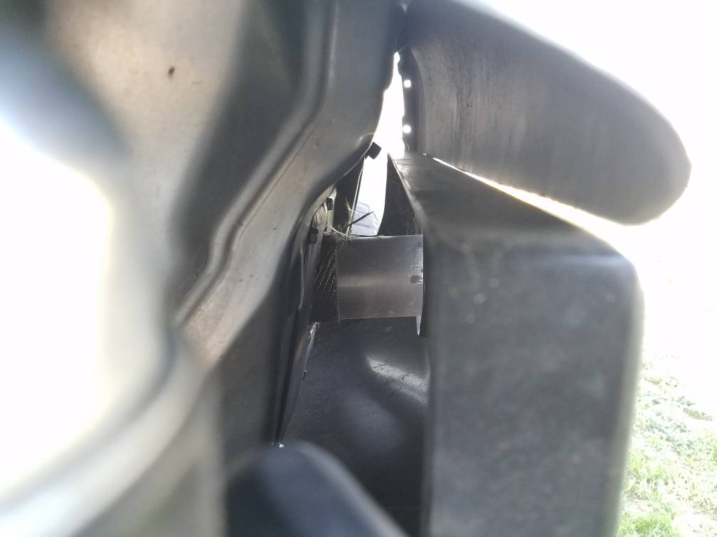

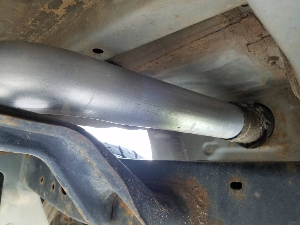

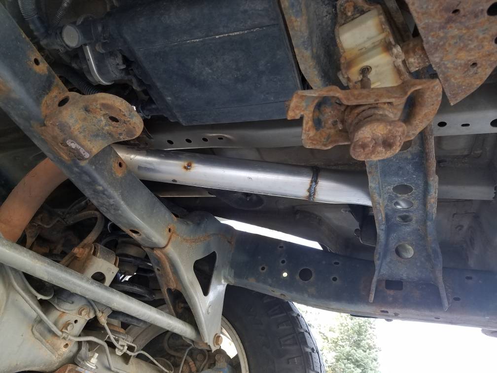

It routes through the vent of the cab. Ill get some pics later tonight
As requested
Sent from my SM-G930P using Tapatalk

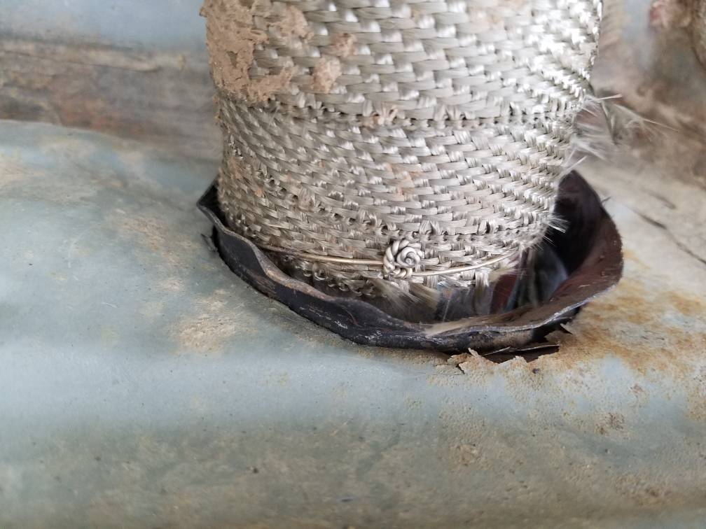

Cool, very creative, I assume you flexed the suspension to see if there was any rubbing/binding. I think I would maybe squirt a bead of some RVT sealant or some such, to keep the water out, at the through body sleeve.

As for the new hole in the side, if needed I could just add a couple drain holes since RTV may not like the high temps of the pipe

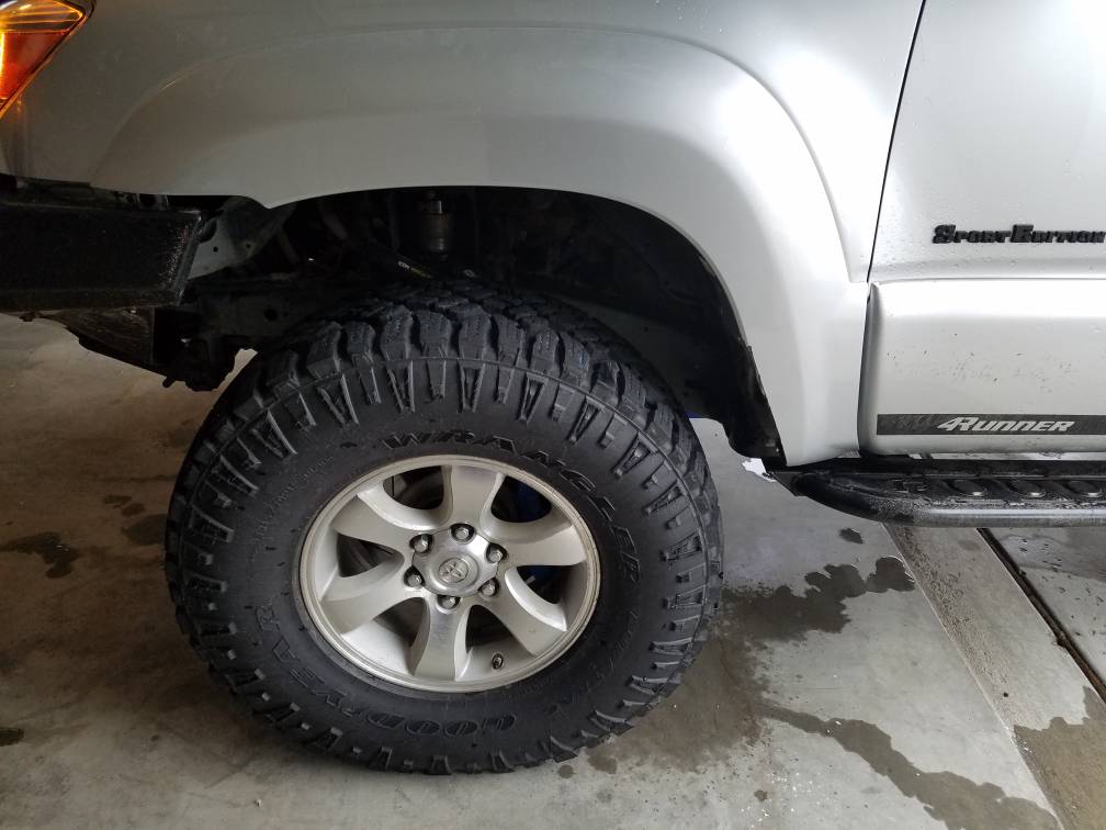

Are you regeared? If not, how's the driving experience with the 35's?
Not regeared, Its a V8 still so the rig can handle all the weight I have added to include the 35's. I have rubbiing on the swaybar on full lock but no issues driving around town, offroad or even down to Fort Collins.

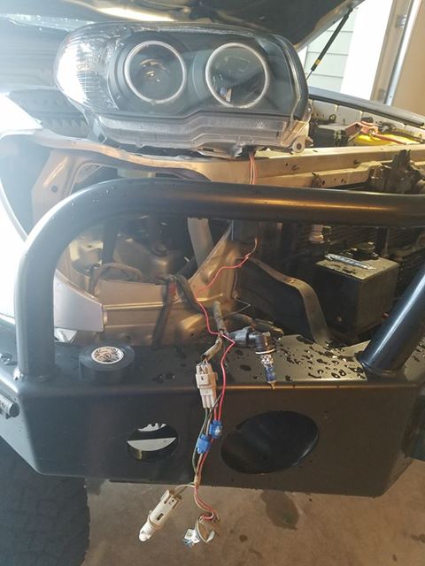

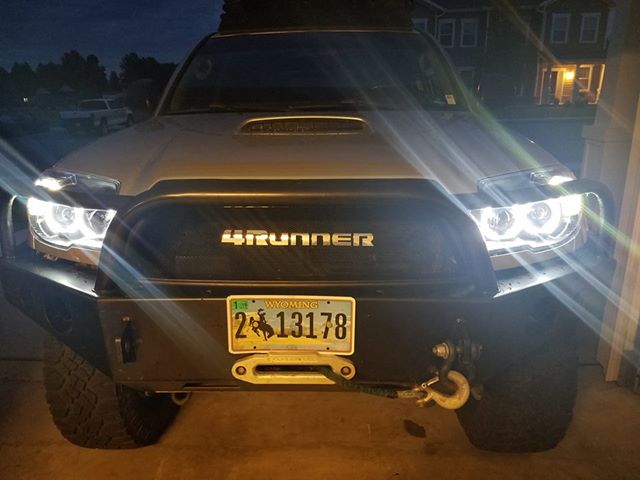

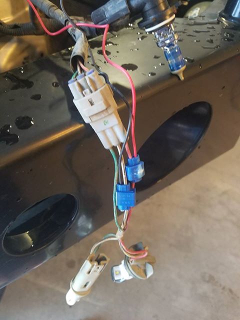

New headlights from amazon
I purchased; https://www.amazon.com/gp/product/B0128SCKPE/ref=oh_aui_detailpage_o01_s00?ie=UTF8&psc=1 so I could have some halos to drive around with.
The wiring was spliced into the DRL wires and all others are plug and play. The new changes are the DRL and front turn signals are cool white LED's. The entire job took 2 hours because I was trying to trouble shoot headlight bulbs ( I bought the wrong one in the end) its a great project.
