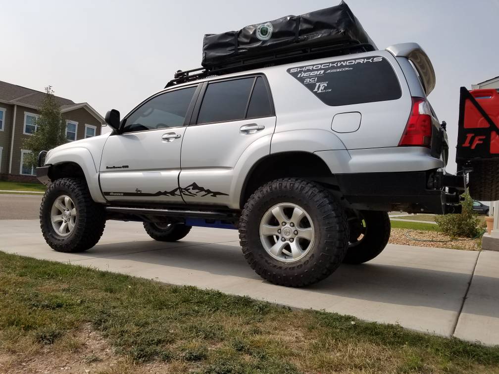

Suspension
- Icon Vehicle Dynamics Stage 1 lift kit
- 3" Icon rear Overland Springs
- Sway bar extension bar
- Icon Vehicle Dynamics Tubular Upper Control Arms W/caps
- 315/75/17 Duratrac's
Armor/Off Road
- Shrockworks 3 hoop bumper
- Insain Fab Rear bumper (dual swing arm, double fuel can, side exhaust in the bumper)
- Gobi Stealth Rack with sunroof option
- RCI full skid plates (steel)
- Ramsey Profile 9500
- Synthetic winch line
- ARB Snatch Block
- ARB Snatch Strap
- POR-15 Undercarriage coating
Outfitting
- Bigfoot Roof Top Extreme Tent (3+ person)
Lighting
- 32" Night LED Combo light bar
- 2 4x4" Amber fog lights
- Using 2 FJ switches (mounted next to DAC)
Adding USB switch and moving DAC
- Mictuning RGB rock lights (8 Pack)
Communications
- Uniden PRO520XL CB (hard wired)
- 4' Firestick
Exterior
- Satoshi Grill (not flushed with grill) with 5th Gen "4Runner" Emblem
- Plasti-Dip- Grille, and all badges
Blacked out Headlights 06' Sport DIY
Plasti-Dip First timer.
- Custom "4Runner" skirt decal w/overland truck (self printed and cut)
- Aftermarket Halo (white) headlights with black interior
Interior
- V-LEDs brand 6K LEDs
- Dome light (middle and cargo)
- Reverse Light
- Door Lights
- Map Lights
- Registration Plate Lights
- Glove Compartment Lights
-Custom Dash and Stereo LED colors
Engine/Performance
ECGS 4.88 gears
4.7L V8 Thats it!

Thanks for sharing your pics, I really like the blacked out headlights, I've always wanted to do it, but am scared I would mess something up/have moisture issues after attempting it!
Question: have you noticed any decreased headlight brightness since you did the blackout?
Shrockworks & "toys" look like they will be a nice addition, can't wait to see the final product, haha.
How long did it take you to do the back end suspension install?
p.s. love OBX, used to live in VA and visited OBX yearly during the summer, awesome place!
I really like where this build is going.
And I thought I had a lot of PIAA lights, where are you putting all those?
Question 1: "have you noticed any decreased headlight brightness since you did the blackout?" No, if there was, it was super little. It looks great at night too.
Question 2: "How long did it take you to do the back end suspension install?" It took me about2 hours each. (coming from a guy with no mechanical experience)
Also, dont be afraid if you get moisture let it dry then apply a sealant. And work slow and firm when taking the cover off. worst care you have to hunt in the junk yard for new ones (doubt you need to).
