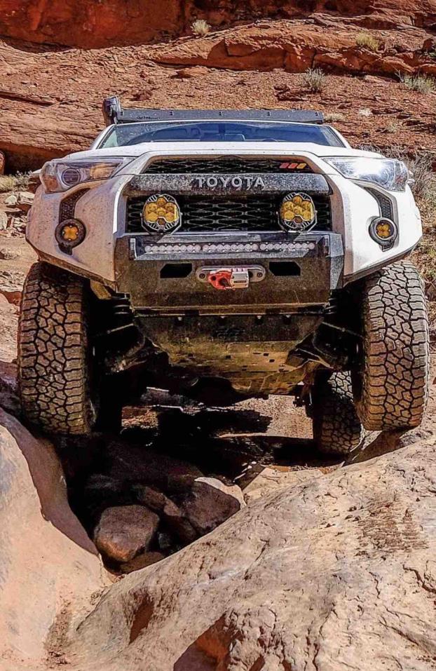

Is anyone running maganflow overland with 4.88 with 35's
Hey everyone, Im running 4.88 gears on 35s and curious if there is drone issues noticed by anyone that's running this combination. the RPMs haven't changed much except when I'm climbing, but im hoping my cruise rpms aren't out of the sweet spot for this exhaust etc. Thanks

Would tell ya as soon as i get my gears and 35s on. Its a lower note than the drone from Pro exhaust.
Currently I'm at 2200rpm/80mph and 2700rpm/90mph and cabin buzz is nore comfortable than with original exhaust while cruising. Expect the rpms to be closer to 3000rpm at 90mph.
