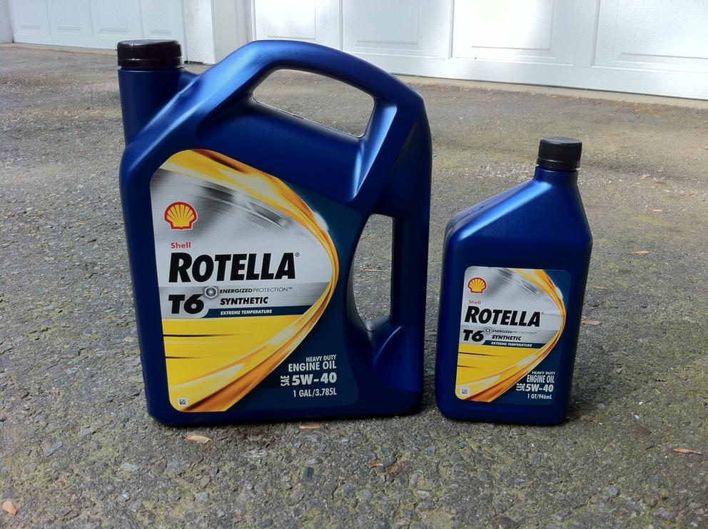

oh I would also 1) flush/replace your power steering fluid w/full synthetic. 2) Use Shell's Rotella T6 w/Wix filters, 3) run Startron Always, you'll be glad you did from the start and 4) flush/replace w/synthetic brake fluid.
