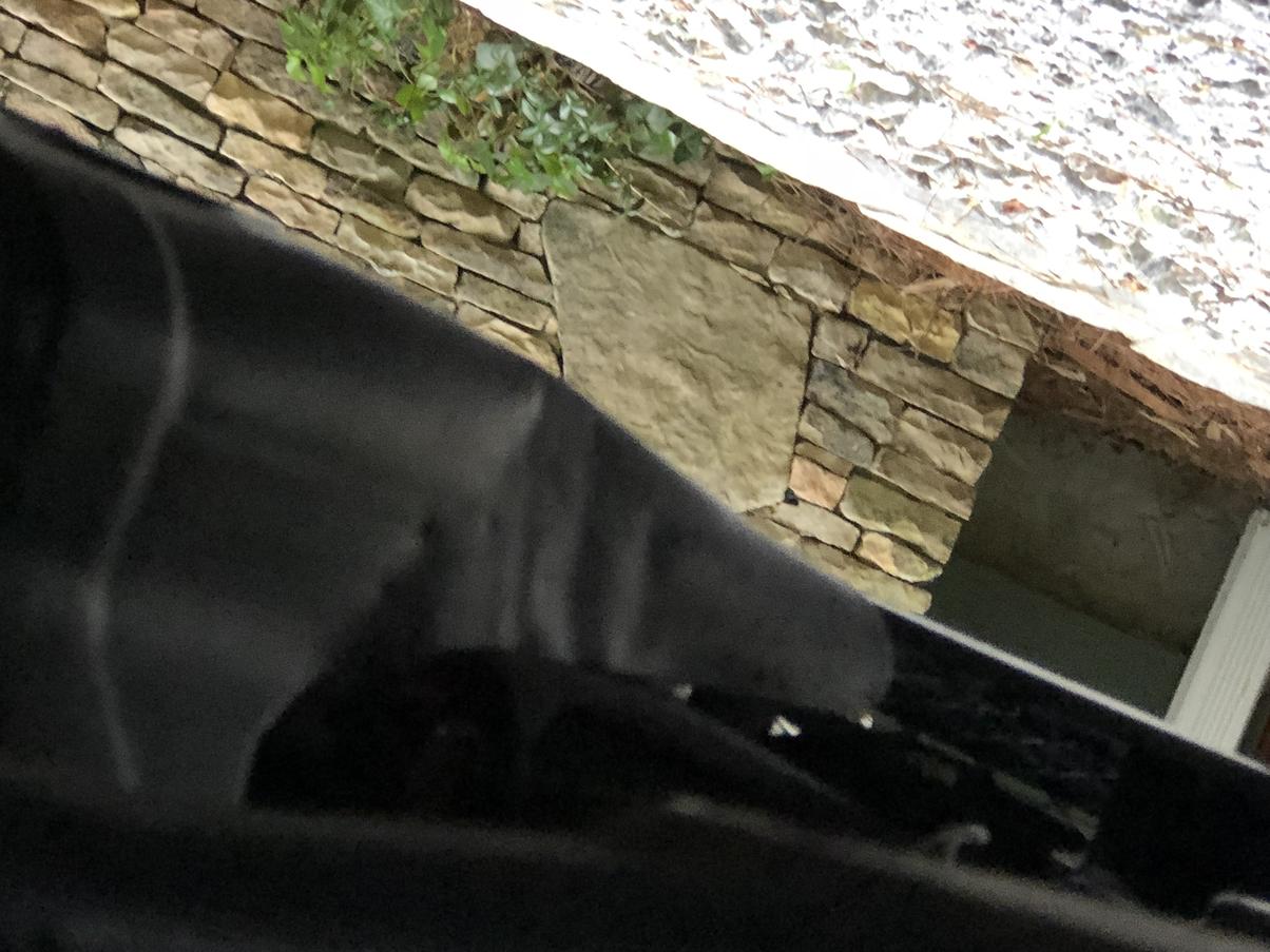

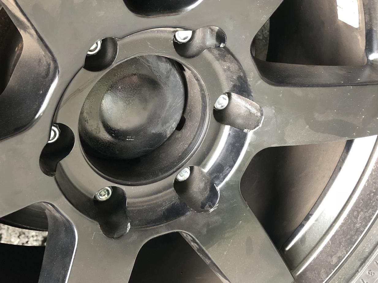

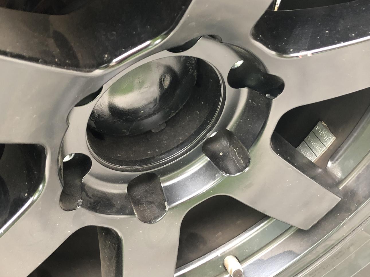

So I just picked the car up the abs wire they said they would replace it’s currently electrical taped. The guy that worked on it bent the skid plate back out some and painted over it but it’s still considerably damaged. Both my new front wheels are pretty scraped up now too and the vibration is still there.

insist that when they are done that you want a dealer to inspect their work. If they balk get a lawyer and ask for their insurance info as you will be filing a claim.
This sounds like a shitshow and would be highly skeptical they can fix anything they broke. As evidenced by their skidplate "repair", they just dont care and want you gone.

No way would I let them touch my rig again. I agree with the others, take it to the dealer and get it repaired correctly. I understand it is an additional cost, but at this point the vibration and abs is a safety issue. Document everything and let them know you will be handing them a bill afterwards. If they balk, see you in court!
