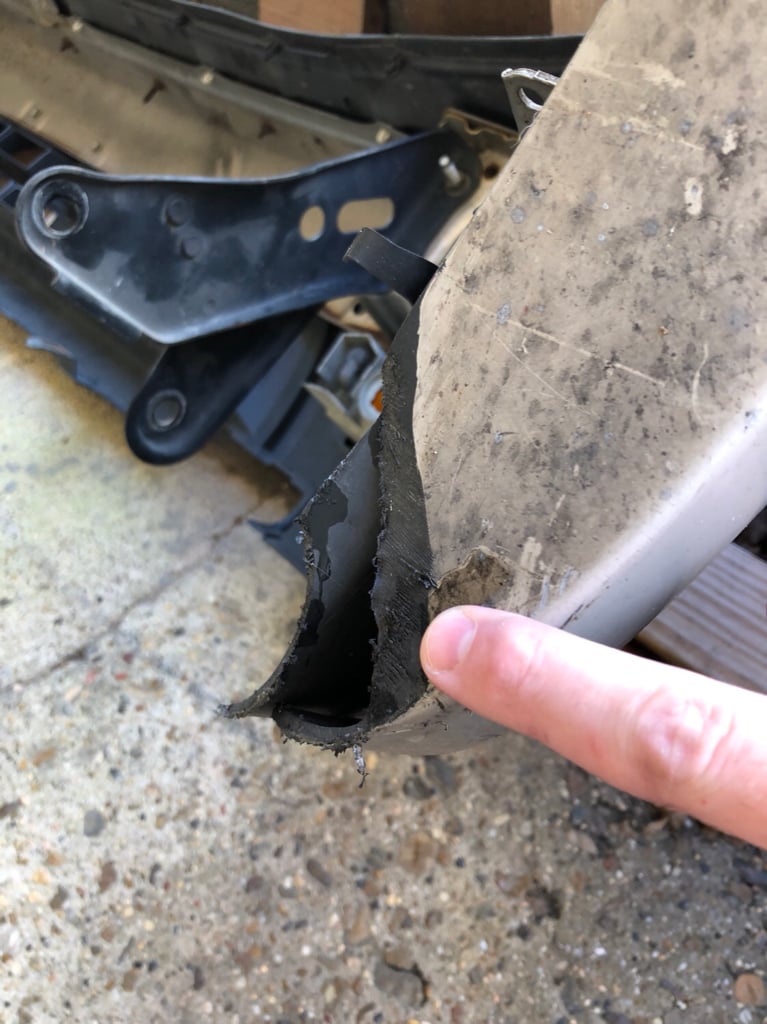

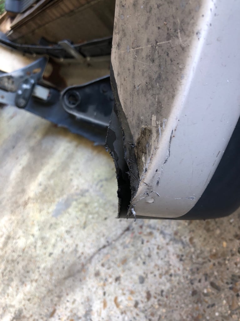

I didn’t have to do any of this except for the lift. I run 285/75 Toyo A/Ts. My hub to center measurement on the front is 23.25”.
Before I put on my bumper, I had to trim the inside edge of the stock fender flare that was part of the bumper right in front of the tire. Don’t have a pic on my phone but can get you one if you’d like.
Hope that helps!

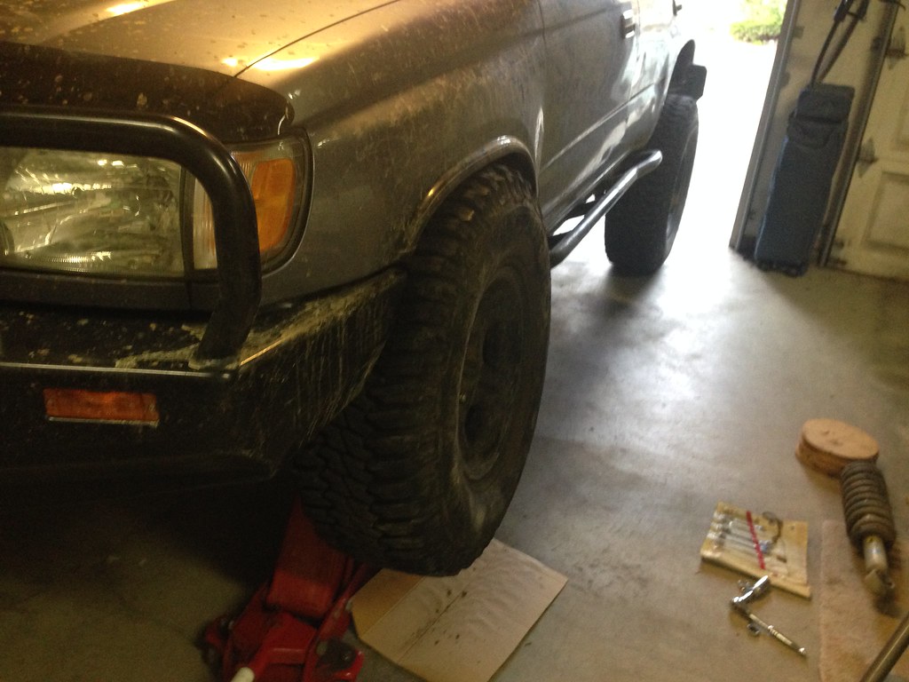

OJ, this is my setup, has been since 2009.
1. Cooper STT's 285/75 16
2. Wheels 4.5" backspace 0 offset, allows tire to clear UCA.
3. I have a Limited, removed bumper ltd flair trim piece, trimmed valance a wee bit.
4. Tundra spring & 5100 set on second perch 2.5" lift, rear LC 8 wrap springs.
Has never rubbed anywhere, I removed running boards like we all do.
If your running OE rims disreguard this, thats a whole different can of worms.
I did my research before buying wheels, the trick is the backspace and offset.
If I'm not mistaking Faulkens are made by Cooper, Cooper's are very good tires that will last.
Faulken AT3's tread resembles that of the Cooper AT3's. I installed Cooper AT3's on my 01 in March, only have approx 4k miles
on them. Highway manners are very good, very quiet tire. As any AT not good in mud, Sand they do well, rock surfaces well also.
I air down to 23-25# range offroad.
Hope that helps!
It does and yes please do! Thank you.

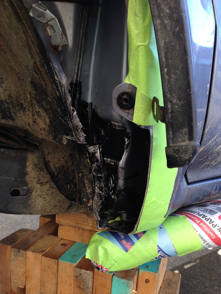

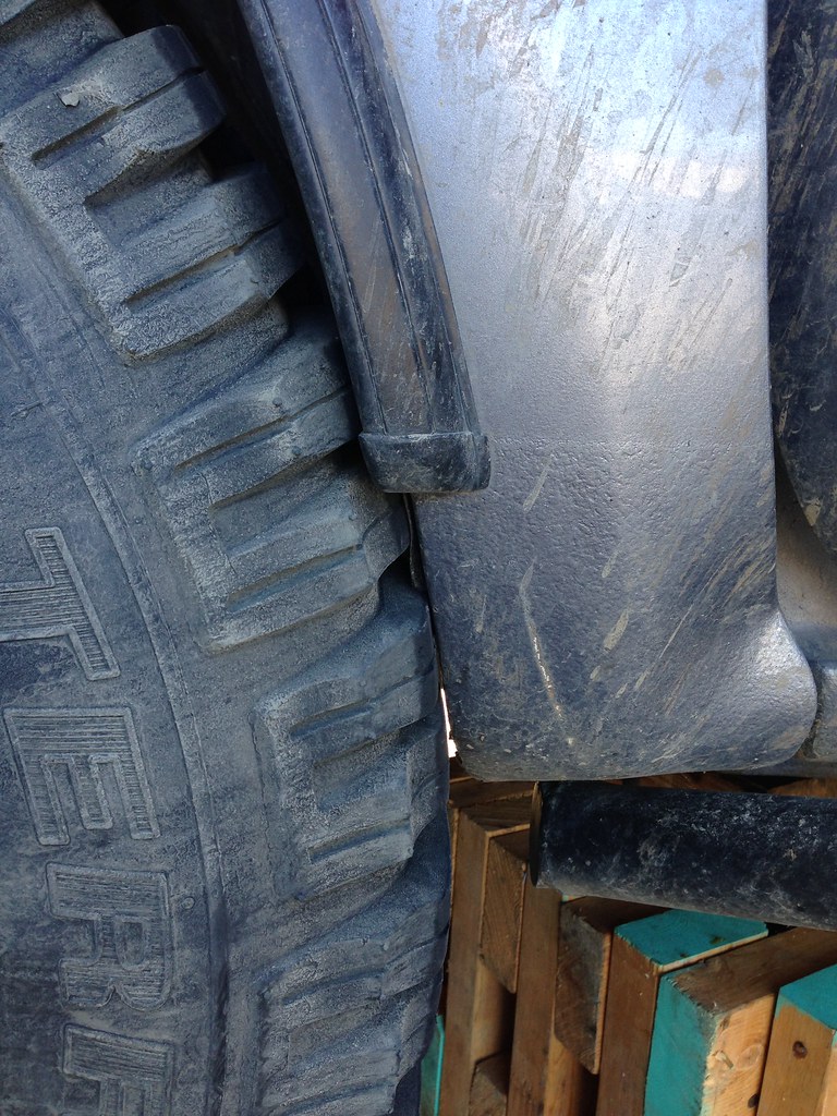

The best way to truly clear tires at full compression and full lock turning is to remove the strut, reinstall the wheel, and then jack the lower control arm until you are sitting against the bumpstop. This goes back to the often brought up fact that suspension lifts don't actually give you any more true tire clearance. Yes, you will rub less frequently with a higher static ride height from a lift. However, full compression is still full compression.
This is with LX450 wheels (8" wide 4.5" backspacing) with 1.25" wheel spacers. If you don't have wheel spacers, you probably will not have to trim the fender like I did.
IMG_2315 by Brandon Faliszewski, on Flickr
IMG_2331 by Brandon Faliszewski, on Flickr
IMG_2333 by Brandon Faliszewski, on Flickr
