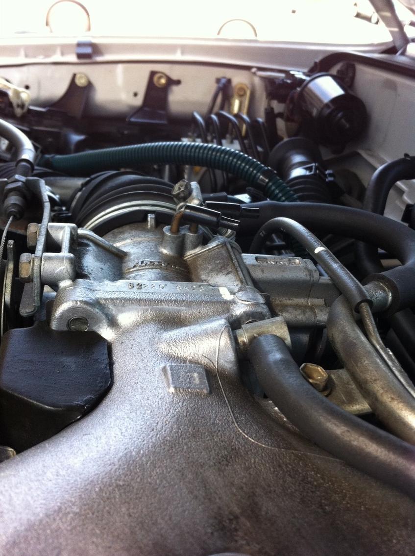

Any idea what the 2 ports on the manifold are for? They are plugged and I wonder if it is a mod of some sort?

The plugged ports are left over from a previous version (pre-OBDII) version of the V6 engine that used an EGR valve. Those ports connected the EGR. No 3G V6 4Runners in in the US use the EGR.
