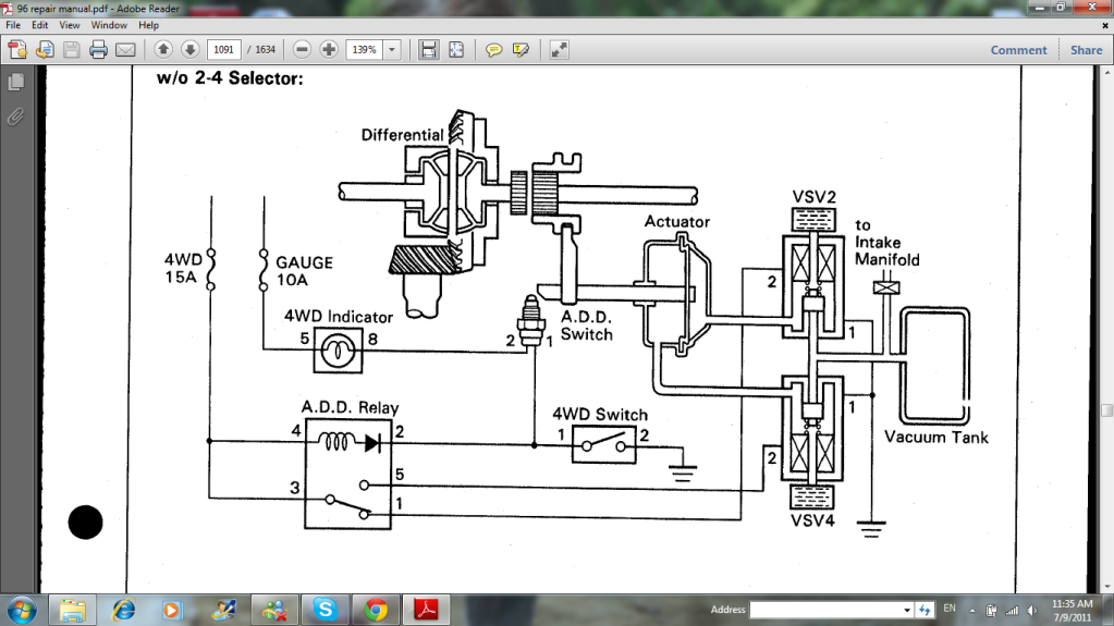

I desire to put my transfer case in low range without engaging my front axle. I do not wish to do a manual hub conversion, nor do I wish to install any sort of additional reduction gear or second transfer case.
Simple. Put in a manual switch at your VSV valves on the drivers fender. If you want to use 2 lo, flip the switch to disconnect the Electric to the VSV valves.
You can also interrupt the control at the relay. It is located under the passenger side kick panel.
It might cost you $10 for a switch and some wire.
I figured you could do this for those with full time lockers in the front end. For instance if i was in 4lo and turning and my front end starts binding i could manually disconnect the add, which in turn disconnects the passenger side cv from the diff, (not really the cv, but the stub shaft) So i could disconnect the add and then be in 3 wheel drive since the t-case is spinning the front output in 4 lo and the front aussie locker keeps the drivers side always turning.
I assume that the page you referenced is from the service manual, Singtoe?
Is it an actual relay or is it an internalized logic chip? All I see is a large wire bus coming out of the computer. (If its a booger to find out, don't bother spending too much time on this... I'm just trying to avoid chasing wires cuz its kinda a PITA when you are color blind).

Yes right from the FSM.
The relay is in the passenger side kick panel. No computerized logic chips. It looks just as the diagram. The Newer 4runners (01 and 02) don't use vacuum servos, the use electric actuator. They are hook up to a 4x4 ECU. So they will have the logic chip. Still easy to bypass. Just put a on/off switch at the actuator to prevent it from actuating- locking the A.D.D..

If you take the actuator off of the passenger tube, you can lock the actuator into being a "Manual" diff. Or just swap out the jack shaft.
