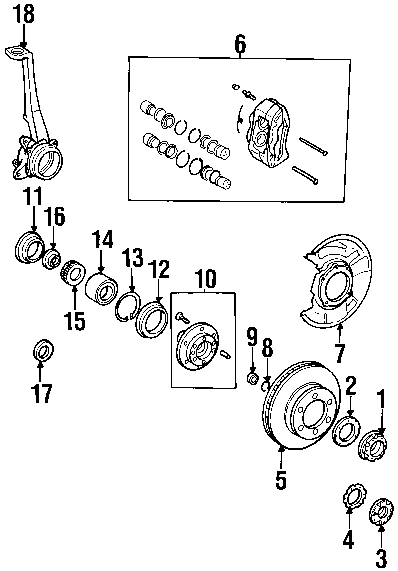

Ah I think I understand so the part for the Tacoma spindle would be #18 on this diagram?
No, that's what I'm calling the steering knuckle. You can reuse the 4runner part there.
It's part number 10 that needs to come from 1st gen tacoma along with the manual hub assembly (parts 1, 2, 3 & 4) and corresponding CV axles.
Be aware though if you order parts 1,2,3,4 & 10 from online yota parts place you will still need the studs, cone washers, lock washers and nuts for the manual hub base, as well as the bolts for the manual hub lever/cover. You also still have to source the bolt with washer that fits into the end of the cv axle. These items are not shown in your diagram.
This will work for the manual hub base and saves about $100 over ordering from yota online parts place. It's what I used. http://www.marlincrawler.com/axle/f...ardware/hardware-front-hilux/8mm-hub-stud-kit
Oh I understand, sorry for the confusion! Thank you for your help!
