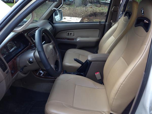

Might not appeal to you, but aftermkt seats are the route I took.
Shed 22 pounds also. After selling my factory seats, these cost like 300 to 350 bucks...
[MENTION=175921]TonyB66[/MENTION] Those look really nice. What brand, how was getting them mounted, lots of fab work or did they have a rail kit?

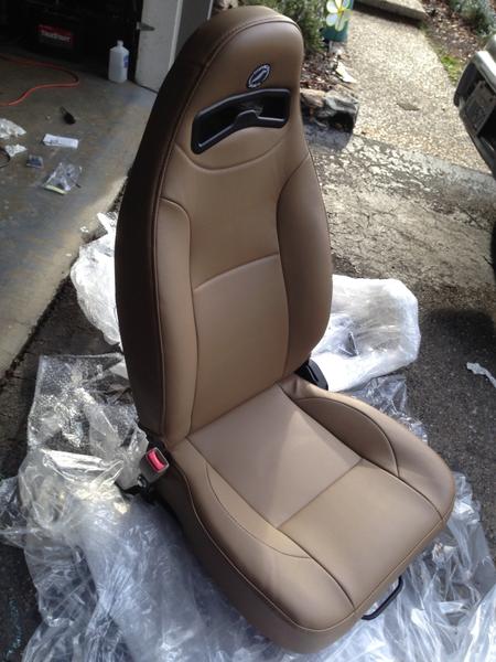

Corbeau Moab seats with their 3rd gen 4Runner base/track. No fab work per se. The brackets for the seatbelt receptacles were pushing up against the center console though, so I bent them outward a bit... They otherwise drop-in and bolt-up.
I've made use of the space under the seats too, another added plus...

Nice, is that the Tan or Spice color? Did you do any of the lumbar supports? How about seat height with the base/track? About the same?
Trying to prep for a long Baja trip (Baja XL, ~4000 miles in 10 days, not including transit to/from Seattle). Actually more worried about passenger comfort, you know happy wife, happy life...:thumb:
Searched my thread:
Front seats (Corbeau Moab, Spice, about 39 lbs per seat, compared to 50 lbs for stock)
As a caveat, I'm a pretty thin guy around at 145 lbs. And as far as the wife goes, I think we had two Tahoe trips (approx 4 hours each way) since the install. No complaints, FWIW.
