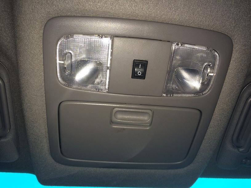

Did map light mod this weekend, now I have plenty light when door is open!
Taped into the wire from the dome light (IMHO it was easiest and closes to connect to); added the switch to the map light blank plastic cover, so just wanted to share:

I tapped just the A piller wire with a 3M in-line tap. Within the wire bundle is another bundle of three white wires. They are wide and bound side by side. The middle one is the wire you want to tap.
I just did this mod on my 04 Limited and tapped into the middle wire of the three white wires that run together like you said and it worked like a charm. Super easy mod!

Yes. That is what I did. You can't confuse which wires to tap into coming down the A pillar. You will have to cut some of the tape off of the bundle of wires. Then locate the 3 white wires all running together. Tap into the middle one.
