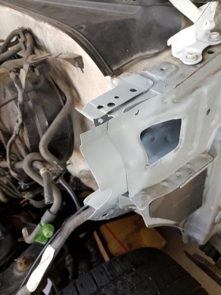

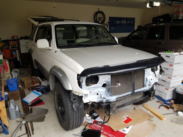

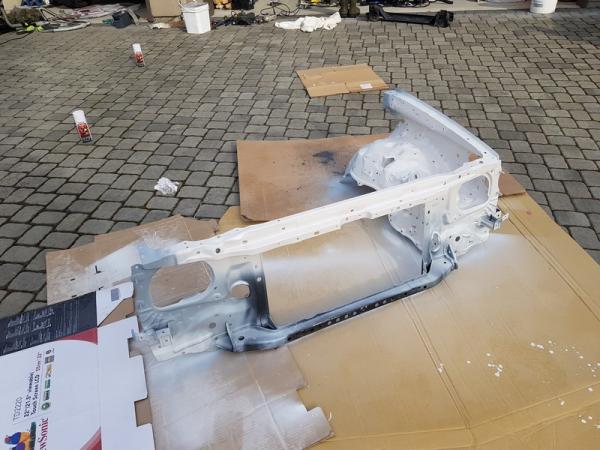

Last weekend I painted up the new piece. Underneath many areas I applied Eastwood weld-thru primer. I took off all the grey OEM primer where I was going to weld since I don't think it was weld-thru primer. It didn't weld properly on the test pieces. I used aircraft paint stripper and a wire wheel to remove it where welds were going.

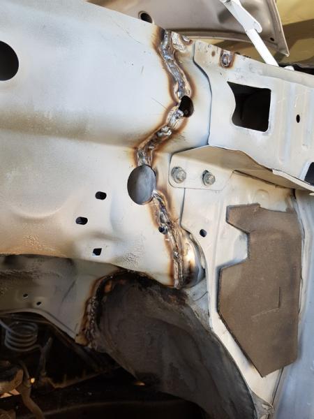

Here's what the connection over by the firewall / windshield looks like. It's a jigsaw puzzle in there with different sheets of metal going everywhere so I think I took the best approach by just cutting it and welding it on. I have to insert the new piece a couple inches into this.

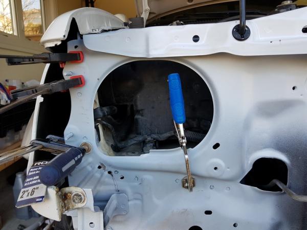

Yesterday I put it in for the last time with the Desert Dune OEM hood from my other 4runner so I can line it up with a hood that fits. I don't want to line it up with a Certifit ("sorta-fit") hood. The lines are surprisingly good, out by a millimeter maybe.
Here it is all clamped up and ready to go. It didn't fit perfectly but pretty good considering what this truck's been through. I used .023 wire I think (about the thinnest you can buy) with 75/25 Ar/CO2 mix on my Lincoln Electric MIGpac.

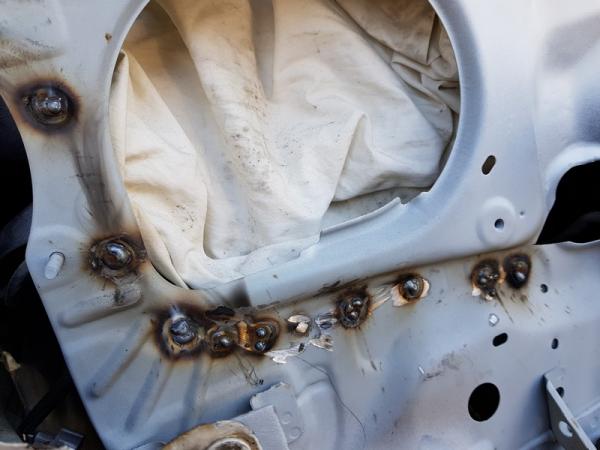

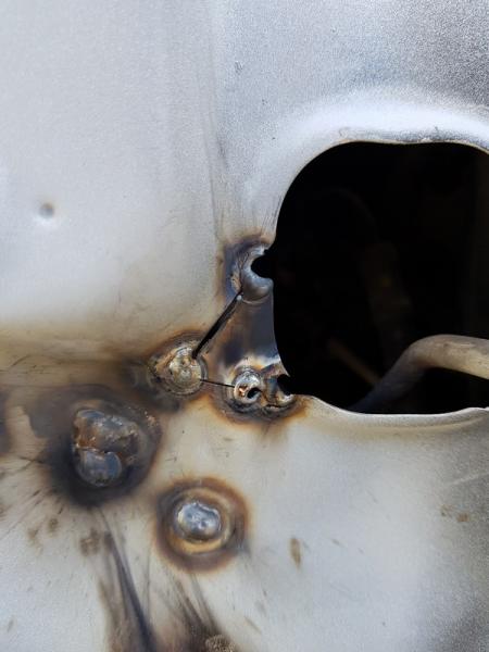

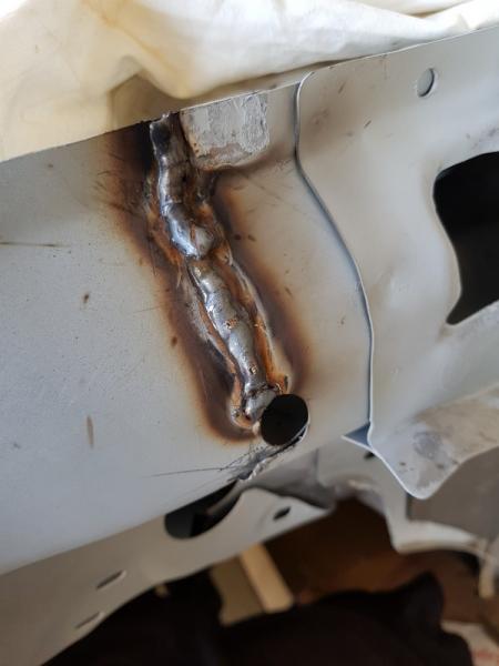

Here are my first welds on it. I was burning through a little bit so they aren't perfect welds as I sometimes had to chase the hole and end up with a blob. But they have good penetration and they hold. I added a few more than the original spot welds just to give it some extra strength.
Here is the little triangle I had to cut out of the A/C hole. I tacked it in 3 spots so now I'll just grind those smooth and fill in the rest with bondo.
Now onto the other side. This was the first line which was easier to weld than the spot welds. Sometimes I'd burn through and chase it which made a blob but overall the lines were pretty good.

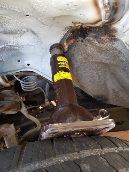

I used my bottle jack and scissor jack to push the new piece up against the old one.
All done (the welding at least...)
Finally made that milestone; THE PIECE IS IN!!!! Man this has been a lot of work so far. And I still have a lot more work to do:

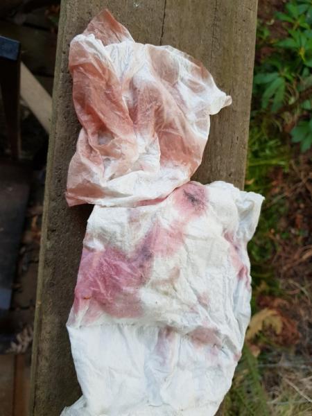

When the A/T fluid temp. sensor affixed to the transmission case detects that the fluid temp. is 150C (302F) or more, the
engine control module operates and the current flowing through the GAUGE fuse flows to the A/T oil temp. warning light to
TERMINAL OIL−W of the engine control module to GROUND, so that warning light lights up, informing that the A/T oil temp. is
high. When the A/T oil temp. drops to 120C (248F) or less, the engine control module stops operating and the warning light
goes out.
Here is what the transmission fluid looks like. It is the browner rag which is still pretty good and red. The brighter red rag is from fluid that I know is good.
So I'm confident I didn't damage the transmission but I'll do a full flush soon anyways. The fluid was about a half quart low due to filling the new trans cooler and hoses to it. A guy in a Jeep Cherokee stopped by and gave me some Dexron III which I added and now I'm a little overfilled.

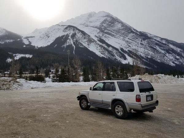

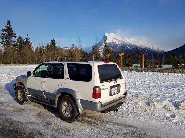

I did this last week / 2 weeks ago. I drove my rescued 2000 Limited to Calgary and back to Vancouver in the middle of winter weather. That's a couple thousand k's. Nice to have the part time 4WD transfer case. It performed flawlessly except a couple times while cruising at speed and overdrive on, when I started going up a slight hill and put on the gas a little bit, it seemed to get confused about shifting and clunked and made a hard shift. Popping it out of overdrive immediately stopped the problem by forcing a shift.
I slept one night in the back in the freezing cold and snow up a logging road. It plowed through 8" of snow that night. I was worried it might not start in the morning but it fired right up with 27 F reading on the Scanguage. I was warm in my sleeping bag, it didn't even get below freezing with the windows cracked open a bit.

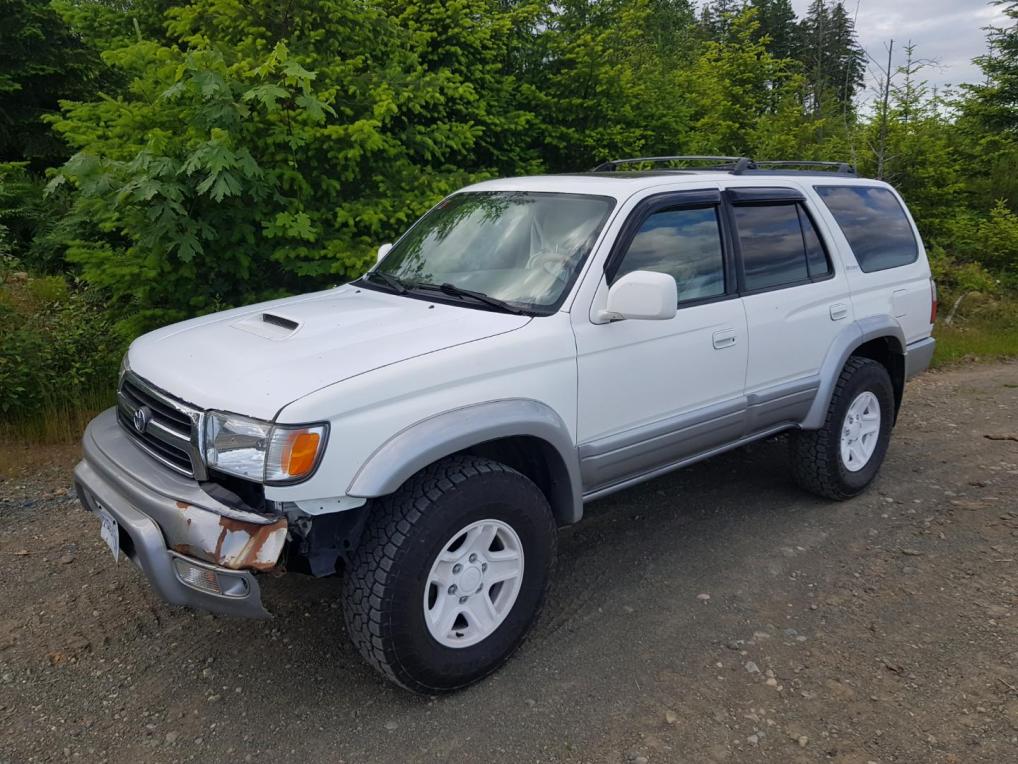

I previously replaced the front rotors with some from a 2002 from the wreckers. I took a chance that these ones wouldn't be warped and they aren't. Man this thing drives so smooth. Amazing considering what it looked like this time last year.
And I gave it a good spray underneath with Fluid Film first, as well as Rust Cure 3000 (linseed oil) in the doors and rocker panels since it doesn't stink as much -- come summer when it all heats up and volatilizes.
I'm really liking this 4runner and I'm going to turn it into my built rig. New front bumper from Coastal Offroad, winch, 33's without a lift so I'll have to trim the fenders. There's also still some more repair work to do from the crash -- crunched fuse box, and paint and replace the fender, re-install the AC system, some bent body mounts -- are the main ones. Plus fix the Limited climate controller, put in new airbags. It just goes on and on...
This 4runner has been my DD for a couple years now. The Leaf is better on gas but doesn't have the range or 4x4 capabilities...
I just did a couple thousand km trip up to NW BC including some great 4x4 trails. Performed flawlessly. This thing is really capable with the rear + centre locker and full time 4WD.
I put some OME 960's and Bilstein 5100's on the back. It is about an inch too high for my liking but it handles the weight in the back well.
Now I just need to weld together the Coastal Offroad bumper and put on a new white fender (I mangled the current one when a pine log got pulled up into the wheel well). Then it will start looking real nice.

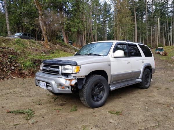

Finally replaced the fender with a white one. I actually had 2 beige ones, one with the limited flare and one SR5 that was on the car. I couldn't get around to painting the limited one until the weather warmed up and.... it's done. Not perfect, but not embarrassing anymore. Next is to weld up the Coastal Offroad bumper and this thing will really look nice. The white wheels look great.
I used Duplicolor Color Match rattle can paint. It doesn't match perfectly but pretty close. i also got some 2 part clear coat that I'll apply sometime later when the hood is painted the correct colour. I now have 4 different shades of white on this car -- the original paint, the hood, this latest fender, and the wheels. All different paint.
