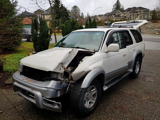

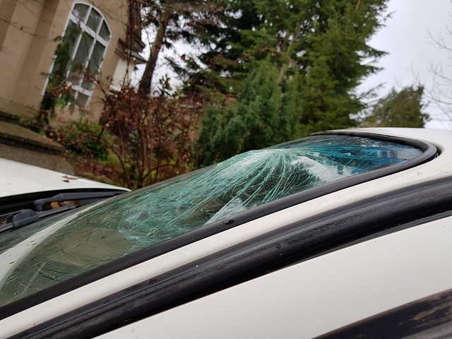

My friend wanted to get this truck for the nice leather seats and rear lights. I was going to go in it with him and part out the rest to make some cash. After looking at it I decided to bring it back to life. These things can go for $10,000 in good condition, which this one is, or rather could be. The features of this one are the e-locker, multi-mode transfer case and Limited trim. And best of all, it's rust free!!!! Well, relatively rust free. Rust free in Canada-speak. Everything worked at the time of the purchase except for the antenna.
It has clean title because the guy drove it drunk and hit a power pole so he didn't report it. That impact on the windshield is from his head because he wasn't wearing a seat belt. The damage (edit: I thought) is minor. It couldn't have hit in a better location, basically straight into the wheel. The frame rail is untouched (edit: actually, it buckled behind the LCA bracket).
I'm in it for $2000 plus a running tab. I'm sure I could sell it for a profit (edit: not much) but I might keep it as my second rig.

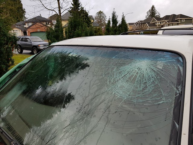

  • Windshield -- $465 CDN

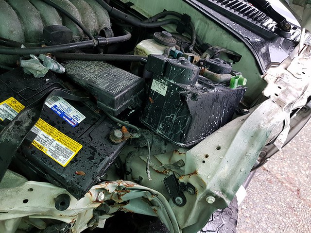

  • I'll need to cut out and install a new battery tray from a 99+ model as those have the airbag sensor mount

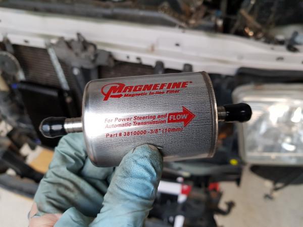

Mount K&M transmission cooler bypass from radiator -- DONE but I want to mount it on top under the hood scoop at some point.
Inline tranny fluid filter downstream of cooler -- DONE

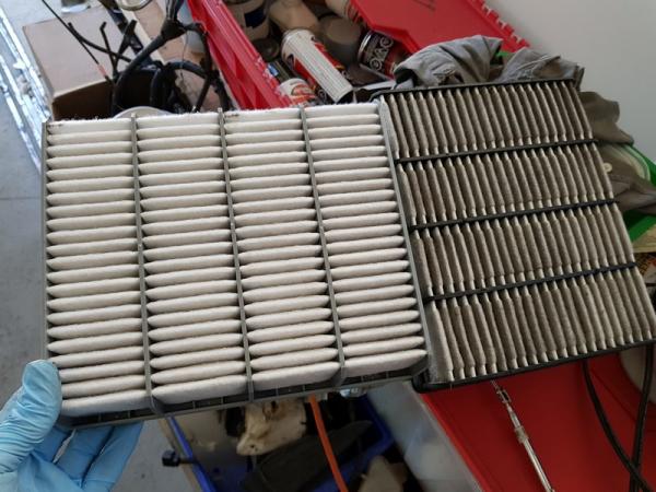

New air filter

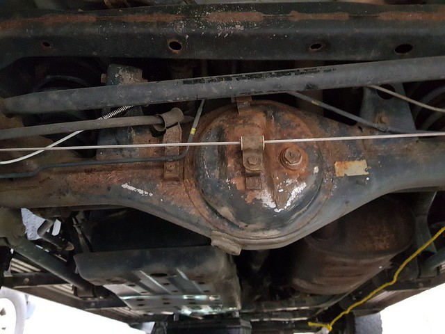

Remove rust from rear axle and paint

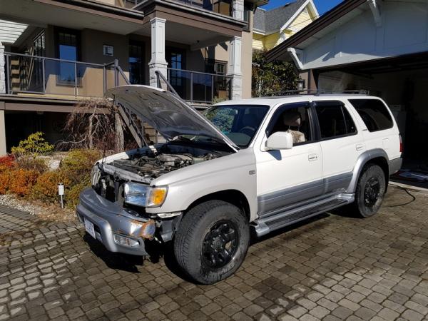

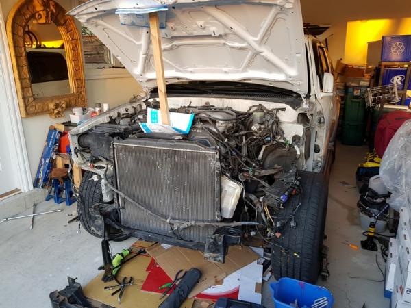

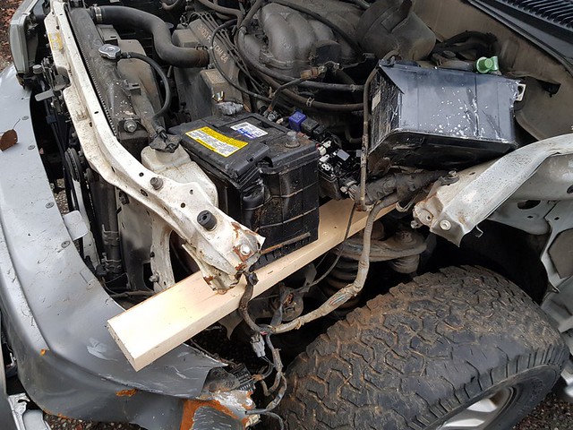

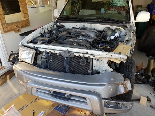

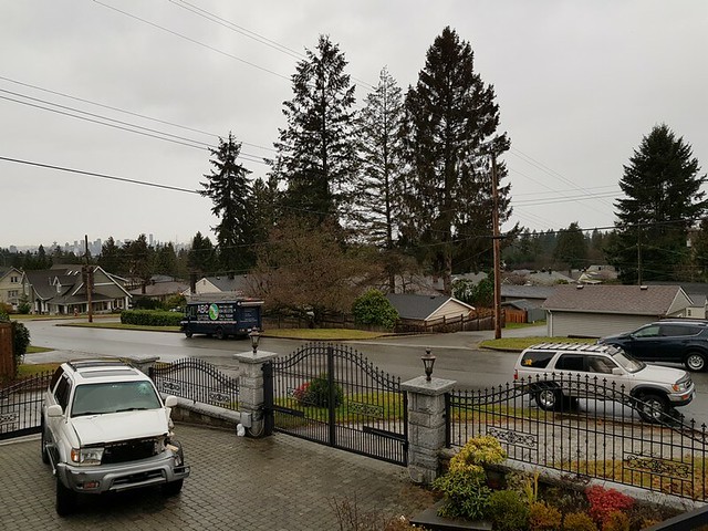

So I worked on it in my friend's driveway for a few days in the rain under tarps held up between the two antennas of the 4runners, a kayak paddle, and a light fixture on the house. I needed to get it moving on its own power so I could get it in my driveway and garage because there's no way to get it in there.

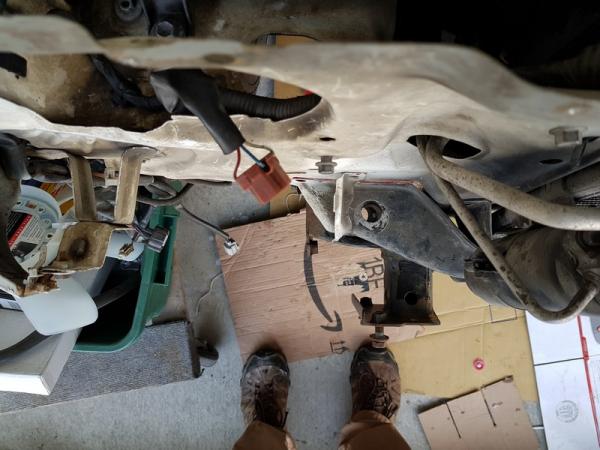

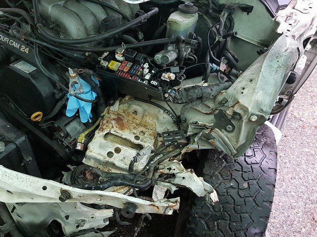

I spent a day cutting off the smunched up metal. They call it a crumple zone for a reason.

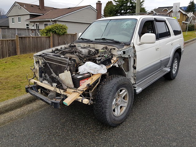

Then I freed the engine. One of the radiator fan blades was broken off so I had to remove the fan and just go without it, which isn't a problem since it won't be on for more than a few minutes. You'll notice that a blue glove appears in the next photo. This is from when I lifted the battery out and the lower lip grabbed the oil fill cap and broke it off... so I put a glove and rubber band on it to keep debris out.
I rigged up a wooden plank for the battery to sit on.

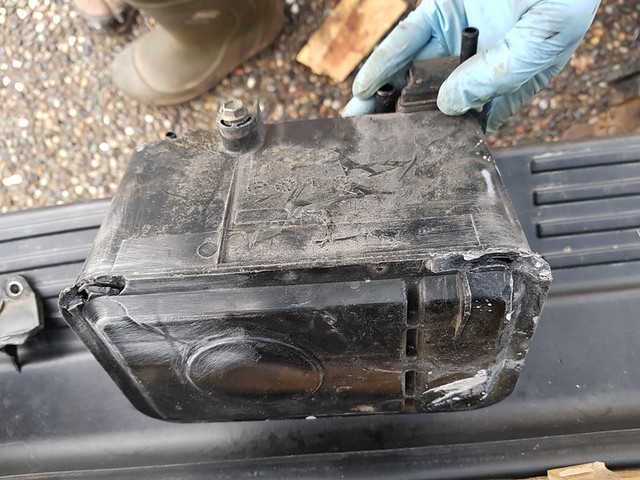

I also had to bondo up the charcoal canister since the mounting tabs broke off and this broke the housing so it wouldn't hold a vacuum.

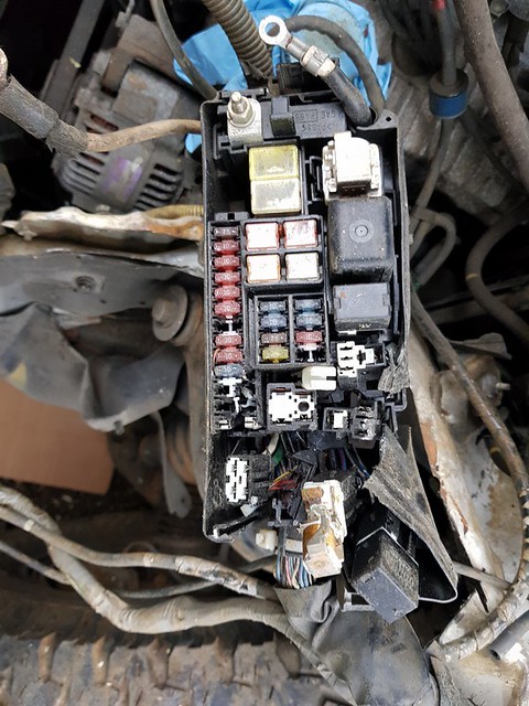

The engine would turn over but not fire. The fuel pump fuse and relay were destroyed... that would do it. Good thing since it killed the engine on impact.
Then it was time... it fired right up!!! IT'S ALIVE!!!! And no codes!!!
I then got it towed to my house which wasn't cheap. Managed to drive it into the garage with the limited turning radius of the bent suspension.

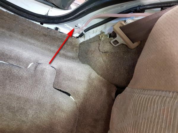

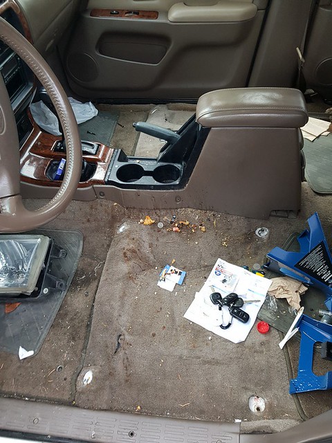

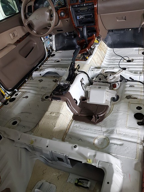

The first thing to do was clean the carpet since it was disgusting. I took that out and hosed it for hours. There must have been a full coke drink dried up in it.
I discovered some holes drilled though the floor under the seats for some amp or something so I had to clean those out to make sure they weren't rusting and then bondo them up.

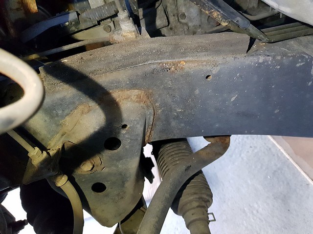

This thing is "rust free", up here in Canada. Seriously though, this is the most rust on the truck. 5 minutes with a flathead and hammer removed most of it then I sprayed with WD40 for protection. So nice to work on a truck where you can just turn bolts... that's why I decided to save it, since it's in such good shape other than some minor fixable issues.
I did notice that the coolant lines to the rear heaters were rusting out so I cut them off and welded shut. That's great, now I can be sure that it didn't overheat from coolant loss. :thumb:

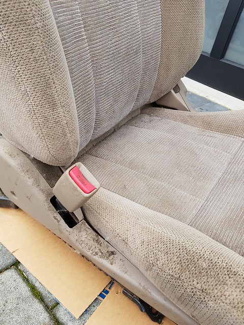

I picked up a set of cloth seats from the wreckers the other day since my friend took the leather seats. They have mildew and are a bit rusty underneath but otherwise in near perfect shape. I don't really care about the leather Limited seats. If I ever want to sell this thing for top dollar I can take the leather seats out of my mom's 97 Limited.

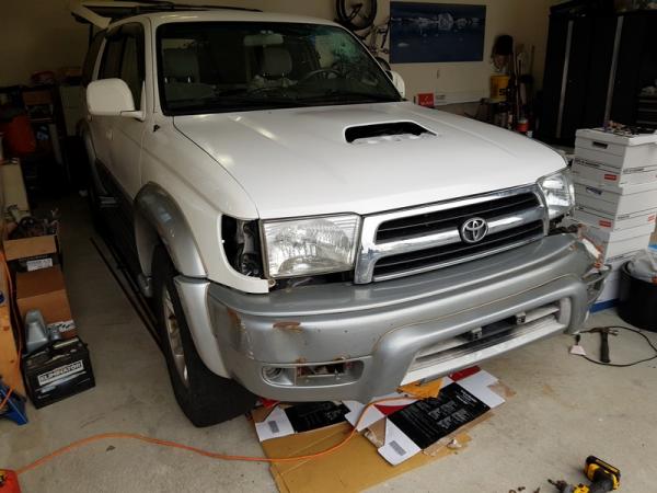

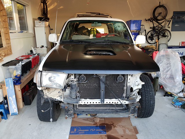

Today I made good progress on Snowy. Took off the old bent up hood and put on a new one from Certifit. It seems to fit well. But you can really tell the metal is thinner. I took off the ugly fat lip bumper which looked even worse mangled up. Look what good shape she is in under there! Frame is untouched except for the lower control arm bracket.
But first I had to straighten some of the mangled metal underneath so the hood would fit. I used this jaw puller which is pretty cool. The harder you pull, the tighter it grips.

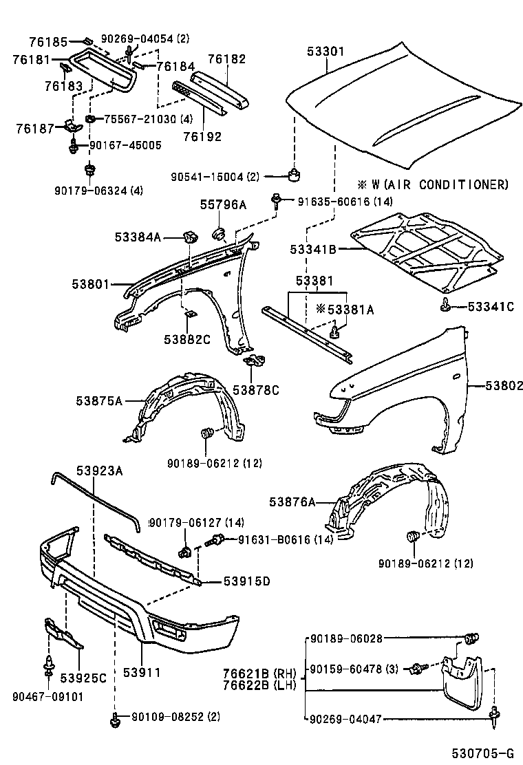

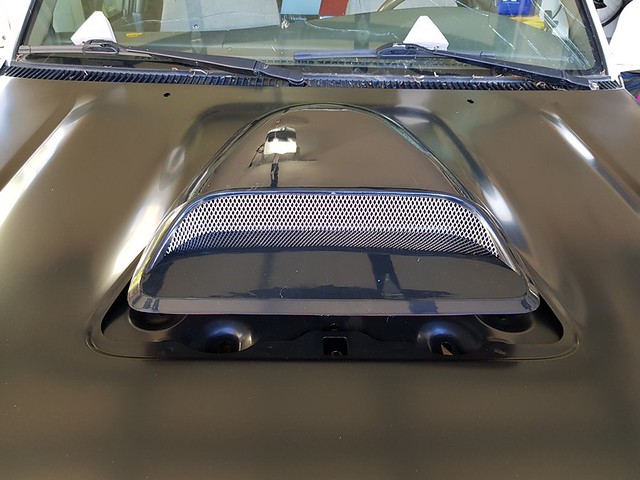

And I test fit the hood scoop. Ummmm, doesn't look like it fits. Can anyone please measure theirs, the widest part at the front? The scoop is 14" wide and the hood section for it is 17". Hopefully it's the hood scoop that's wrong. Oh well, it was only $20. I got it on Ebay here. Any insight anyone?
This is turning into an awesome thread with a ton of progress so far, props to ya, OP! A little insight on the hood scoop:
You are going to need a few things to match the opening in the 3rd gen hood, OEM or aftermarket. Unfortunately you might be looking at spending close to $150 for these parts below!
53301-35170 Hood Sub-Assy, Sport Hood ($325.29) (which you have already)
76181-35901 Bulge Hood ($114.15)
76192-35010 Plate, Hood Bulge ($13.20)
76182-35020 Guide, Hood Air ($13.58)
90263-04054 Rivet ($0.57) X 2
90167-45005 Screw, Pan Tappin ($0.72)
76183-12030 Protector, Hood ($0.71)
90179-06324 Nut ($2.20) X4
76187-35010 Retainer, Hood ($0.89)
76184-12020 Protector, Hood ($0.71) Don't Buy
76185-35010 Protector, Hood ($7.00) Don't Buy
from this thread here
Hope this helps man. Keep up the revival pics!

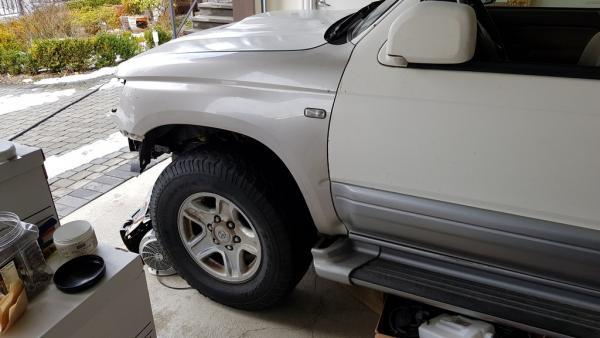

I've been making progress. It's been a couple weeks' work now.
The seats turned out pretty good but there's still a few black mold stains. Not sure how to remove those, I guess I'll have to remove the seat fabric which I don't how to do yet. Later.

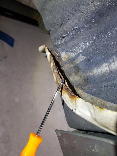

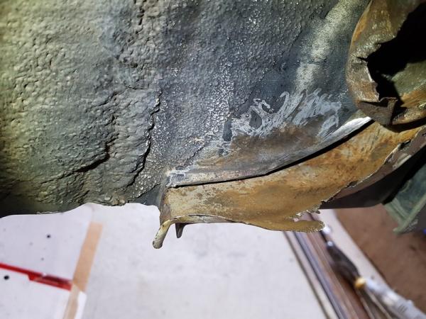

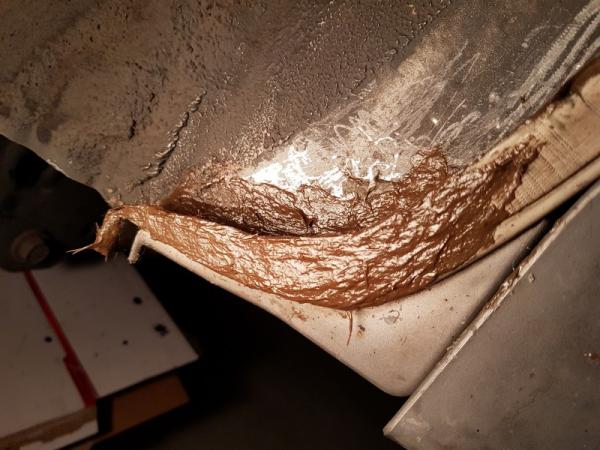

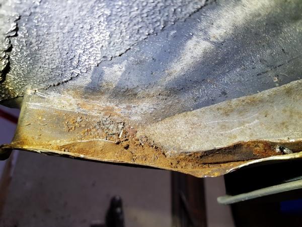

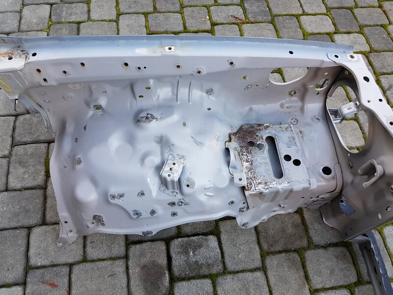

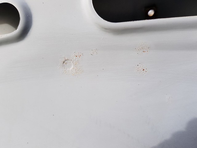

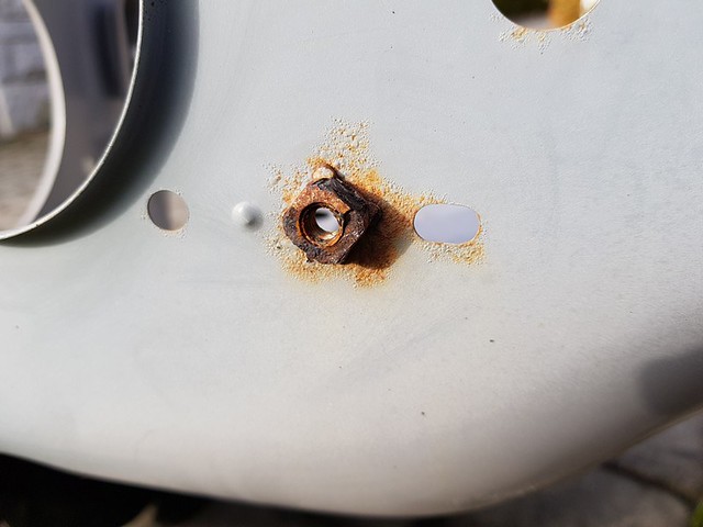

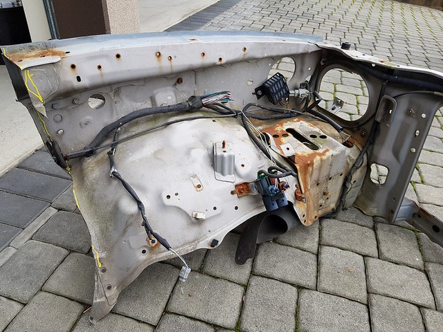

The new piece has some rust.
And those really annoying travelling rust bubbles. I looked on the truck which is pretty rust free and it also has them. Seems like it's from poor paint.
I removed most of it and I'll paint it up. Nothing deep, except for the battery tray which has heavier rust. I'll use rust encapsulator on that first and maybe eventually just swap it out with a clean one. It would have been nice to search around for a nicer donor piece but I had limited time and this one will do.

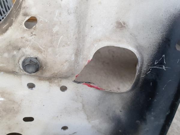

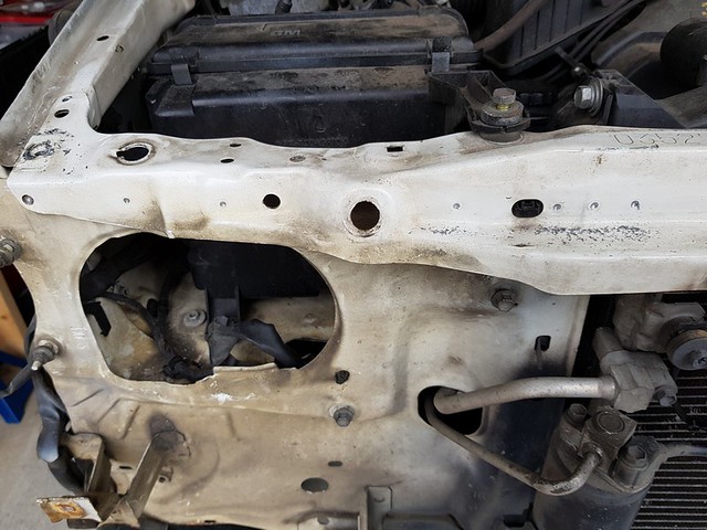

I removed the upper core support using the spot weld removal drill bit. Out of the 9 spot welds, I drilled through 2 completely by accident.
You can see in the above photo the lines to the A/C condenser going through the front piece. I'd rather not have to dismantle the A/C to replace that piece but it is a little bit damaged form a previous accident. Not sure what I'll do.

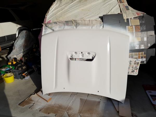

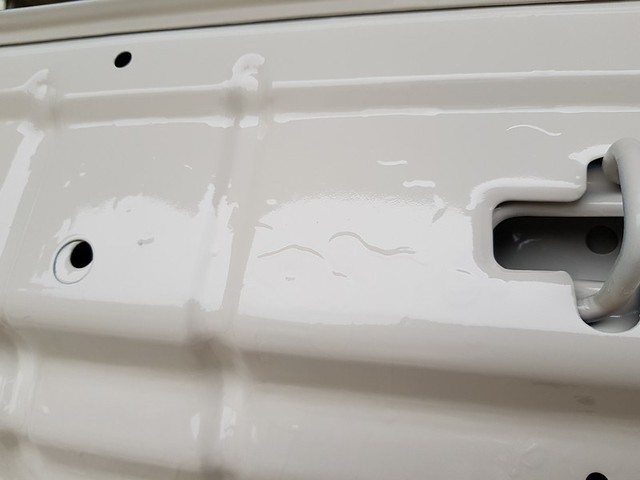

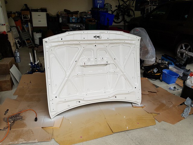

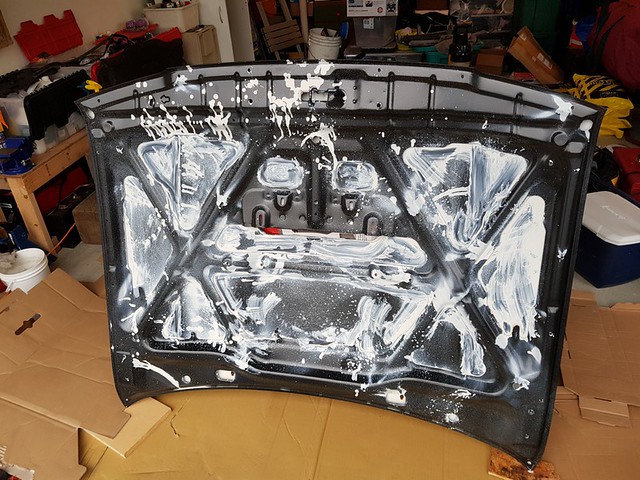

I painted the underside of the Certifit hood. I wanted to spray in all the recessed areas so I used the spray hose that comes with the Eastwood frame coating paint. Well that really sprayed out excessive amounts so it was pooling everywhere. And it seems Certifit put some brown substance in there so I was getting brownish paint dripping out. But is seemed to dry OK.
Good from far.
But far from good. LOL this is the worst paint job. Whatever, I just need to get this thing painted and the underside of the hood isn't a critical area. For a $100 hood I'm not going to sweat it. In the summer I'll sand it down and give it a few more coats. I'll paint the top side tomorrow which is a flat surface so I'll do a much better job.
I used Rustoleum Automotive White Gloss paint which is an exact match. I thought there was multiple shades of white but this one is bang on. I tested it on the old hood and you have to know where I sprayed to see it. Then in the summer maybe I'll clearcoat it.

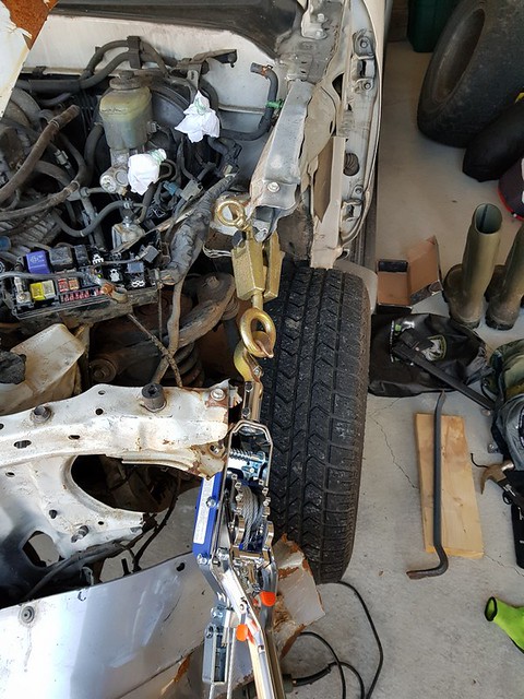

I noticed that the frame actually had some buckling and was skew. I'm not sure how I missed that buckling before.
So after I put it back together with 2x4's I had it towed to the frame shop. It's amazing what those guys can do. He heats it up and the buckle just pulls right back out like new. The wheel sits about 1/2" back compared to the passenger side which is probably due to some bent suspension components; he thinks the upper control arm. But for now it works.
I would have driven it home bit I think a police man would have given me a ticket...

I dug into the wiring and lights and managed to piece together a complete set for the front with the donor pieces and some 99 headlights I had bought previously. The only thing I am missing now is the driver side turn signal on the bumper which I have on order. I tested everything and they all work.

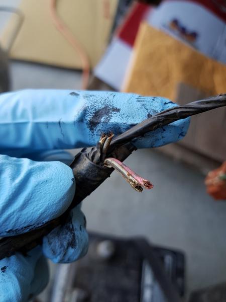

I then had to assess the damaged wire from the impact and decide what needed replacing and what could be just cleaned up. I can't leave any exposed wire since it will corrode and cause either a short or a fault. I soldered up the new joints and tonight I coated them in Gardner Bender Liquid Tape.
This was the fog and turn signal wires
I painted the top side of the hood last week. It actually turned out well except for the dust that was getting stuck to it. I'll give it a sand in the summer with another coat and then clearcoat.

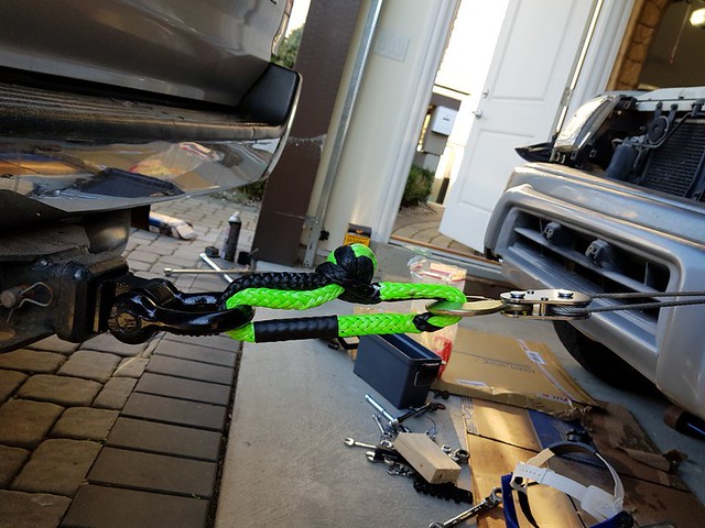

I used the port-a-power with the jaw to try to bend the bumper back into shape so it could go back on and be legal (is it illegal to drive without a bumper?) All good, for now at least until I decide what I'm doing for a new one.

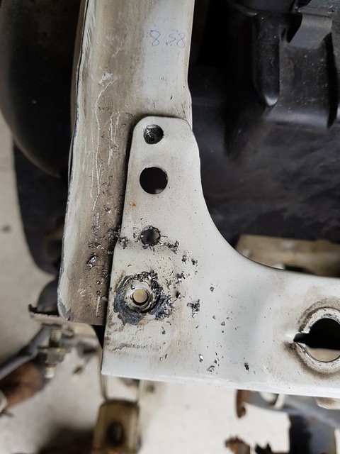

Back off it came today and I finished drilling out the spot welds to remove the front support.
Now the issue is that the front of the frame is offset to the side by 1/2" compared to the body so I need to take it back to the frame shop. But I can't afford another tow so I'll drive it over next week hopefully. I'll just use screws to hold the new front end together for that. You can see how the body mount hole doesn't line up here

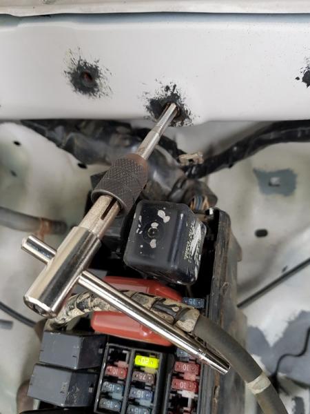

Had to chase all the threads on the donor piece since it had been outside for so long the threads were rusted up.
After taking these photos I discovered that the hood cable ball end wasn't in the latch anymore and I couldn't open the hood. So off came the bumper and grill again... which is OK since I still need to do the tranny cooler hoses tomorrow.

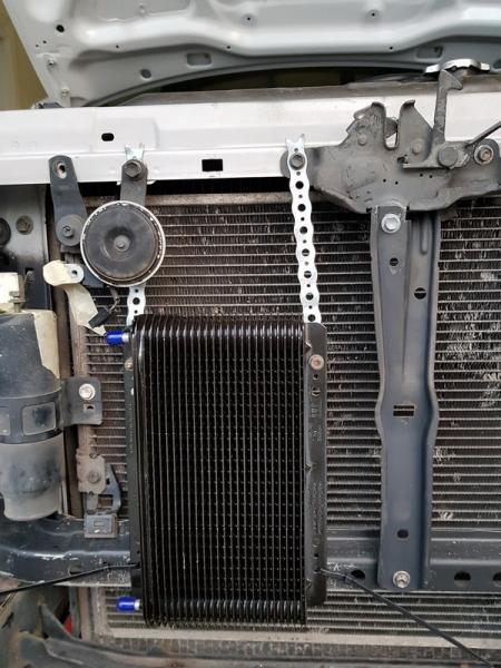

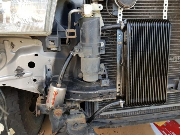

Mark_BC's ghetto tranny cooler mount job with plumbers tape and zip ties. Just temporary though since the whole front end will be coming off again to get properly painted and welded in.
Plan for tomorrow is to insure it, hook up the tranny cooler lines, put in the lights and some other electrical stuff, then turn the key.
This is how I routed the hoses for the tranny cooler. Not perfect but the hose supplied with the cooler was more than enough and at this stage, cost is something I need to keep down so I can save buying more hose, for now. Eventually I want to mount it over the engine with a fan, below the hood scoop.

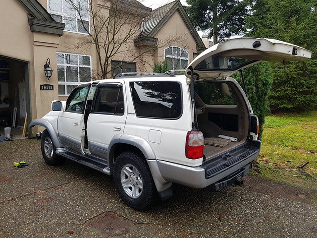

She rides again!!! Got it all finished up to be legal to drive. Look at the license plate I got -- HG3... I hope that doesn't mean head gasket #3 'cause it looks like I blew the HG on my other 2 runners.
No problem with the drive around the block a few times. Everything works although I haven't tried the sunroof yet. There's still a lot of work to do, big stuff like welding and painting the new piece, and lots of little things.
just a suggestion but while you got access to this location, cut a small 3" section of half inch hose, split it along the middle and make a grommet to protect the AC aluminium hoses passing through the front ..
i did this on my truck which was in a front end hit. It adds protection to the tubes and prevents fretting on the pipe due to contact caused by vibration or any bending not noticed from the collision.
Yeah I was wondering about that. I actually had to cut a notch out to get the new front to fit over the A/C line. One line was removable but the other one looks like it goes into the firewall and I'm not screwing around with that. I'll have to weld the notch back in when I'm done.
Got the windshield replaced a few weeks ago. I drove it down in the dry weather between rain and snow. Don't want to get any road salt or moisture in the open pinch welds.
Then I drove it to the frame shop across town and it had no issues; a pleasure to drive despite the front not being held on... in a previous post I showed that the front body mount holes were off by 1/2". The guy had a look at it and confirmed that the frame was bang on. So it must be the body that was out. But all the fender, doors and hood lined up fine so the body wasn't bent. But what he discovered is that the whole body shifted on all the mounts to be off-kilter. So he loosened all the body mounts and pulled the body back into position and it fits now.
Back in the garage I decided to do some repair of the few rust spots before they get wet.
Yuk
Ugly. This is such a common rust area for 4runners. If you get one little nick on the paint there between the two layers of metal the moisture and crap then just seeps in and starts rusting.
I found you can access inside the rear most rocker panel from this hole when you take the trim off the C panel. I put my snake camera in there to have a look and there wasn't much rust.
Basically the two metal sheets come together there so I cut and peeled the upper layer back and cleaned all the rust out. The metal was still good underneath for the most part.
Then I blew it all out with compressed air and sprayed down with alcohol, then put the metal back and bondo'd it up. Then I sanded it and painted it white. I don't have a picture of anything beyond the bondo but I'm sure you get the idea.
I'll now spray some WD40 or Rust Cure 3000 in the rocker panel and that should be the end of it.
Put in a newish air filter.

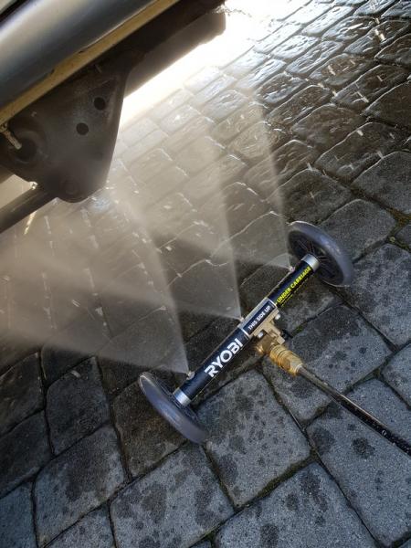

Today I gave her a bath. But only underneath since I don't want water running down the windshield into the spot welds. I got one of those pressure washer brooms. It actually works pretty well; super easy to get under and spray off all the salt. You can lift it up too if you need to get some different angles.
Then 2 hours later the whole front end was off again.
Tomorrow I'm going to do the final painting and prep of the donor piece and the areas on the truck to be welded. Then next weekend I'm finally going to weld it in. I have to do it next weekend because I need it to go on a trip the weekend after.
