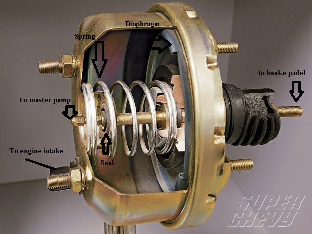

Between the master cylinder and the brake booster there is a strong rubber seal preventing atmospheric air to pass into the booster. There is no way you can get oil to pass into the brake booster. I have dealt with many cars with bad master cylinders and non of those had oil in the brake booster.
There is a big spring and a big diaphragm inside the booster. Diaphragm is attached to the brake pedal.
Don't worry about the booster. Do the master cylinder....

Thanks for the picture! I'm totally a visual minded person so that explained everything as far as the booster is concerned. As for Autozone, I'll consider it a lesson learned. Since I've already paid for the thing and they'll replace it, I'll go ahead and give them one more chance. If the new master cylinder is DOA as well then I'll get my money back and go to the dealership. Thanks.
