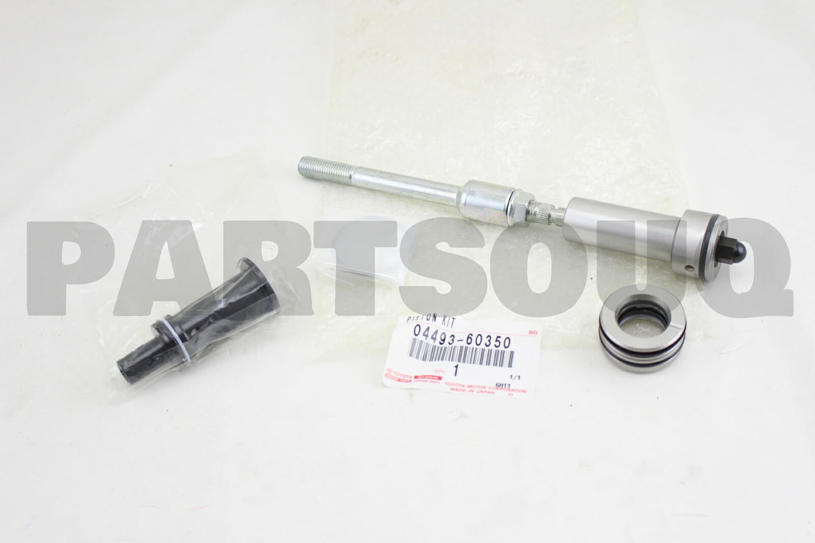

is this the part you bought??

Here's 2 different sources for the part/kit you should need, be sure to enter your year model. etc. to be sure they also fit your year model, these links do fit my 2004 model.
04493-60350 - Toyota Parts Deal)
Overhaul Kit - Toyota (04493-60350) | Toyota Parts
