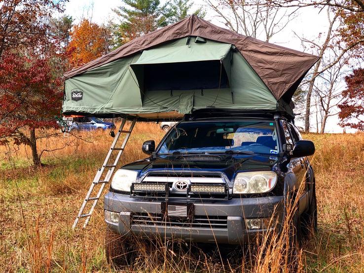

Current:
Always been a fan of camping, doing some winter car camping while Jenny was all stock.

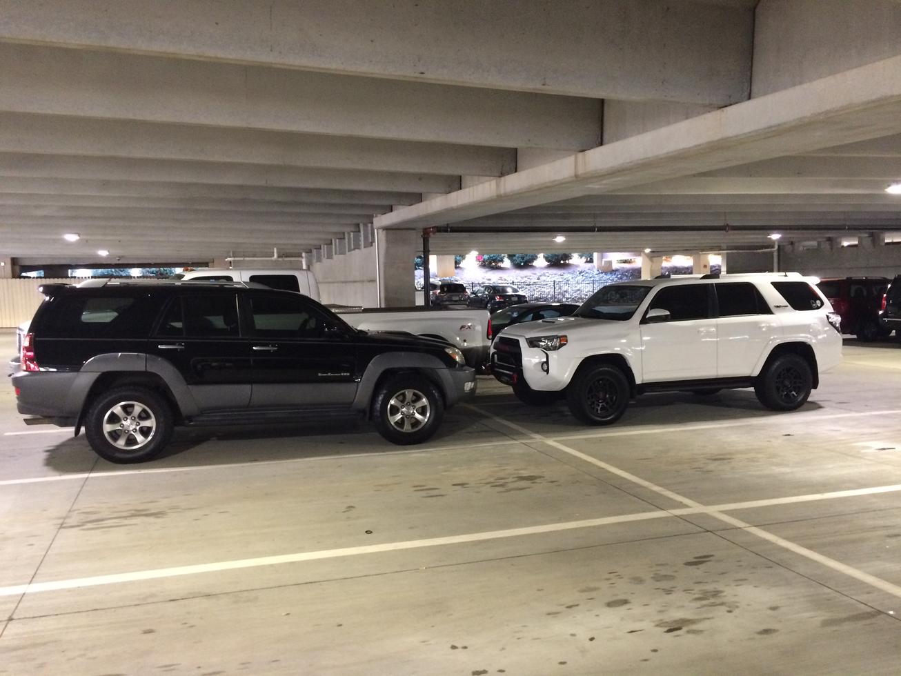

Jenny's stock suspension compared to a newer TRD Pro...had me researching a lift ASAP.

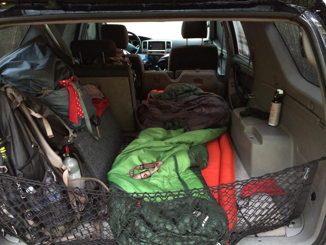

But first, one more camping trip with friends, turning the back into a sleeping platform...worked great and kept me dry!

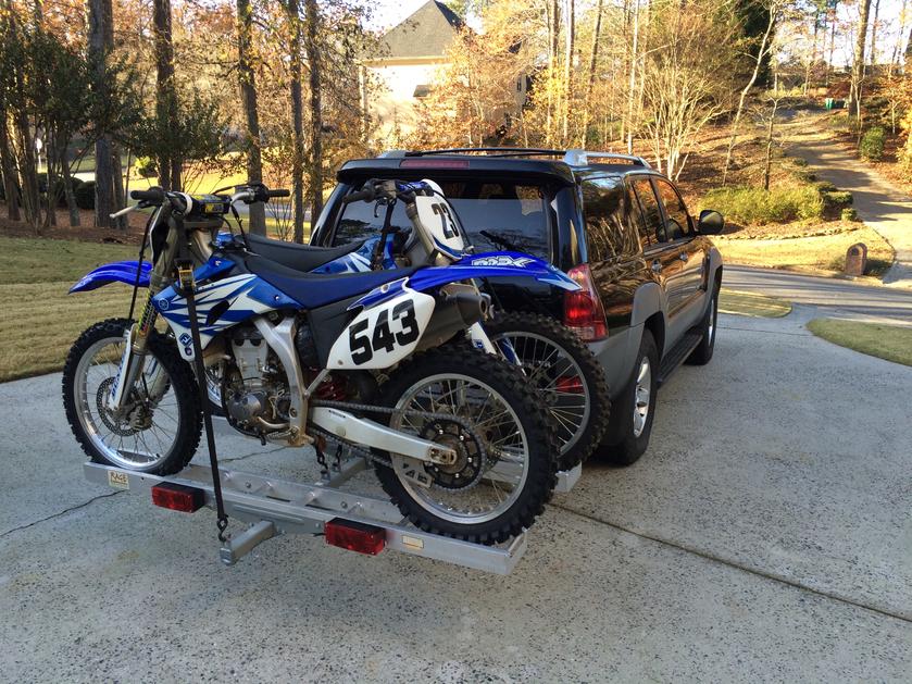

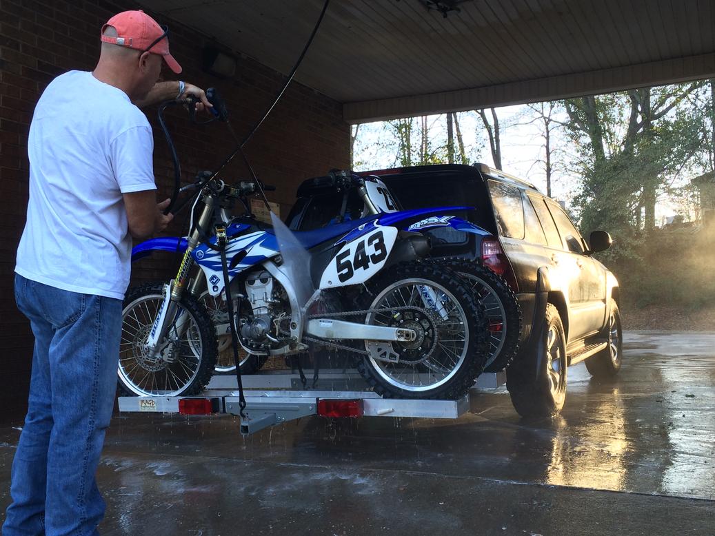

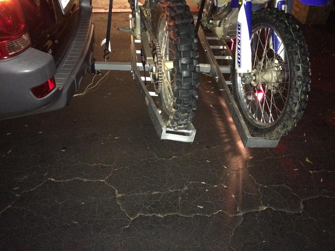

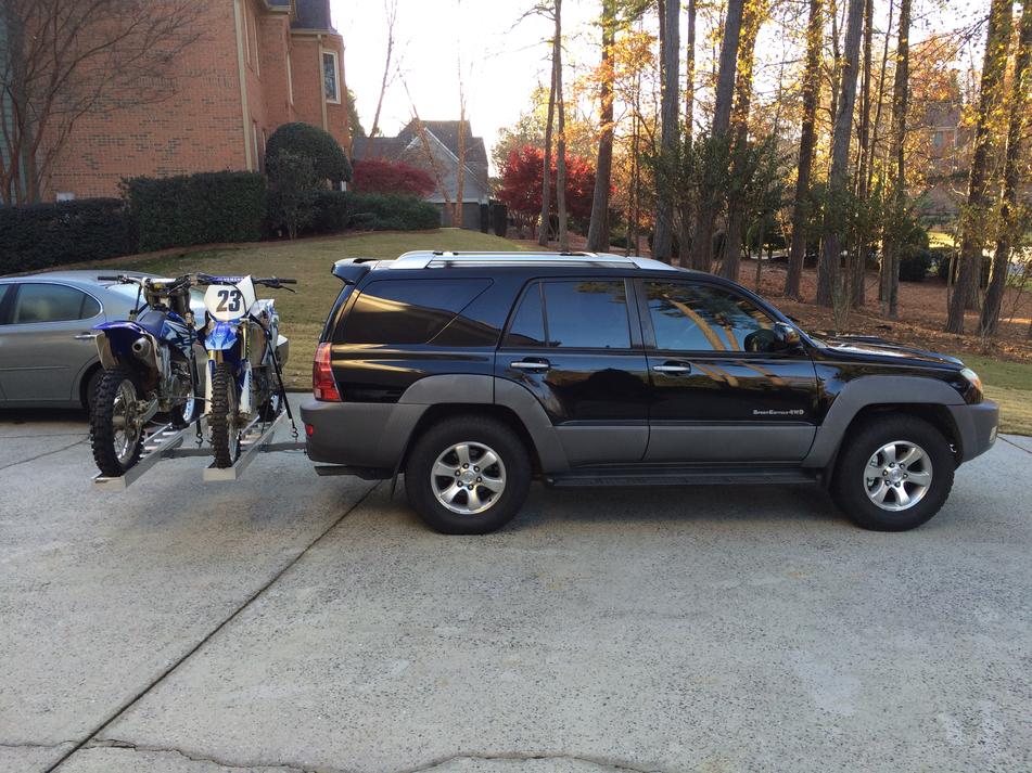

Since I ride YZ's with my dad, picked up an aluminum double dirt bike carrier off Craigslist for a swinging deal. Just plugs right into the stock hitch which supports the tongue weight since the bikes don't weigh much. Had a blast riding and actually rode pretty well. You can definitely tell she's riding low in the back on the stock suspension.

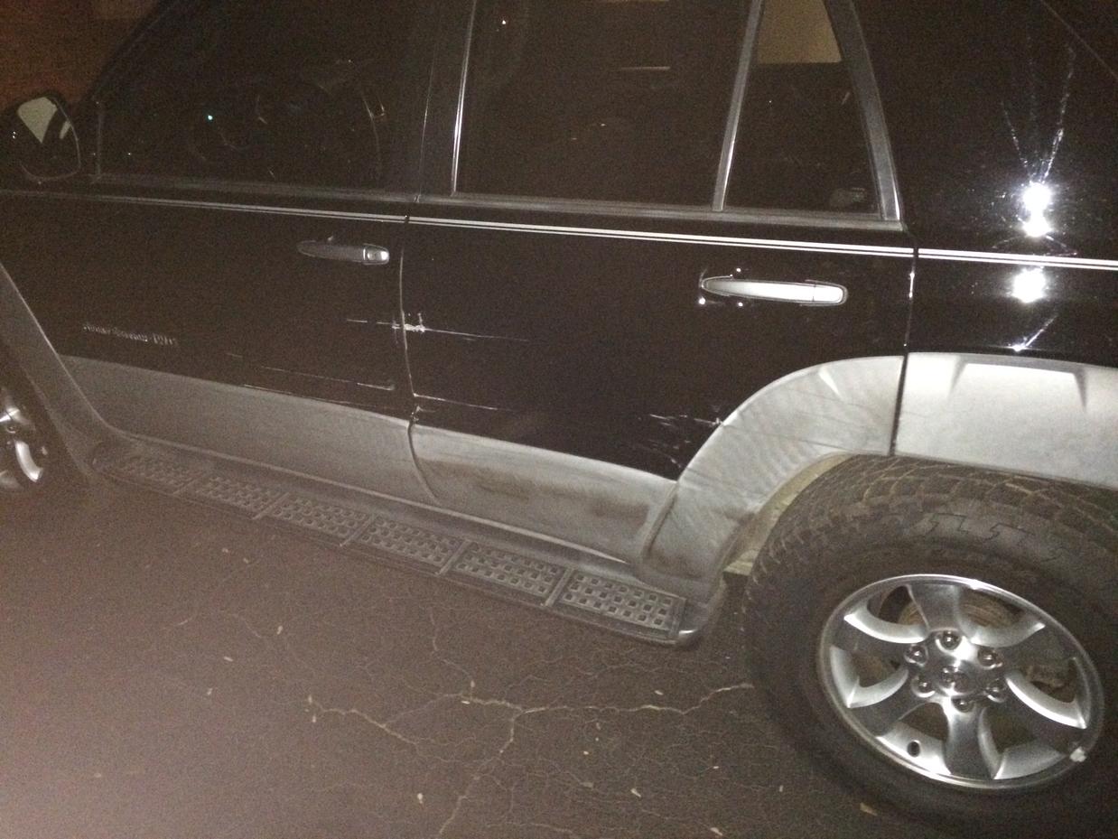

Coming home from riding a guy in a turn lane decided he didn't want to turn any more and turned right into me as I was passing straight by him...wrecked the hitch carrier (bikes are ok) and dented/damaged my right side. Silver lining was that the running board actually saved Jenny from getting damaged worse.

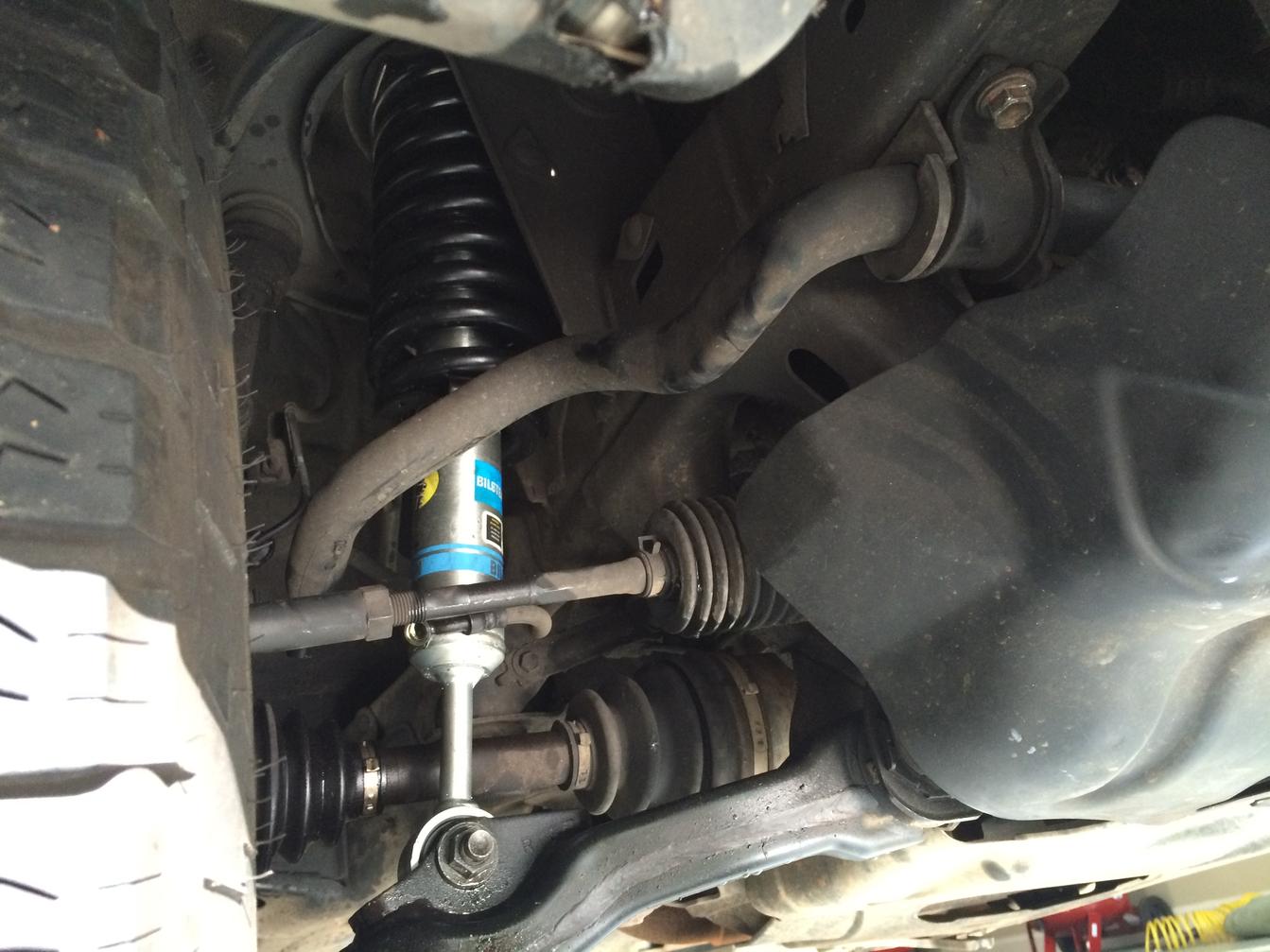

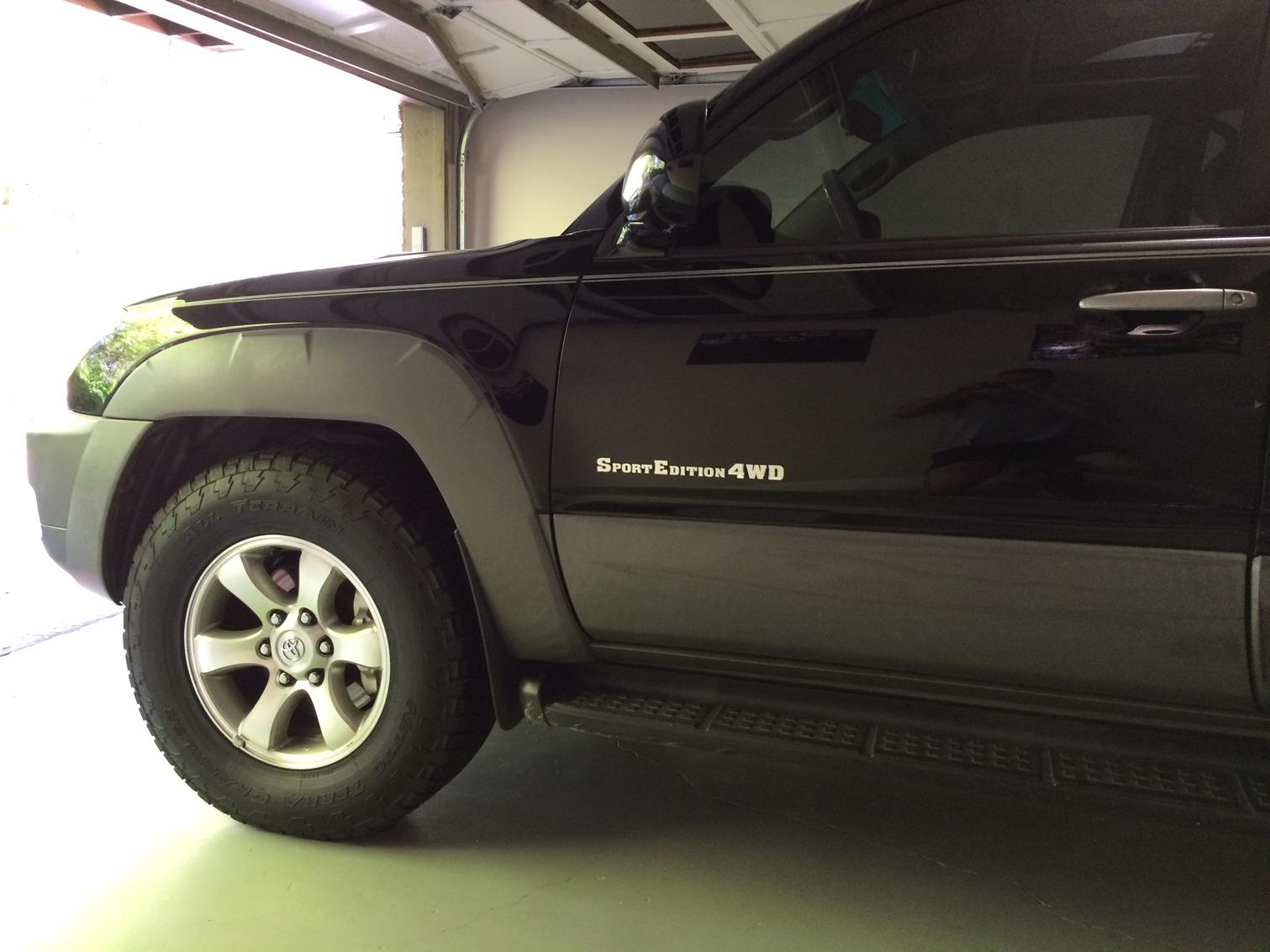

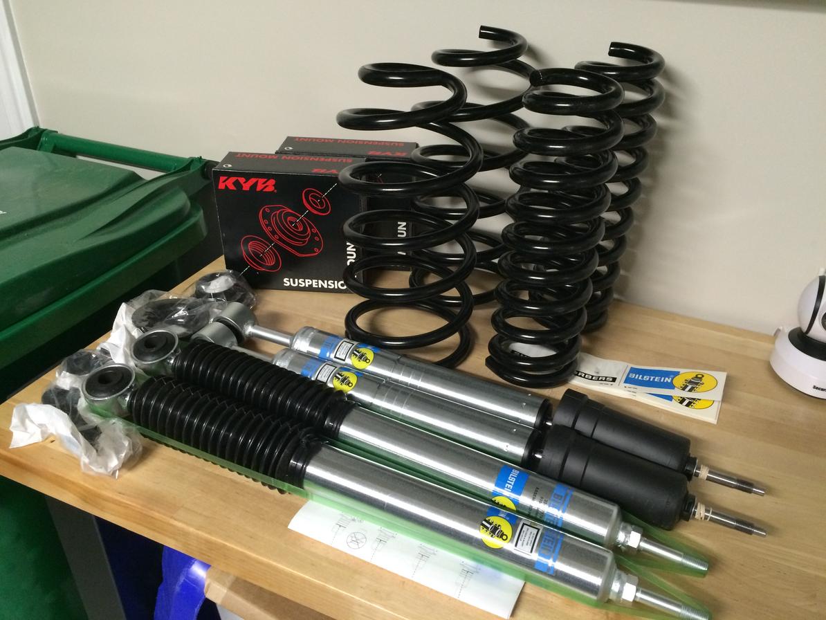

After considerable research, ordered Bilstein 5100s (set at 1.75 setting) with Moog Coils all around. Stoked to get this on and let Jenny stretch her legs!

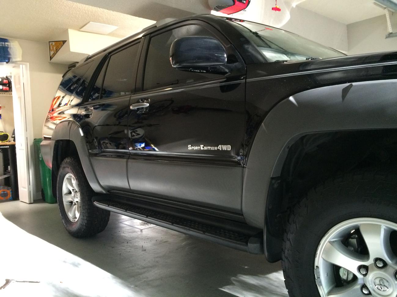

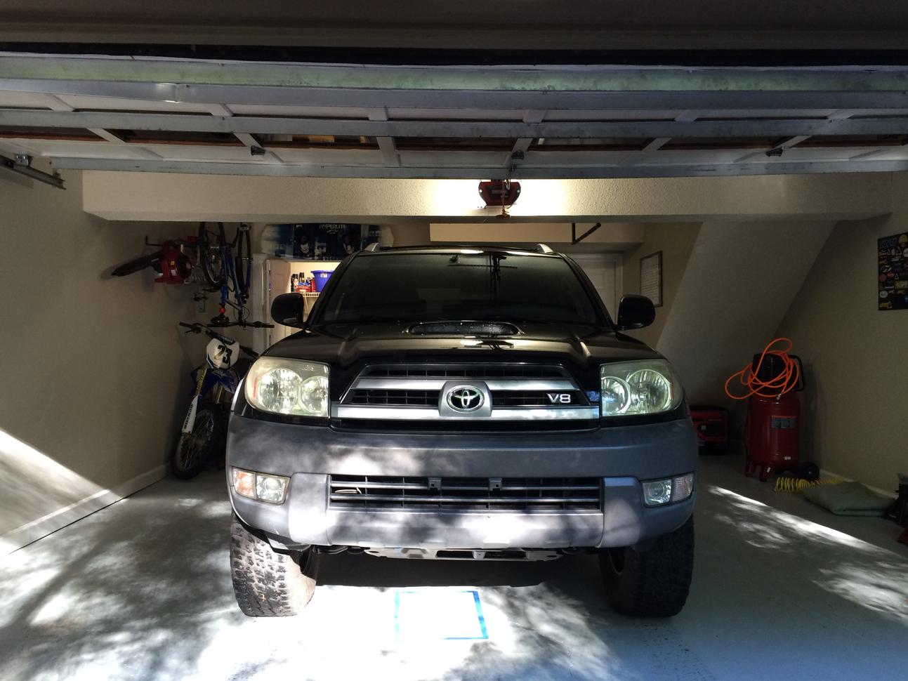

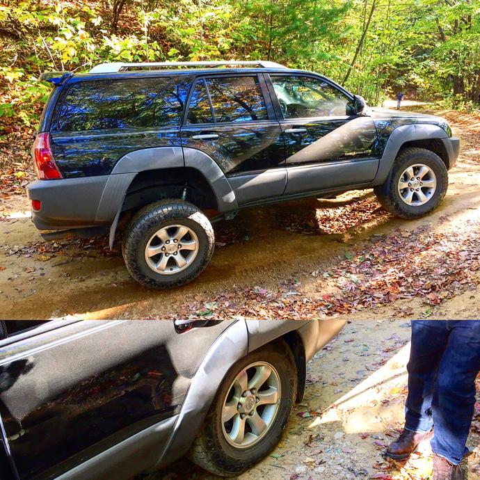

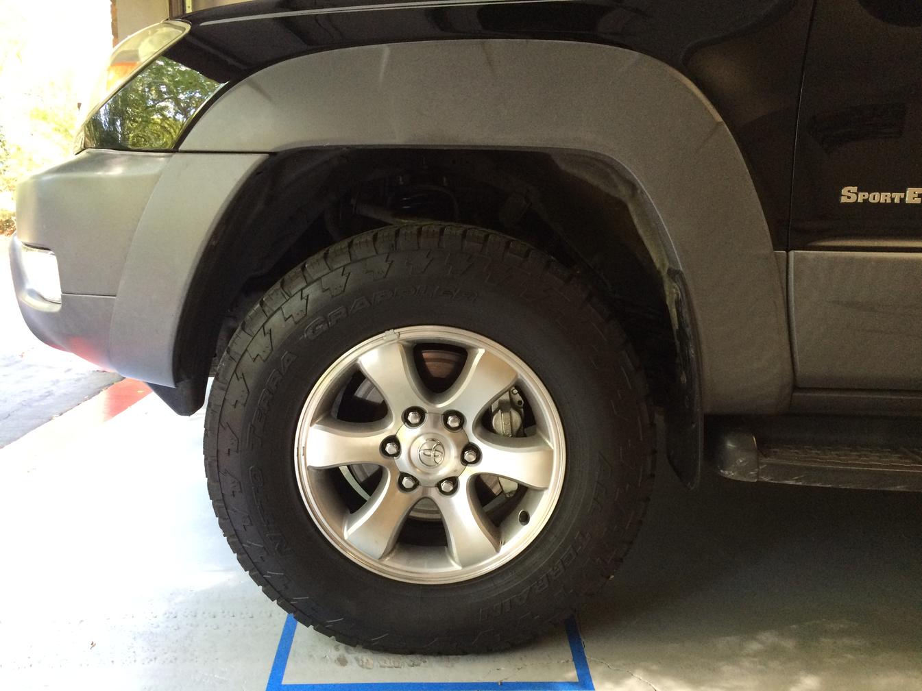

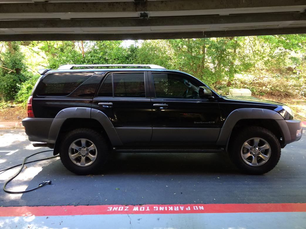

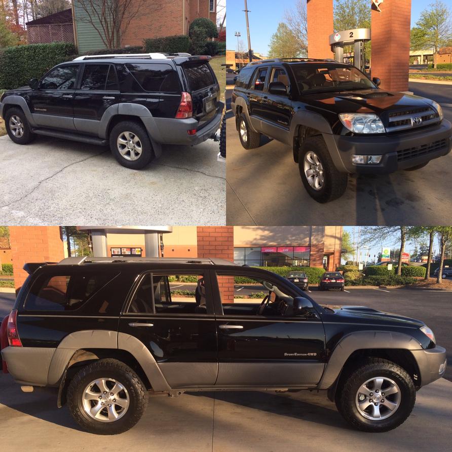

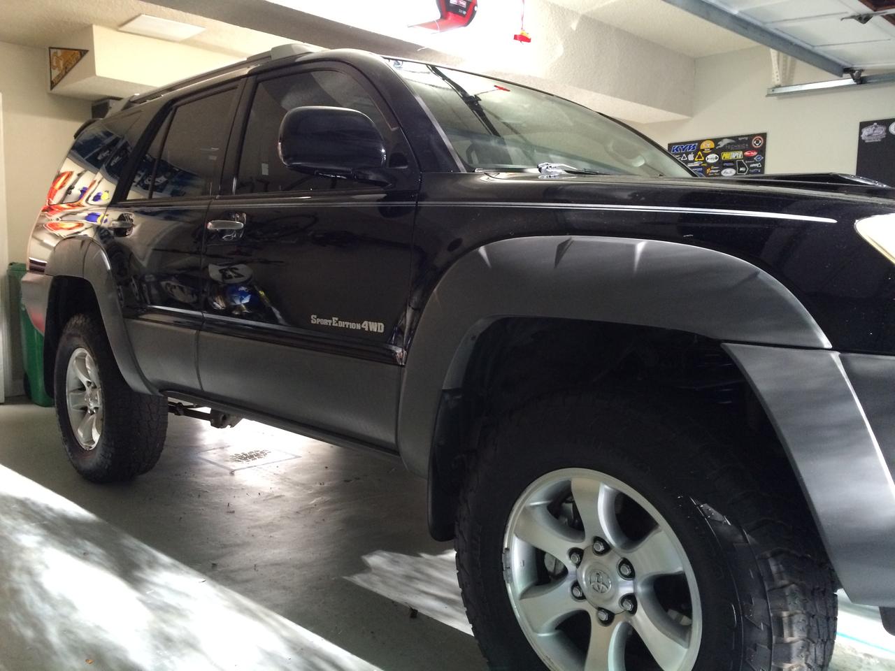

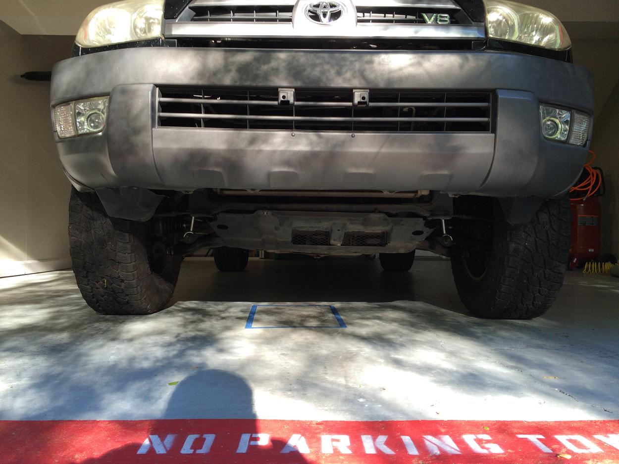

New suspension on (replacing XREAS) and looks & rides amazing! Brought the front end up substantially (Pic 1 before, Pic 2 after). This is the way Jenny should have come from the factory and technically, I think this matches the stock ground clearance measurements on the TRD Pro 4Runners. Highly recommend!

first off , great job on the suspension work.
now zip tie the x rears lines out the way, and also readjust the headlights height, it should be lowered.
also you might want to consider adding airbags, since it looks like you load the back down with the extra weight.
Thanks man and actually did both! Yeah the Bilsteins ride super smooth, especially under extra weight. Airbags sounds sweet but expensive, would be curious to see what adding something like that would cost...
its only 100 bucks i think.
i got the firestone brand from sdtrucksprings.com
uses a compression type install, the airlift brand uses clamps. both brands carry lifetime warranty i think. also i like the firestone install, just have a clean straight cut on hose and insert in fitting, then a small pull to make sure its in place.

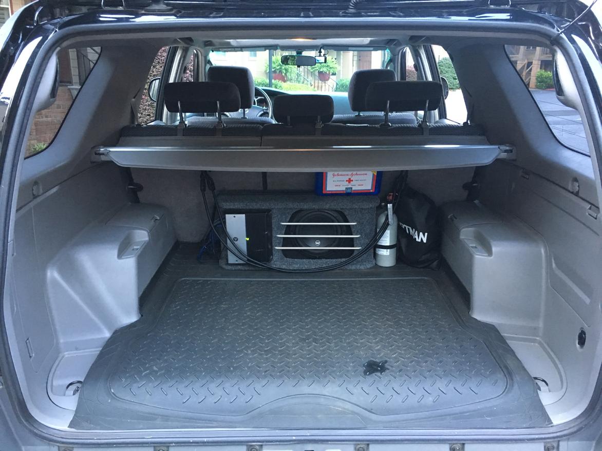

Added my 8" JL sub and amp + a universal, cut to fit rubber trunk mat + some essential safety/recovery gear (First Aid kit, Cartman Jumper cables, tow strap (stowed) and fire extinguisher with industrial velcro on the mount).

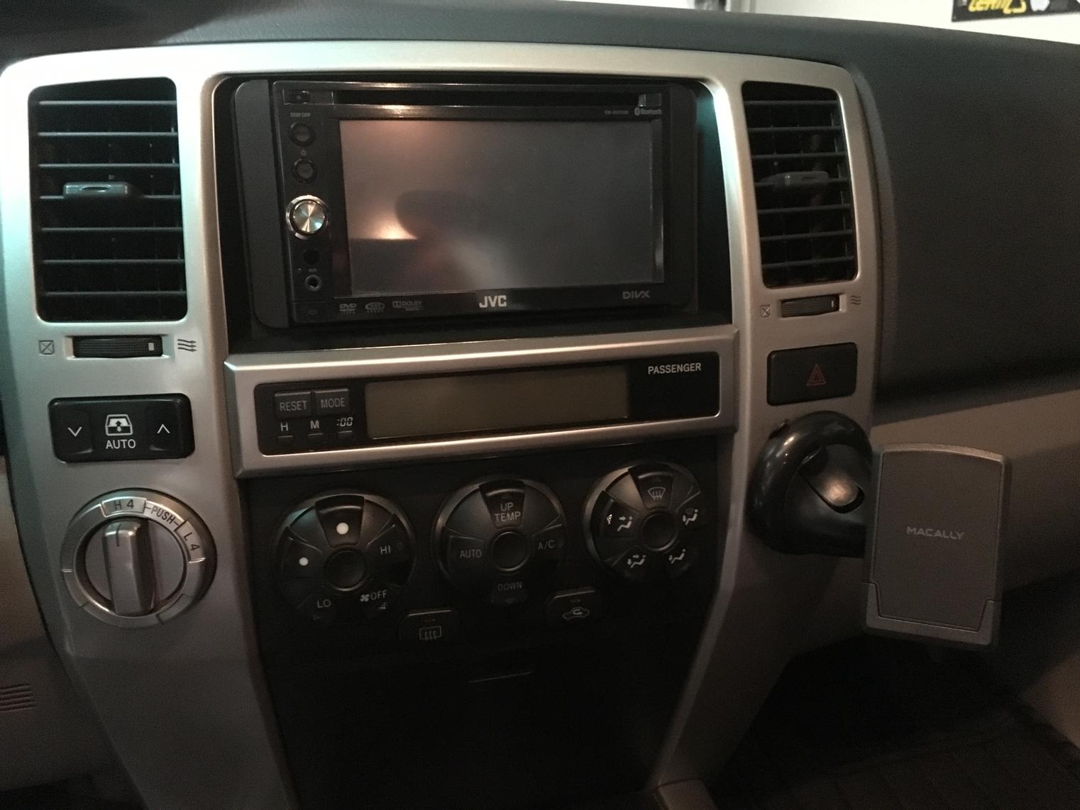

Other interior mods include a JVC DVD Bluetooth Headunit with an aftermarket back-up cam. Sounds great with the stock speakers and JL Sub.

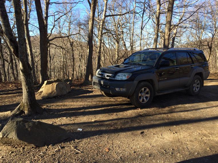

Took Jenny out to the mountains for some testing - she rides amazing and flexes well!
