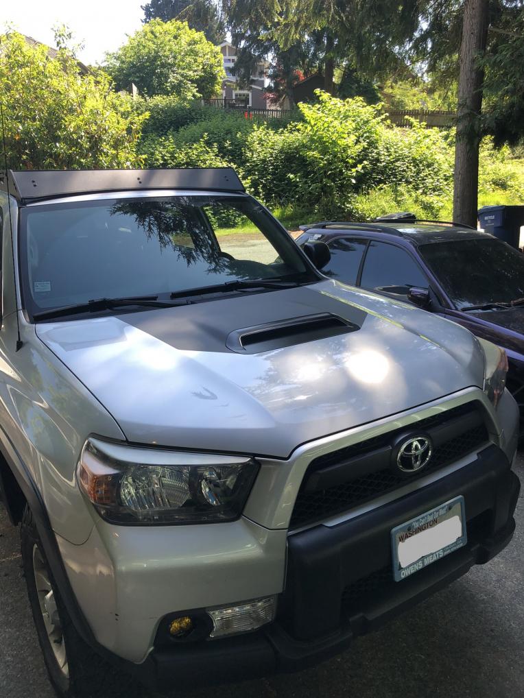

Toyota offers the black (painted) TRD scoop insert that fits perfectly. I picked up the entire kit (76181-35080-KIT) for about $107 and installed it on my 2013 TE. Fit like a glove.
