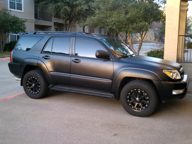

P.S. here's a pic of what im shooting for but this 4th gen is painted not wrapped.

There is a 4th Gen that was wrapped Matte silver for a short period of time, the wrap didn't hold up as well the owner had hoped so he removed it shortly after it was applied.
Was it shortly? As far as that thread goes (May - Oct 2011) he still had it / liked it.
EDIT: Looks like he pulled it Sept 2012... but then again, this is what the truck looked like before the wrap:
DSC09482.jpg~original
I have to imagine a wrap would be good for 90% of the guys out there. I don't think paint, wrap or even bedliner could stand up to that. :)
