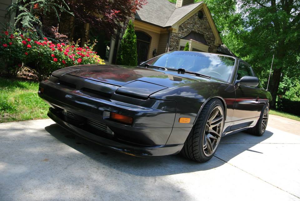

Nah sorry guys the guy I was going to get the wrap with decided not to. Also I sold the truck in march and have been building this.
Sorry you sold the runner but......that's my favorite sports car! What year? Miles? you gotta build thread somewhere? details!
its an 89 body has 230,000 the SR has 100,000. Literally 5min ago i made a build thread and I'm waiting for it to be approved then ill post it.

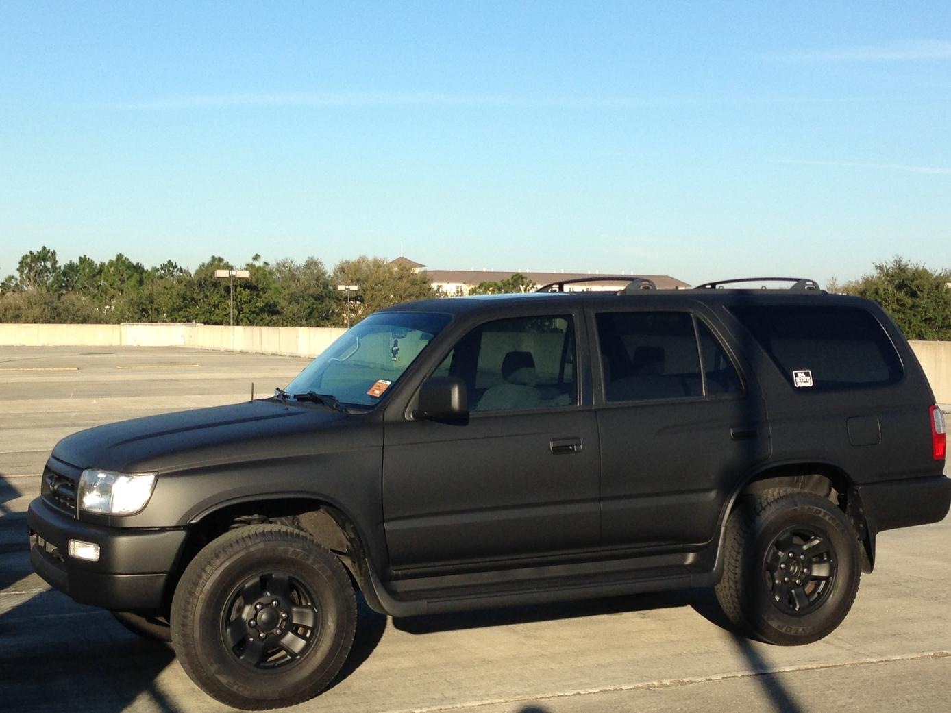

I had seriously considered wrapping my 4runner, but I realized that I enjoy painting much more than wallpapering, which is essentially the DIY application difference between vinyl wrapping and plastidipping. I plastidipped this myself on my own in the garage and enjoyed it, whereas I'm sure I would have lost my mind trying to wrap the 4runner.
