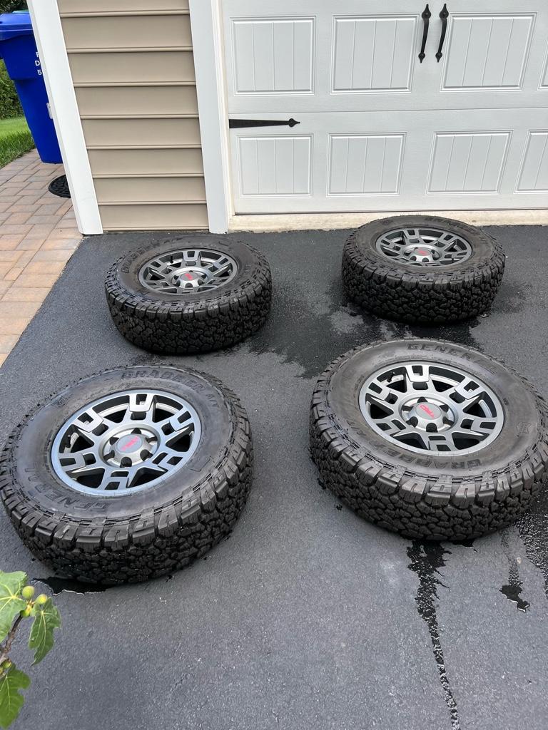

Just picked up a set of the matte gray TRD wheels (the ones with the red TRD logo) in excellent shape to be installed on my 2014.

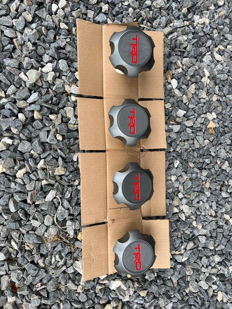

Can anyone tell me what models these were originally installed on, or if they were just dealer upgrades for any of the models? Also, has anyone identified a specific matching spray paint that is suitable for touching these up? Mostly the center caps which have some marks from an impact wrench.
I suppose I can ue my OEM TPMS from the SR5 wheels?
Also - I didn't realize these have LT load range C tires installed in the OEM size. Thought they were the P tires. General Grabber ATX, brand new. I reviewed the specs online, and there is about a 2 lb difference in weight between the LT and P tires (46.9 vs. 44.4 lb). Interestingly, a slightly lower load rating on the LT tires too (2470 vs. 2679 lb). Was surprised about this. They are not nearly as heavy as the load range E version (53 lb). Will I be disappointed in these tires for standard on-road use and some light off-road occasionally?

I upgraded to those exact rims, love them but the red TRD center caps do fade so I may need to buy new center caps too.
Noticed that! Ceramic coat has brought back a little color, but I was thinking of looking for a new decal inlay and then re-coating with a matte clear.

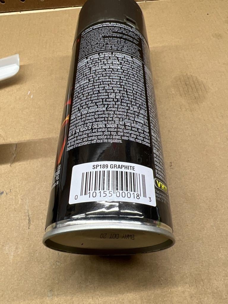

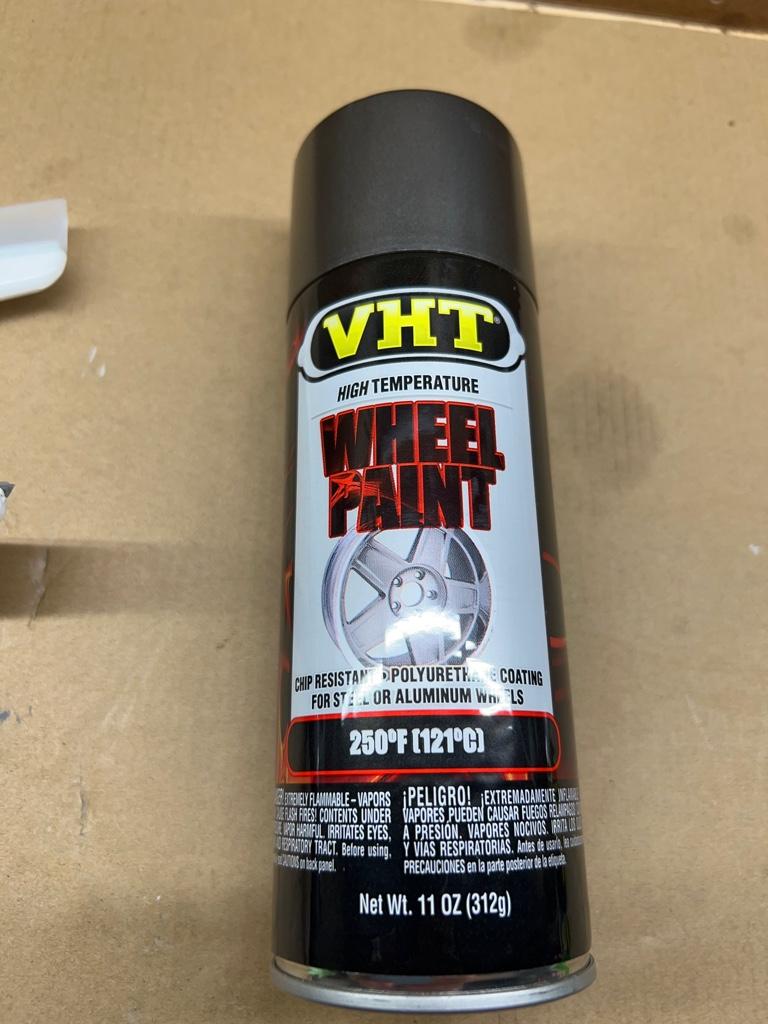

For those who may come across this thread looking for touch up information for the matte gray wheels, attached are the products I used with very good results on the center caps. Being matte, blending touch ups is fairly easy. I was able to sand and dust the impact gun contact areas on the caps with the graphite color, and a few coats of the matte clear really brought back the red in the TRD logo
