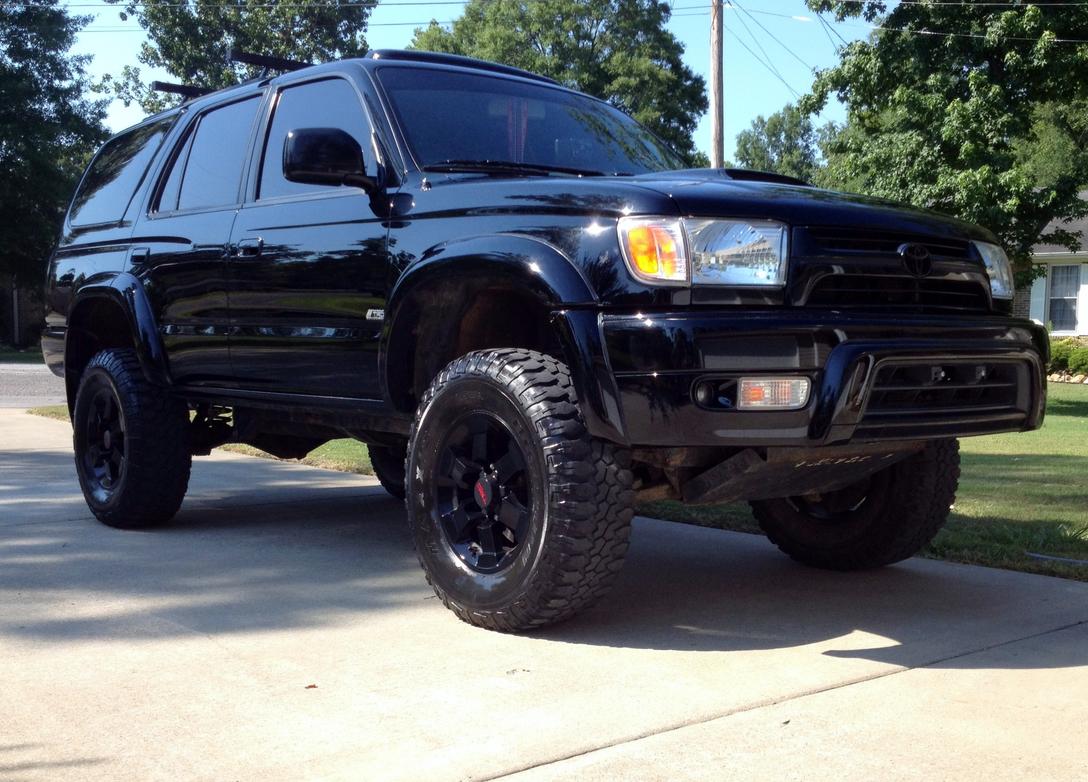

How she sits as of now...:reddance::frisky:

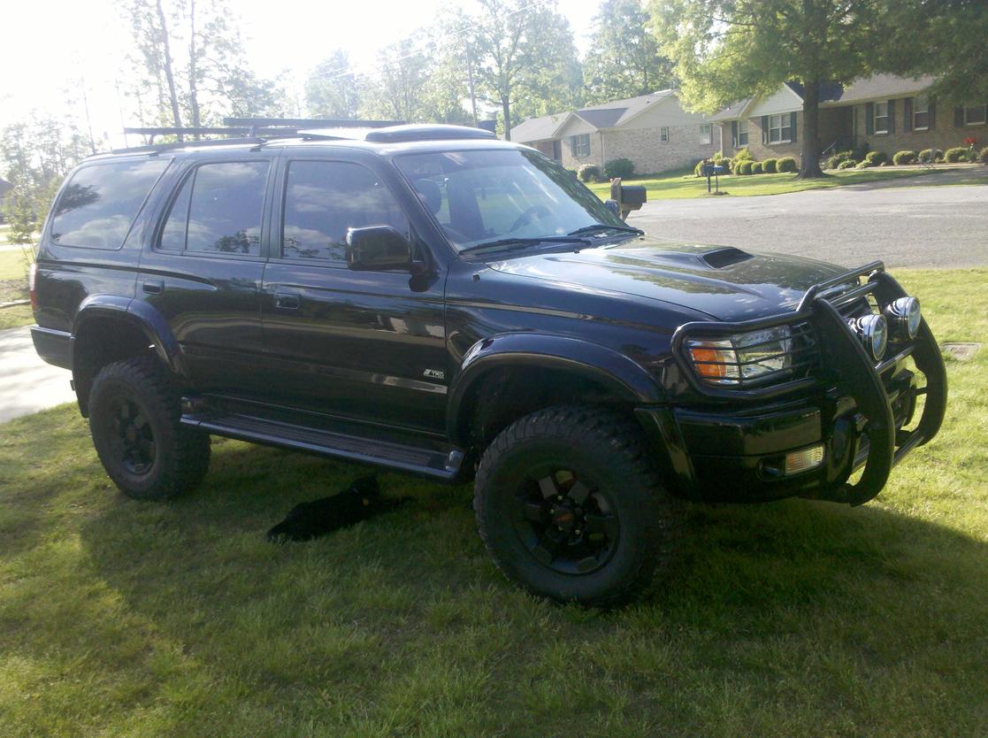

On To The Build:
Below is what I wanted at first, it ended up being crap, and I came across what is now my 4runner.

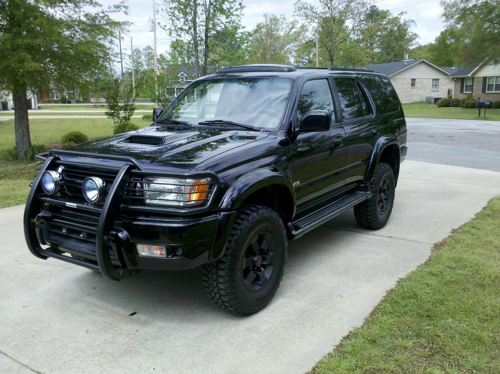

Here's the first picture I have of my rig.
Yes, it came with all this on, it was a great find and I remember telling my dad I would probably never want to do anything else too it (that was before I found this site...needless to say, my thoughts changed.) Being from Wisconsin, it has slight rust on the undercarriage, but nothing major.

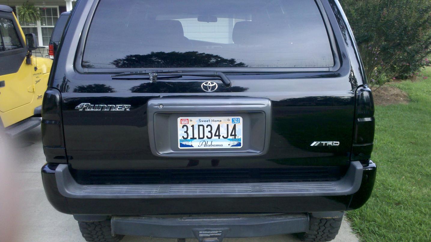

First thing I did was tint the windows to match the back. And then I removed the running boards.
Unfortunately, it didn't come with a spare tire. It looked as though someone had previously cut the spare tire holder. After searching around I came across a stock six-spoke wheel. Another buddy of mine had the exact size tire I had and even same tread pattern, Mudawg I believe. I purchased that from him and now had a full size spare.
I watched a friend of mine tint his Tahoe's tail lights black with Niteshade. I asked him if he cared if I did it to mine and he said no. So I went and purchased some sand paper and a can of Niteshade. I removed the tail lights and lightly sanded them. Then did about 3 coats of Niteshade. The number of coats you use determines how dark they get. Finished product...I thought they turned out great. I had a bunch of friends ask me if I bought covers.

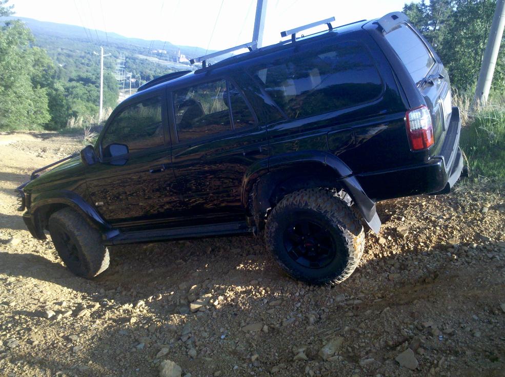

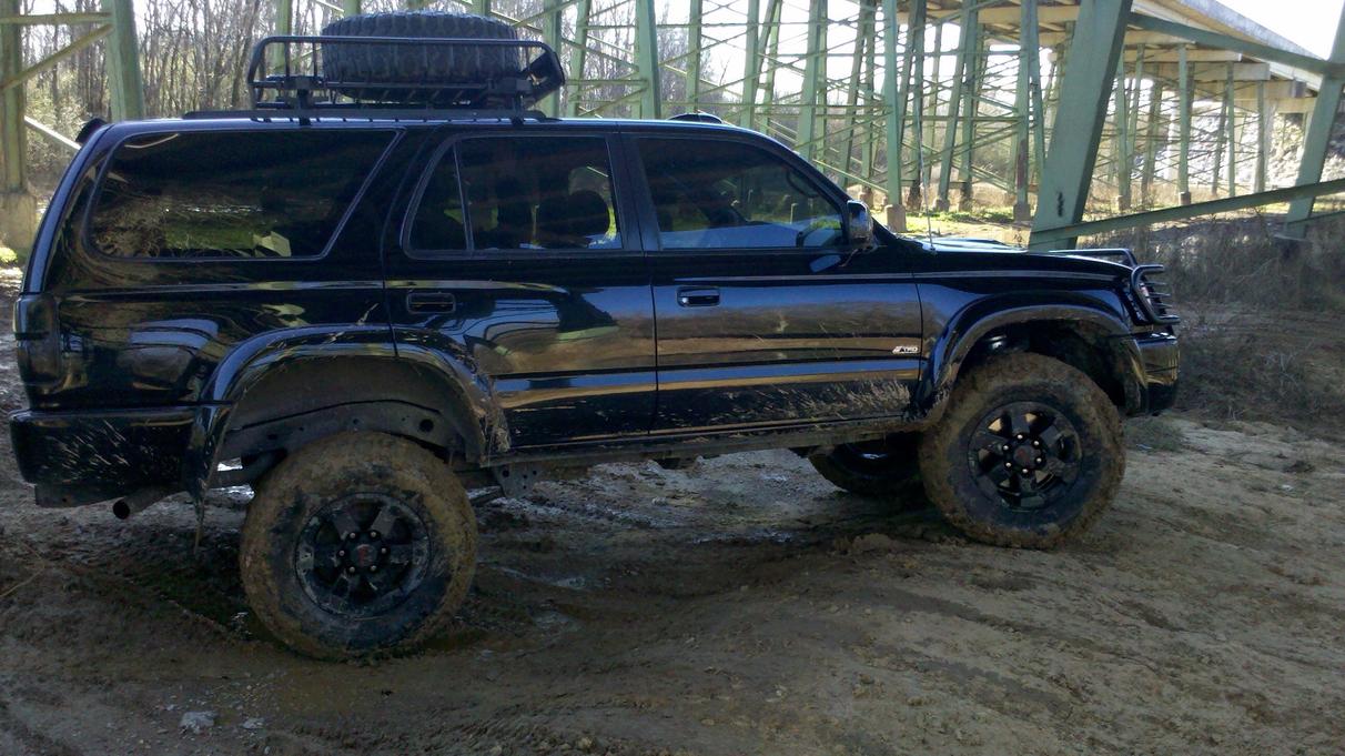

Here are some early pictures of me offroading it.

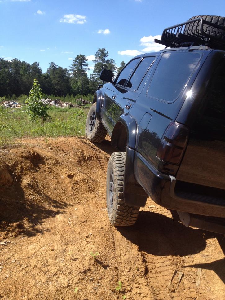

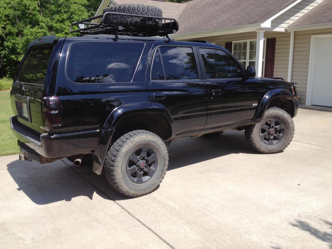

And here's a more recent offroad picture.

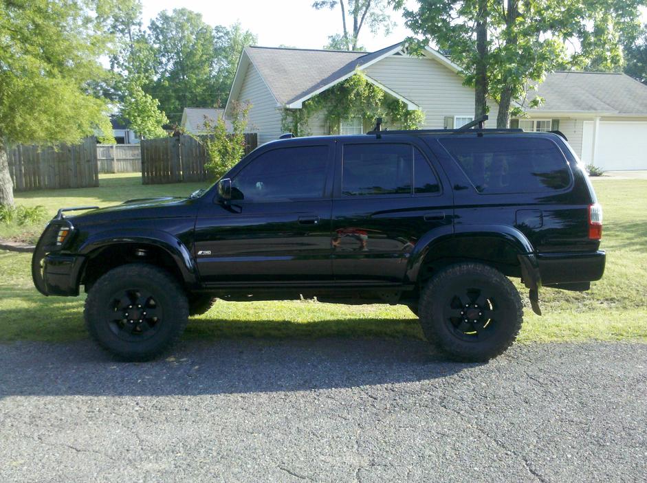

Here she is all cleaned up. The rack is off because we are leaving for Chicago tonight...family trip and she won't fit in the garage with the rack on :thumb3:

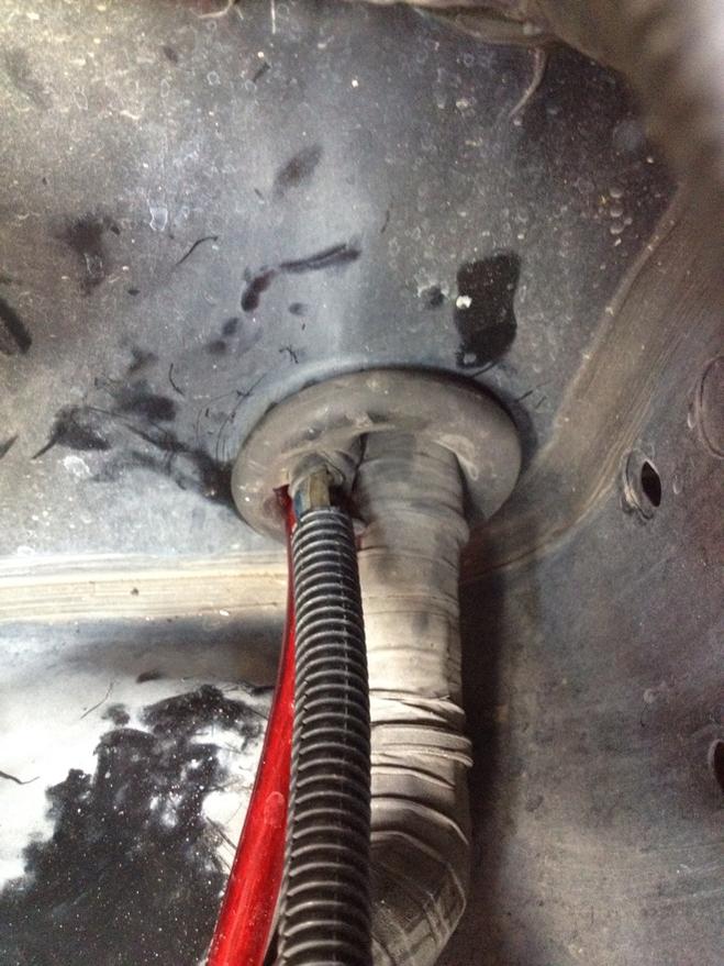

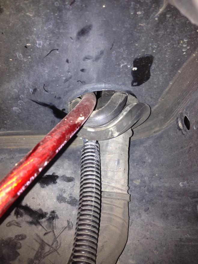

So I was reading on the forums I saw that thread about the drivers side floor mat being wet. It was caused do to the wire going around the grommet instead of through the grommet. My buddy and I had installed my wiring for my amp and everything and sure enough we had gone around the grommet, I also checked my floor mats and they were slightly damp. So that was my project for today. It seems quite simple, but my amp being all the way behind the rear seats meant I had to take up all the paneling and what not which is no fun. All I did was slightly cut a hole in the grommet and then slid the wire through. I still have to seal it, but that's no biggie.

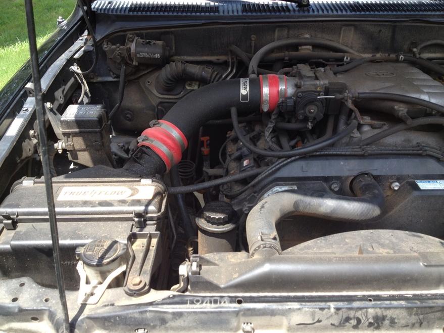

And while I had the hood up, I decided to snap a picture of my True Flow Air Intake.
