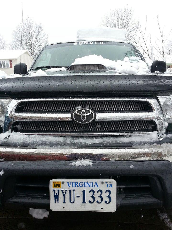

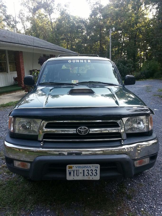

I know this is a old thread, but instead of making a new thread about something thats already been talked about in here im gonna bump this thread lol. Plus I got the idea from [MENTION=23997]toytech76[/MENTION]. I pretty much did everything you did Toytech except I didnt use construction adhesive. I tried using the adhesive but it was just too messy and it wouldnt stick. I got some metal strings idk what you call it in english to be honest, but its flexible metal like strings. I tied the mesh to the back of the grill and tightened with some pliers and VOILA!
