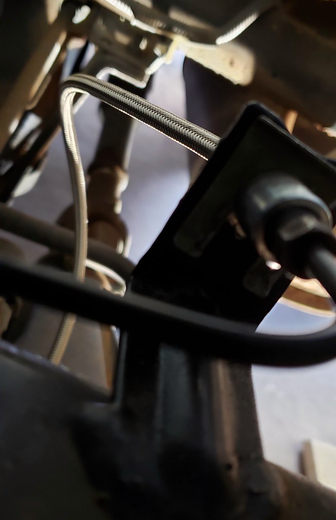

got the sonoran steel extended rear brake line in this weekend:
the install was quick but actually kind of a pain in the ass as the fitting on the line that connects to the lower fitting sitting atop the rear axle doesnt rotate freely like i thought it did. which means you need to straighten the line and thread in a somewhat tight area (the fact that the line is extended doest help at this step). i got it done in about an hour, but i didnt jack up my rig; we just put it on some home made ramps my buddy made to get me some extra room. it was a combo of sitting on my knees and ass. not comfy for an hour, but it still a somewhat easy job just in a confined space. this line is very high quality, but the fact that the bottom fitting doesn't swivel kind of sucks. im hoping the other options have this swivel.
snap on/blue point makes a tool that clamps the flared portion of the line so you dont constantly loose fluid during the install, but i forgot to keep pestering my dad about it so i just wedged a long funnel between my rear axle and panhard bar to direct the leaking fluid to a catch pan. here is a picture of it:
part number is SLS516SO. i also found this pretty cool method which involves grinding down a golf tee and pushing it in the brake line flair:

I just use a vacuum cap for brake lines while swapping them, etc. No need for a fancy tool.
-Charlie
i can get snap on stuff basically at cost. i think the MSRP on that tool is like 18 bucks, so even cheaper for me. the vaccumm caps are a good idea though, although im assuming most dont have these on hand. although you wouldnt have golf tees on hand either unless you lived with someone who golfed.
