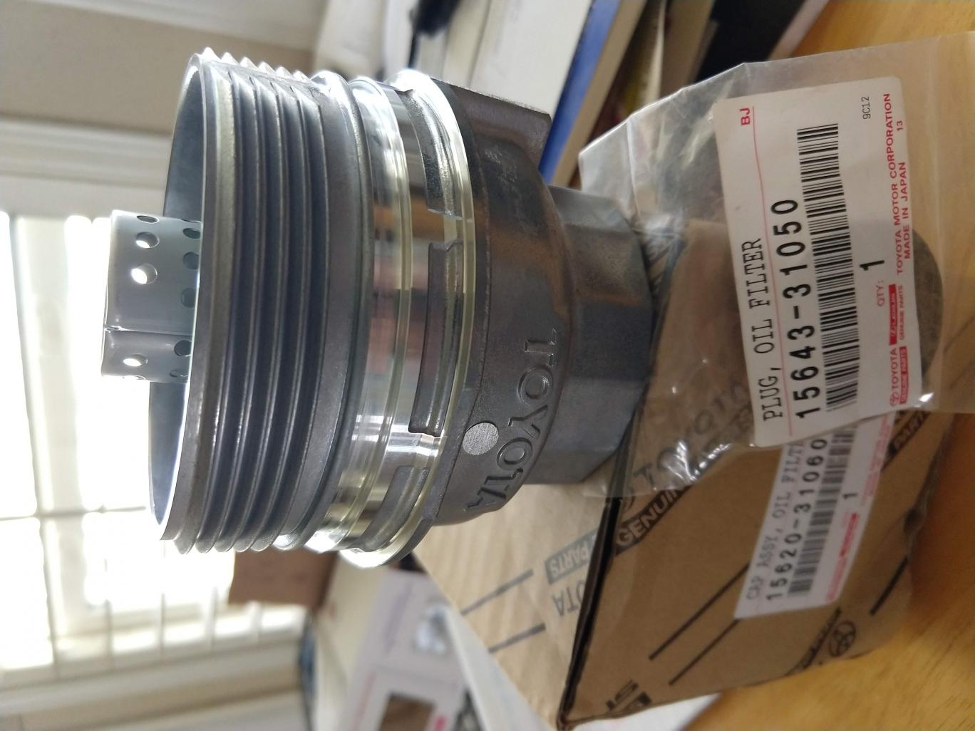

The aluminum oil filter housing that fits the 4Runner is the one for the Camry, and you need to swap the inner tube.
Part number: 15620-31060 (OEM Toyota Camry). The bottom cap part number is 15643-31050.

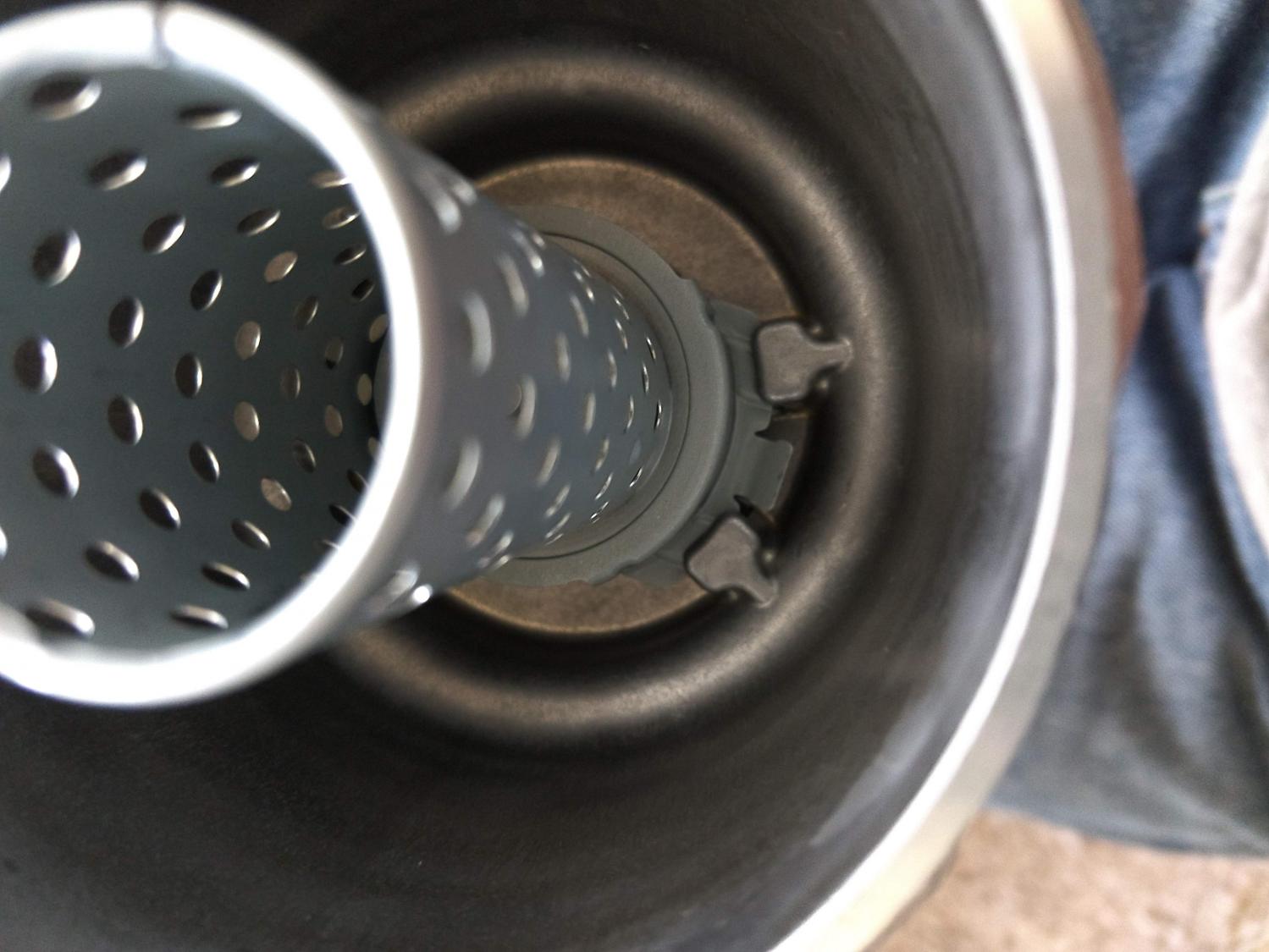

These are the parts for a metal filter housing. I got a second one from a dealer that sent me two when I only ordered one. I'll put it on my new 2021 if I need to in the future. All you have to do is replace the tube with the one off your old filter. Just press on the down on the tabs between the holders on the inside of the filter and you can twist the tube off.

Yes it is. You push down the tabs then push the whole tube down and twist it off. Replace the tube with the stock tube and put the tabs back to their original position then just push it down and twist it into place.
Don’t forget to bend the tabs back up so the tube stays in place!
The Toyota brand metal filter housing is in and no leaks. If it wasn’t so difficult to figure out how to post pictures on here I could show y’all the huge difference in casting and finishing quality. Didn’t get any calipers out but it comparing the Toyota to the Doorman unit, it seems like the recess for the o-ring was too deep on the doorman and doesn’t allow the o-ring to protrude far enough.
