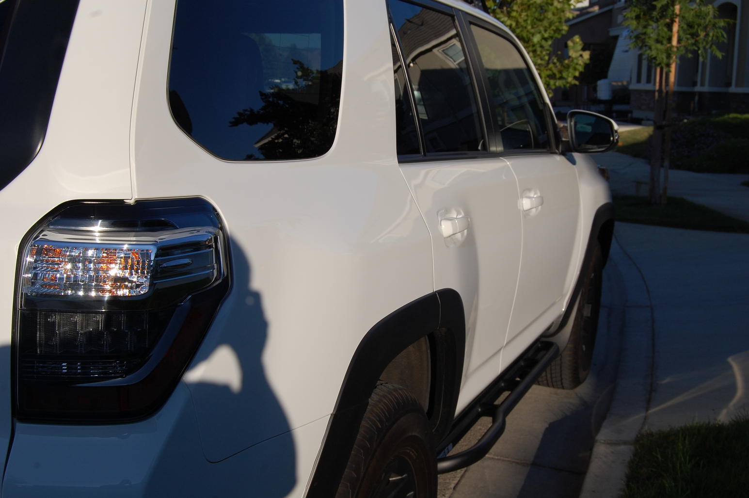

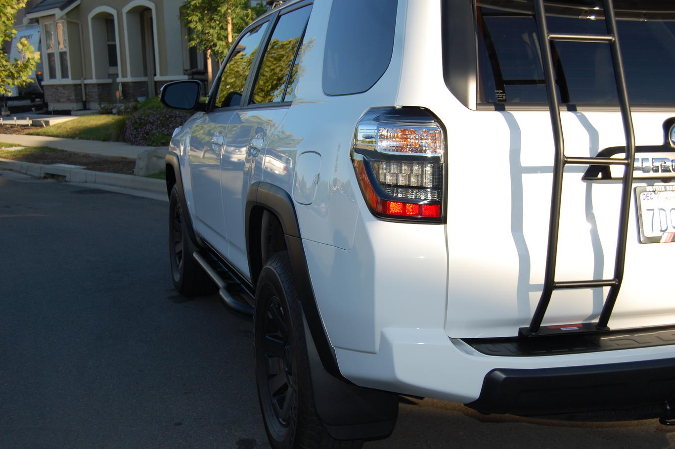

Heres pics of the White Knuckle Sliders on my rig

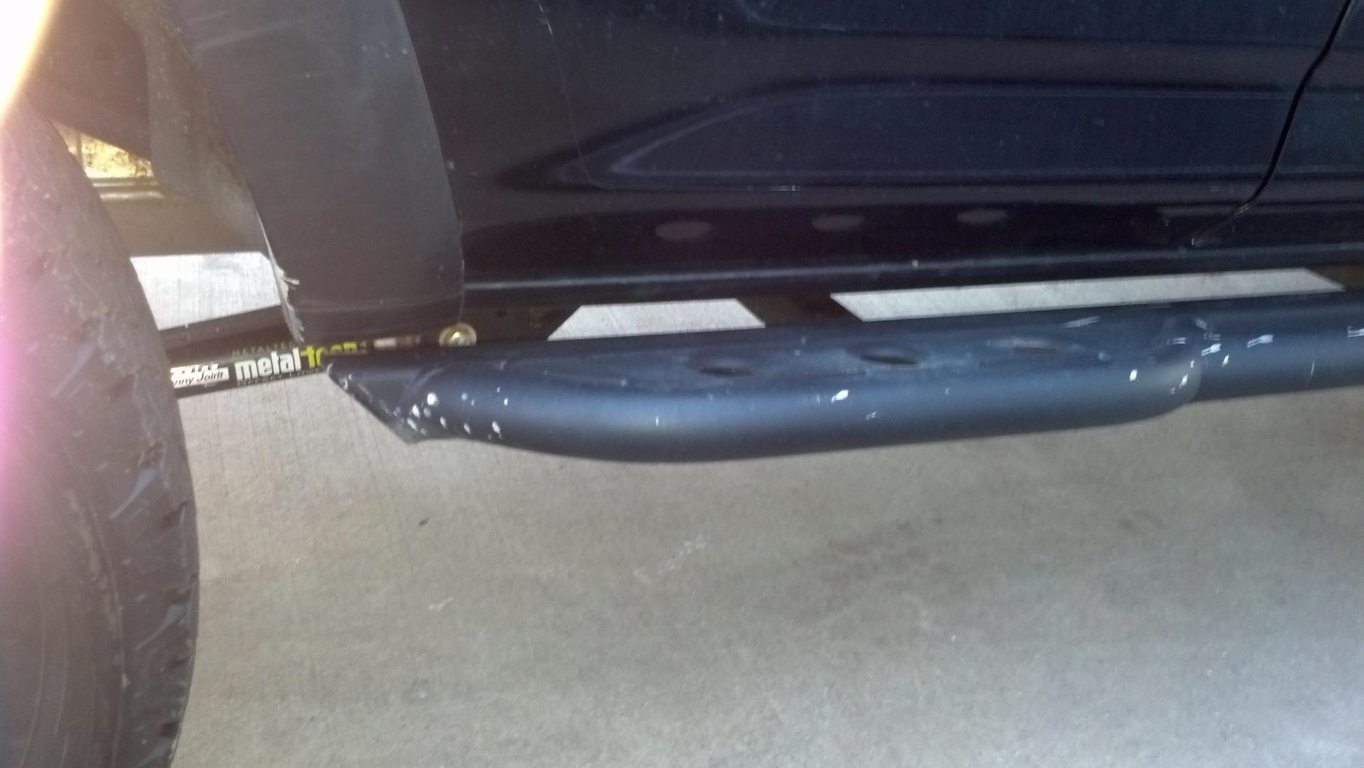

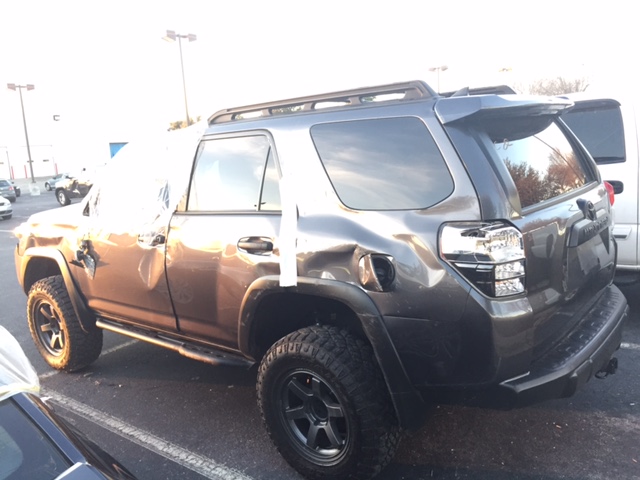

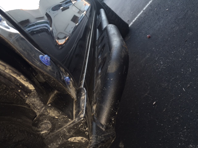

+1 for OPORs (S/E primed and rattle canned with rustoleum bed liner. )
Spared me a bit more impact,on the passenger but may have also enabled the roll...either way, the rigidity is proven and I'll be reordering for my 15.

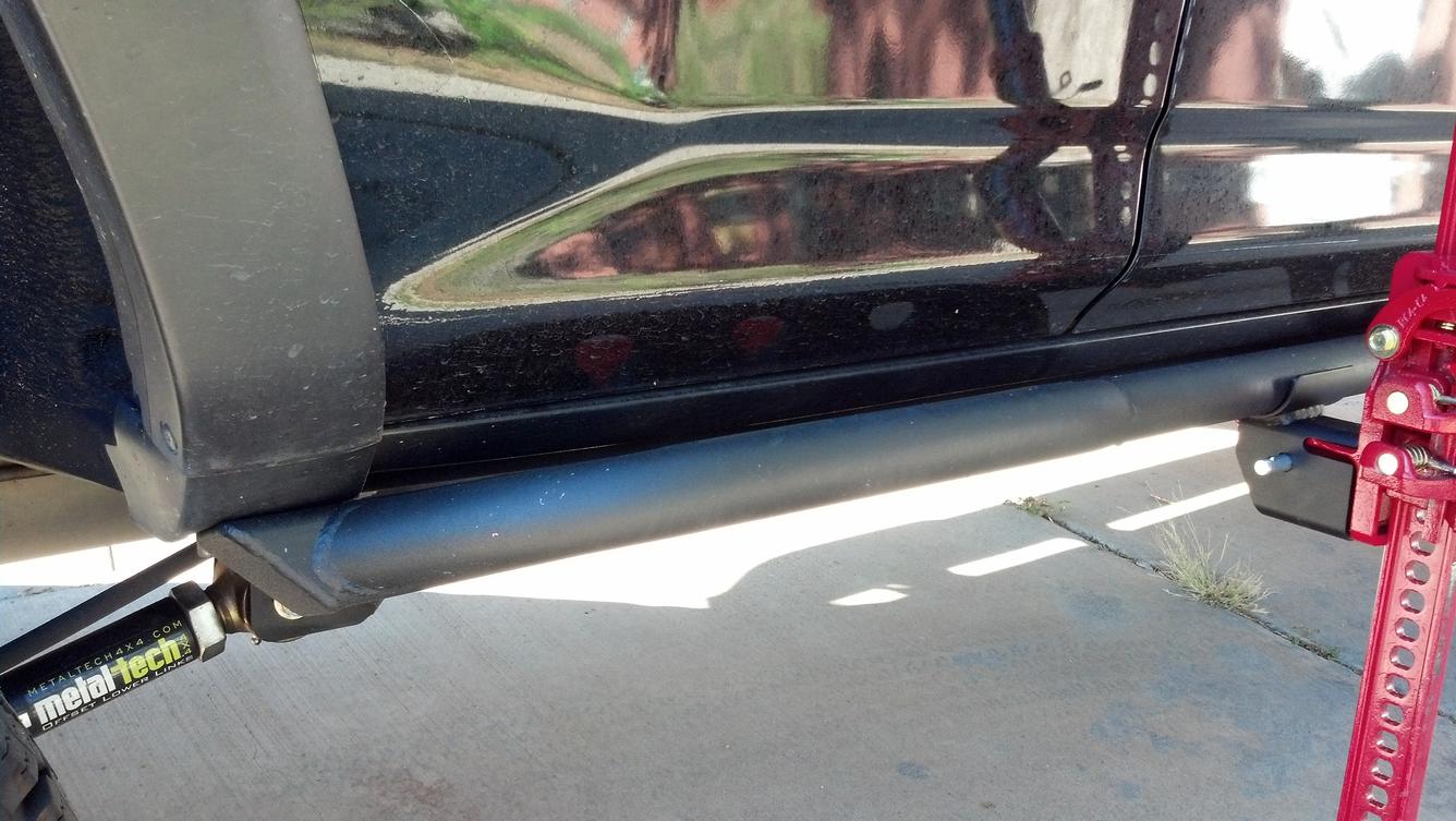

This is a photo of the slider bar contacting the door frame when trying to use the slider as a jack point.

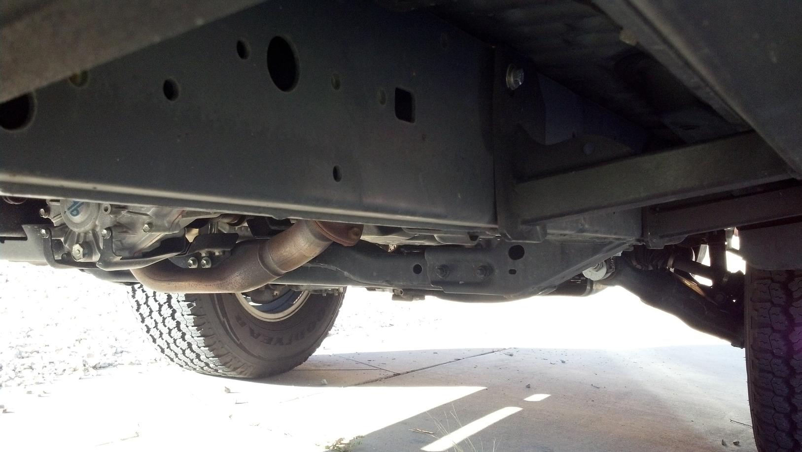

This is the mounting plate bending when trying to use the slider as a jack point.
This is the clearance now that I had some steel tabs and self tapping bolts attached to the mounting plate to help prevent it from bending. I don't have any pictures of the clearance I had before trying to use the sliders as a jack point.

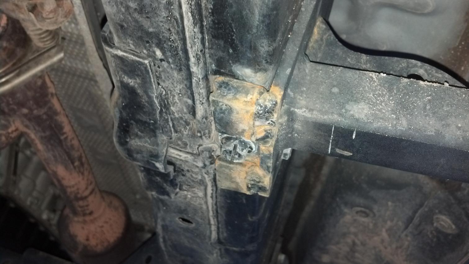

This is the tab and the self tapping bolt I had welded on 4 of the 6 mounting plates.

I'm having a difficult time believing your sliders only had a single bolt at the top, is it just the angle of that photo?
If you look at mine there's bolts, top to bottom on each bracket:
