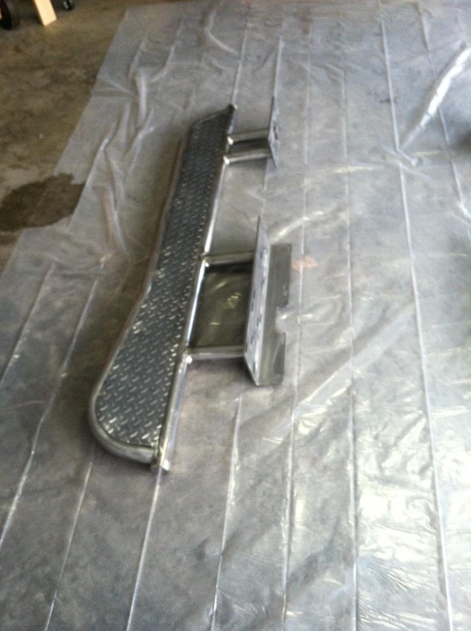

Each of my mounting plates came with a bolt on the top and bottom. The bottom bolt is just not visible in that picture.
I am not sure how to tag people in posts but I talked about this issue with Jono.ful, and he said he uses the sliders as a jacking point all the time...He just learned to deal with the bending.
Thanks for sharing.
I'm having a difficult time believing your sliders only had a single bolt at the top, is it just the angle of that photo?
If you look at mine there's bolts, top to bottom on each bracket:
~original[/IMG][/QUOTE]
Wow so if you use the OPOR sliders are jacking point. And they bend. Wouldnt that mean they'll bend when your on top of a rock and being supported by the slider.
Wow, this is insane! I have never seen any sliders bend that much while on a high lift jack. I can see in the photo that you show the tabs that have been welded on with the self tapping screws going into the bottom of the frame, that you do have the lower slider frame mount bolts installed. From the photo that you took showing the frame mounts bent away from the frame, it looks like the mounts bent away from these bolts in the opposite direction, which makes sense to me if the mounting plates were not strong enough to take the stress.
This is shocking... I think I am back to considering White Knuckle sliders or the long ass wait for the Shrockworks.
I expected that the mounting plates had L shape and get bolted to the vertical(side) and horizontal (bottom) section of the frame. Unless I am missing something in the photos, those sliders only have a single. At least thats how my BudBuilts are on the rear mounts

I really the like the fitment of the OPOR sliders. If they only need a tab to be welded on. Maybe I can ask my buddy to modify these and welds some tabs on there. He should be able to do these quickly. He does build roll cages for race cars.
Yea I agree, that would definitely fix the issue that cmitch is experiencing. To me it says a lot that MT recommended the same fix. That is, the lower tabs below the frame rail and the self tapping screws.
There are lots of slider designs out there and most work well. Sounds like these need a little help. This frustrates me as I am looking for sliders that tuck nicely up to the rocker panels and do not stick out too far from the body of the 4Runner. These looked to meet my requirements. However, they must be able to easily hold up when raising the vehicle with a high lift. One of the most basic tests of a slider in my opinion.

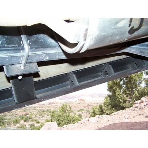

I've seen the Metal Tech inner powder coat touted here and on their website. I suspect that they make a great product but this seems like a marketing gimmick. Does any one know exactly what is meant with powder coating the inside? Does that mean full 100% coverage of every nook and cranny, or a little bit of the inside gets coated. :)
I dont know for sure. But have seen there products and they are 1st class quality. Like otheres they are a small shop so if you need immediate responses an te suc look elsewhere. Takes them usualy to the end of the day to respond or the next day, but O guess that is theprice to pay be becoming popular as what happened with everyone mentiond here includong Demello.
The main rails on their sliders are not box or round tube like most others. They are actually a flat sheet of steel bent into a C-channel and internally braced. The back side is not closed in, so they are completely powder coated. This photo is of their 80 series Land Cruiser model but it's the same concept. I had the 80 series ones and they were solid. I was also worried about rust inside the slider but the powder coating held up really well to winter sand and salt.
