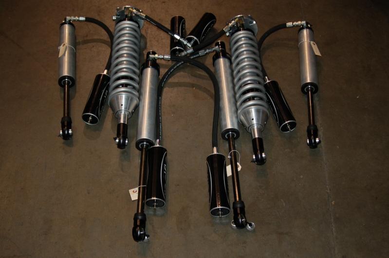

Dual shocks of course! The dual mount kit from TC is already on the truck. The custom built and valved Radflos are on deck as well. Remote res. front coil over and remote res. secondary for the front. The rear is matched to our rear long travel kit and also remote res.
As for final numbers off the front.... we have to finish the build. We do have to be careful at first not chopping away too much (so tempting to just go flying in there with the plasma cutter) . We do have to finish the front bumpers we have planned first. We may have to just limit the travel for a bit why we knock out the bumpers so they fit non-plasma cut Gen 5's. :wow: The production bumpers made to fit everyone's truck have to come first. Then we can work ours over a bit for what ever is the best thing needed for travel numbers. (always sacrificial sheet metal for travel if we can)

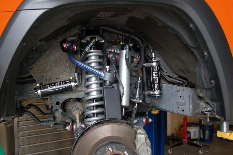

Just got in our Radflo suspension and picked up the third member yesterday. Now it's crunch time to get everything installed.
I'm sold. Sign me up for a pair of the Metal-Tech sliders. I like they way those look. Time for me to buy some new stuff for my 4Runner I'm not going to use.
The suspension is now complete on our 4Runner. A lot of work involved getting the secondary shock hoops to work but I managed to get everything to fit without cutting any sheet metal. Will be taking the 4Runner off the lift today and start test driving the new suspension.
