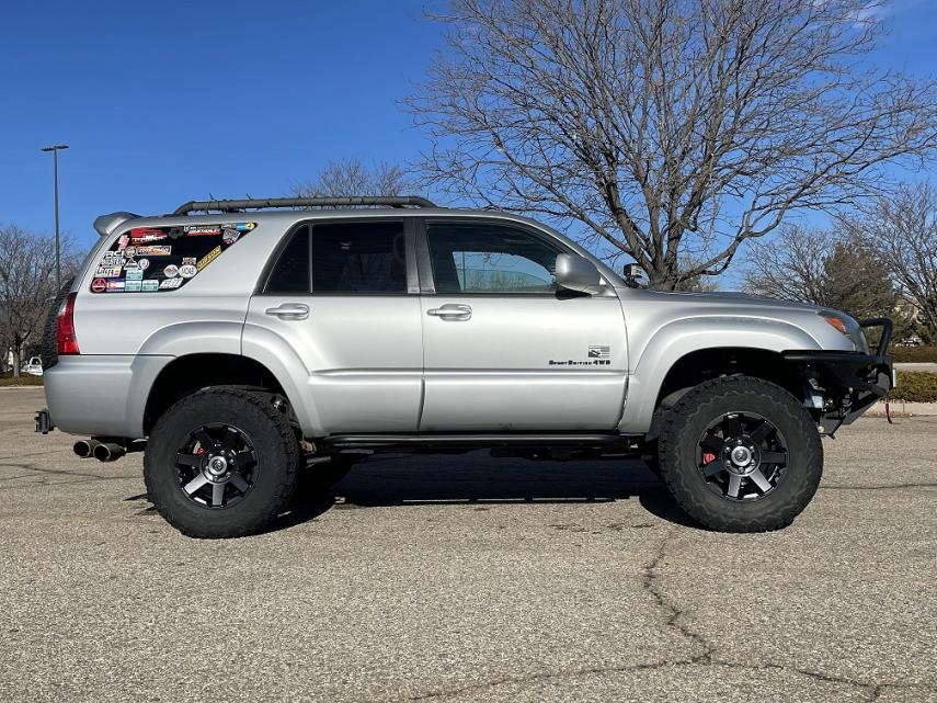

i installed my MT heavy springs not too long ago. here is a pic unloaded, i would say the the heavy spring are definitely over 3inch unloaded. I have a measurement of 26inches from center hub to fender line. front coils were at a modest 3 inch setting, so the heavy springs def gave it more stink bug stance. tires in pic are some worn 295/70/17's. hope this helps those out on the fence. i'm actually swapping to MT mediums now because i don't run enough weight at this time, but will save the heavies for later. its not the ride that bothers me unweighted, its the rake that bothers me. Too much rear lift, and like Inv4drZm stated earlier, you have to jack the front coils up to the point of almost no droop to even get it close to reasonable (unweighted that is).
Thanks, Chankeye. That does look like more than 3”! How much weight does it take for the rear to settle down a little?
Your 4runner is looking good. It’ll be interesting to see how much lift you get with the medium springs.

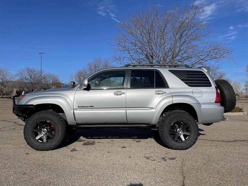

I'm about 25" both sides. It's hard to get super accurate because my sidewalls bulge out so far.
This is mostly unloaded, just the bumper weight.

That looks perfect. 25” is what I’m looking for. How much does your bumper with swingout weigh? 250-300ish?

i've only had about 300 lbs in it and the back dropped less than .5 inches. i can see having full skids, steel bumpers, and being loaded with gear dropping it significantly, to the point of being perfect (to me). that's why i'm going to hang on to the heavy springs and run the mediums for now. thanks for the compliment though, i'll be installing the mediums today so i can get back later with a pic of what those look like.
which is exactly the height i want.

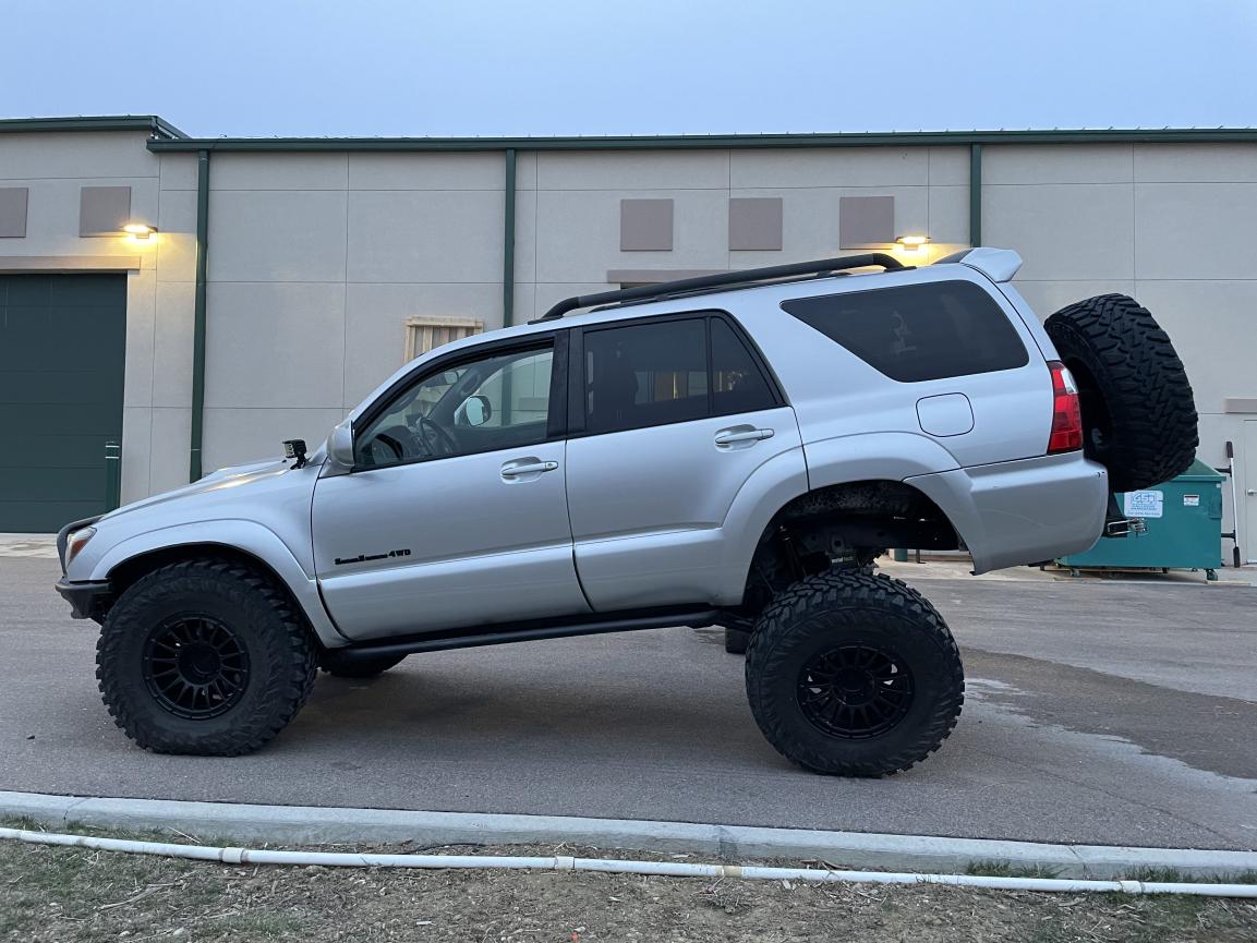

Probably not the exact answer you are looking for, but here is my setup. I have 6112s up front w/ 700lb springs, on the 5th clip with a quarter inch toytec spacer on the tophat.
I had toytec superflex 2.0 springs that I swapped out a month ago for the Metal Tech Heavy long travel springs. I also have drawers that are probably about 80 pounds, along with my tire carrier setup which is probably another 100 pounds total. I have enjoyed having the extra strength in the rear for what I do and what I have back there. I haven't tested the MT springs out in Moab or any trails in Colorado yet since it is winter, but the ride has been good. I imagine with some or no weight in the rear the mediums will be perfect for you.
Something to note is that to get the true benefit of LT springs, extended shocks and bumpstops are needed, and to prevent rubbing when flexing, aftermarket LCAs and UCAs for the rear axle. I'm currently running Icon 2.0 shocks, which limits my travel, so I only have the springs right now. Saving up for the rest of the package. Feel free to ask me any questions and I'll try and get back to you.

I currently have the LT Metaltech springs and 5100's in the rear. I know that the springs are currently maxing out the shocks length. I can definately tell when going over bumps as the shock returns to full extension I think I can hear the thud.

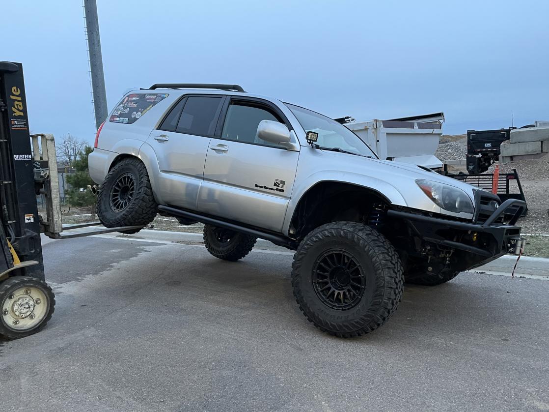

At the time, yes, I was maxing out the rear shocks still. I ended up having one blow and replaced them with LT basic Dobinsons shocks which have been doing great. From my understanding, yes, you will still max them out with the Icon springs, are they progressive rate?
The down travel of the shock will be the limiting factor depending on the spring. The "downside" to running a longer shock, is that you need to run bumpstop extensions as well. If you don't run extensions, the shock body will hit it's minimum length (maximum compression) before the bumpstop engages, resulting in a blown shock.
When I reached out to MT, the acknowledged that I was fine running LT springs with aftermarket shocks, but that I would only get the full potential out of the springs with LT shocks, which is why I picked some up when the Icon blew. I also picked up their 3" bump extension. I have been pretty pleased with the setup, and the guys at work have been impressed as well. The bumpstop extensions also save my fenders since I have gone to 35s.

First off... Epic Flex!
Second off... Are you running 35"s without a Body Lift?
Third off... the 3" icon lift springs I purchased are not progressive rate. But, now I'm having trouble finding them online. All I see are the 3" progressive rates.
I'm gonna call Icon and get their input on what to buy. Did you do the 3" brake line extensions too? Any change in the pan hard bar or lower control arms?
Also, are you still running the sway bar upfront?

Hey dude! Sorry, I'm not on here as often as I used to be. Thanks! I dig the amount of flex I have too haha.
I am running no body lift and 35s, you are correct. It works surprisingly well. I did grab the extended SS lines from metaltech when I went to taller coils. I also put on the EIMKeith PCK.
I had no front sway bar in these pictures, I've since also removed the rear.
