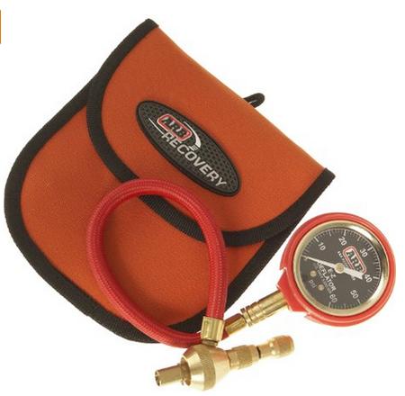

What do you do to air down your tires? Do you press the valve stem with your finger nail? Is there a tool specifically for releasing tire air pressure? Or unscrew the valve stem? I have a tool to remove the valve stem but I don't like that method too much. It's tough to stop at the perfect moment.

I've been using the ARB EZ deflator tool for about 3 yrs, it is slower, but by far the best.

While the ARB pressure gauge looks good, it still means going around and sitting at each tire for a few minutes.

The ARB EZ Deflator gets my vote too. It pulls the valve core but does it in a way that makes it essentially impossible to lose or damage. Yes, you still have to do each tire one at a time, but it makes quick work of deflating my 32s.
